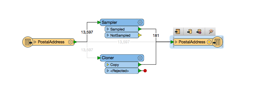

The workspace should look like this:
Ensure only the Sampler is enabled, and that you can see the Google Sheet whilst the workspace is running.
You should be able to see the Google Sheet as FME writes out cells. As the Google Sheets writer writes on a cell basis, rather than feature/row (like databases), the more attributes and features to write, the longer it will take.
If you disable the sampler and send features from the PostAddress Reader Feature Type directly, you should see that it takes a lot longer to write out. You will need to set the Worksheet Handling Option to ‘Truncate Existing’.

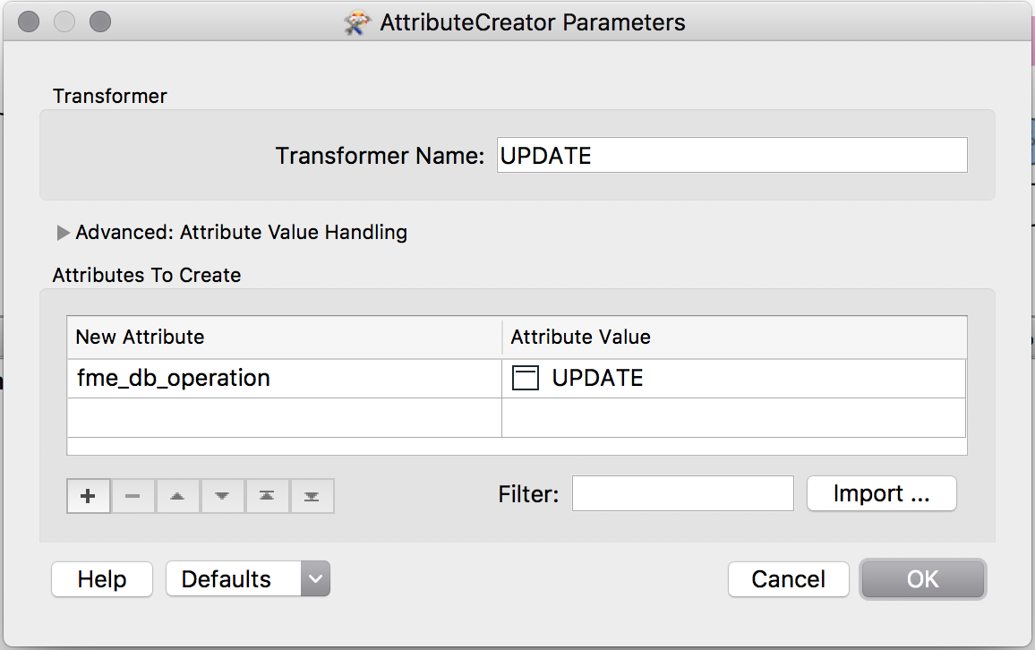

Enable the Sampler and turn on random sampling. Add a Counter before the Sampler. In the Google Sheets writer feature type, set the Feature Operation to ‘fme_db_operation’ and the Row Number Attribute to the ‘_count’ attribute. You should see that the Worksheet Handling option changes to ‘Use Existing’.
After the Sampler output Sampled port add an AttributeCreator and create the fme_db_operation attribute with a value of DELETE. For the NotSampled output port, add an AttributeCreate and create the fme_db_operation attribute with a value of UPDATE. Send the outputs of both AttributeCreators to the Google Sheets writer feature type.
If you watch the Google Sheet whilst FME runs, you should see some rows disappear, and some row values change as FME writes.
