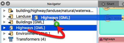

By default writers are executed in the order they appear in the Navigator window, so the original order is Landuse, Buildings, Highways, Environment. However, the order can be changed by dragging one writer above another in the Navigator window:

Check how many feature types exist for each group of data. Reorder the writers so that the group with the most feature types is the first writer, followed by the remaining writers in order.

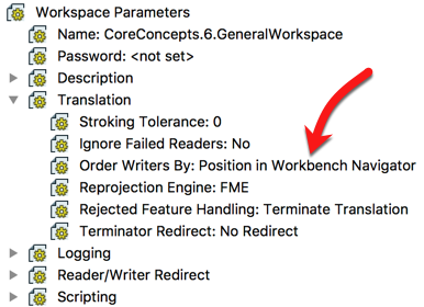

In the Navigator window, locate a workspace setting called Order Writers:
Notice how you can change this parameter to allow writer order to be set by the order in which features arrive (i.e. in the airport analogy, the first passenger to arrive determines which flight is boarded first).
How might you control the order of features in a workspace? Remember from what we have learned that blocking transformers could affect the order of data and so the order of writing.
Why might you use this method?
