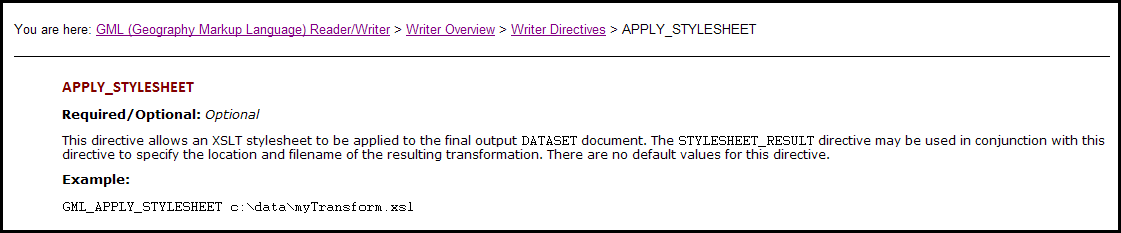

  • The APPLY_STYLESHEET keyword
The APPLY_STYLESHEET keyword, as described in the help docs
