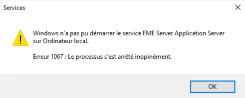

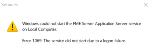

After installing FME Server 2022.0 on Windows Server in French System Locale, the FME Server services cannot be started. Looking at Windows Services, the four FME Server Services (FME Server Application Server, FME Server Core, FME Server Database, and FME Server Engines) are not running. If you try to start the services, an error 1067 or 1069 will appear.

In the C:\Program Files\FMEServer\Config\values.yml file, the system encoding for the system account (systemuser) “Système” causes issues with the installation.
