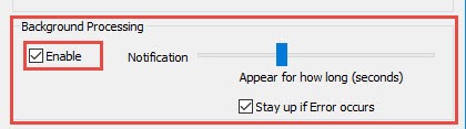

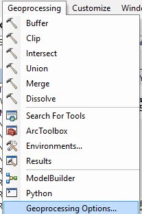

2. Ensure Background Geoprocessing is toggled on.
2reNSHwgLIPNvMaImA7nczsEZnRlfhsZliO38ERa3t0JoPjPxAWAOd1ckkti6MVLwJu4iyX0o6h_KW3HKX7Ayl285i_LFmx2k67wGCTeUZJNY5-dy4nPVsSbURr5pYJXNr_xsZ_2dNxq8gSuaMtKg8m7jDYJBVHiRLWROh1I1v4uImkxkssO8VUpuGHb43wjScJ9EQ318O4yZFuddkKGBrAnK4K7aUyeYNrDeQSV7G6ylhhXe-LniDvDE5OQPdjk-kmirHb_wXokH3JS
