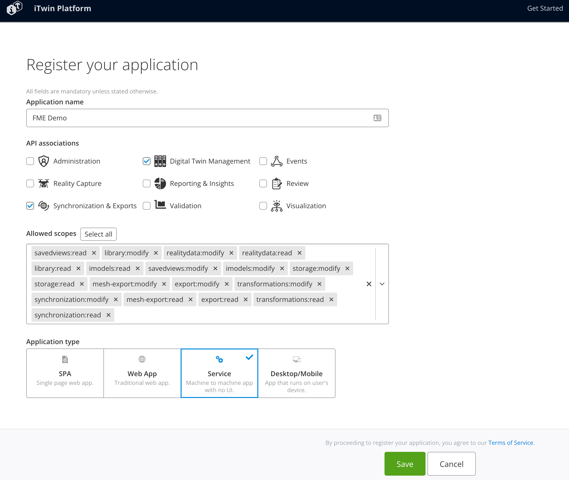

1. Register Your Application
Login or create an account if you haven’t already. Set the Application name. Choose “Synchronization & Exports” and “Digital Twin Management” under API Associations. Set Allowed Scopes to “Select All” if the tags are not automatically populated.
For Application Type, select “Service” and click Save.
Register your application

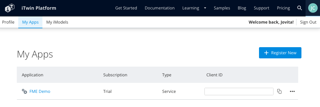

You will now see your registered app:
My Apps showing FME Demo and the Client ID
3. Copy the Client ID and Client Email from the App
Click on the new application to show its properties. Copy the Client ID and the Client email somewhere that you can refer to again.

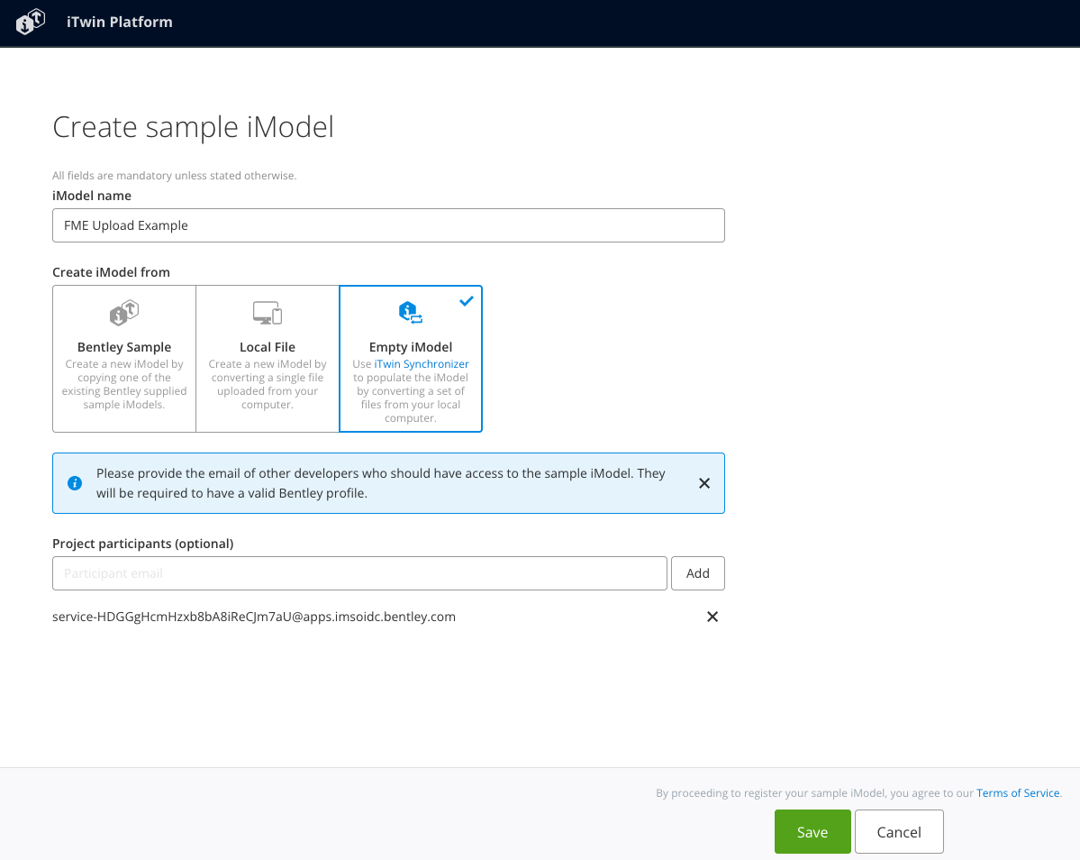

4. Create a new iModel
Go to the iTwin Models page and hit “Create” to make a new blank model. Set the iModel name, set Create Model from to “Empty Model”. Retrieve the copied Client Email and add it to the Project participants field and click Add and press Save.
Create sample iModel
5. Get the iTwin ID
Under IDs, select Show on the new iModel and save the iTwin ID and Model ID information to a safe place that you can retrieve the information again.
