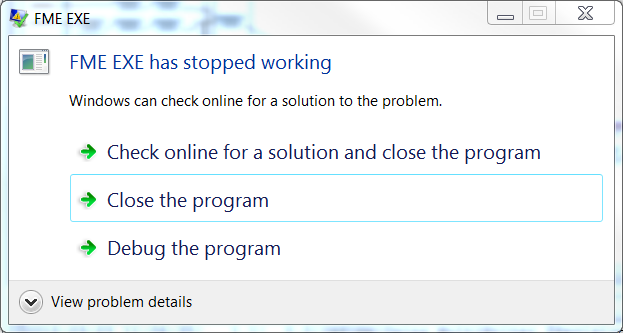

You may come across the following error when running your translation:
When this happens the log file may not necessarily indicate what the exact problem is. This is because FME processes feature by feature (unless there is a group-based transformer in the workspace), but the log reports transformer by transformer. A reader, writer, or transformer not handling a feature successfully is a likely cause of this error. To narrow down where in the workspace and what feature specifically is the cause of the error we recommend following these steps as a general rule-of-thumb to troubleshoot:
