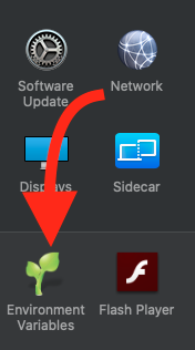

Once you have installed EnvPane, you'll see a new icon in your System Preferences (cmd+space then type 'pref' to locate System Preferences).
Double-clicking on this icon will open EnvPane.

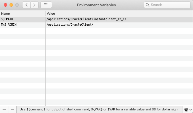

From here you can create the new environment variable called TNS_ADMIN and point it to the folder where you have saved your local tnsnames.ora file. Restarting FME Workbench, you should now be able to make use of the database alias in the Database Connection.
