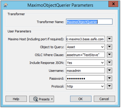

The MaximoObjectQuerier allows you to query Maximo for Assets, Service Requests, and Work Orders, using any of the object properties.
In this case, we are searching for the Asset using a simple WHERE clause that filters by the assetnum field. The transformer's output will be a single feature per record that matches the query. The features will have all Asset properties attached as attributes.

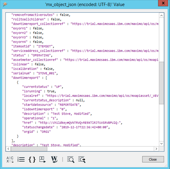

The transformer also has Include Response JSON set to Yes, which will create the attribute mx_object_json containing the raw JSON response from Maximo:
This is useful as a template for your own JSON when creating Maximo objects with the MaximoObjectCreator.

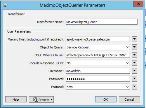

We can also query Service Records:

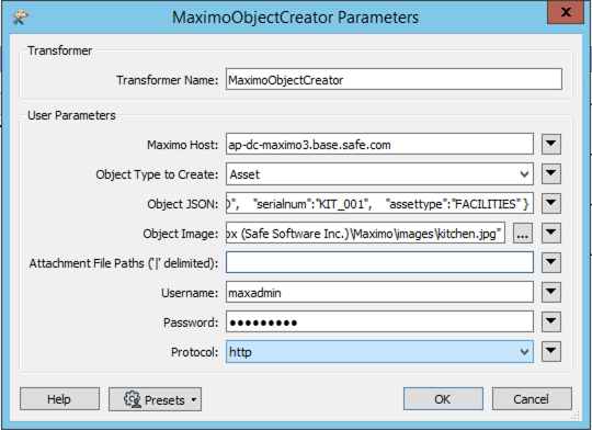

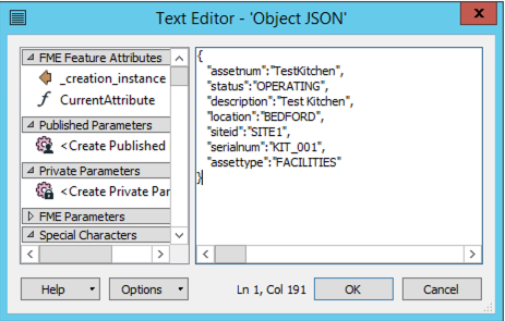

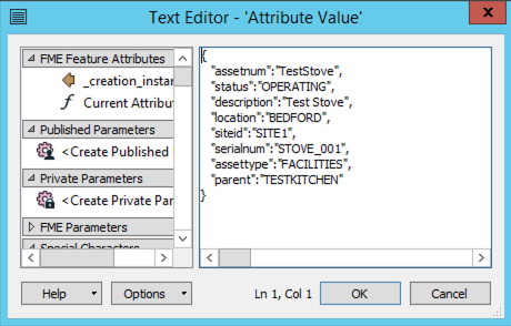

Here we are creating a new Kitchen, with an image to display in the Maximo interface. The JSON for this Asset is:
We will also create a stove and sink asset as children of the kitchen:

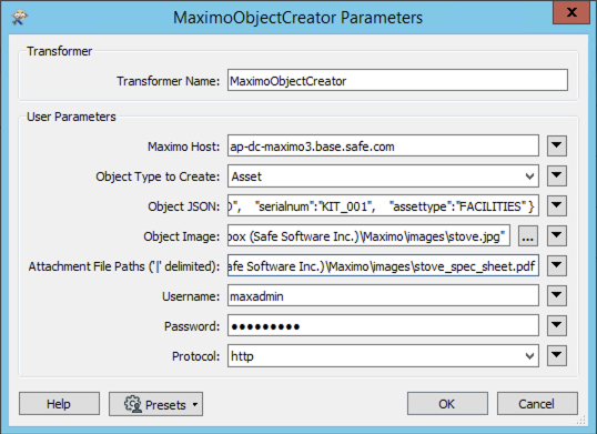

For the Stove, we will also upload the manual and spec sheet PDF files as attachments, and set its parent to be the previously created Kitchen asset:

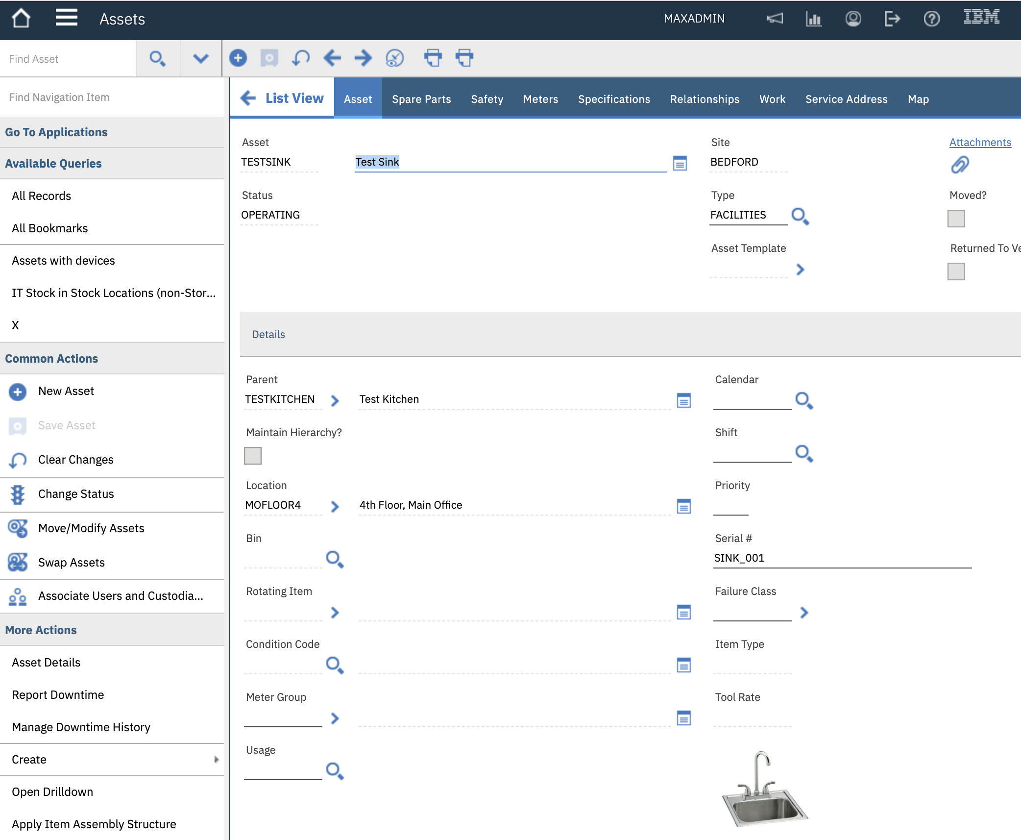

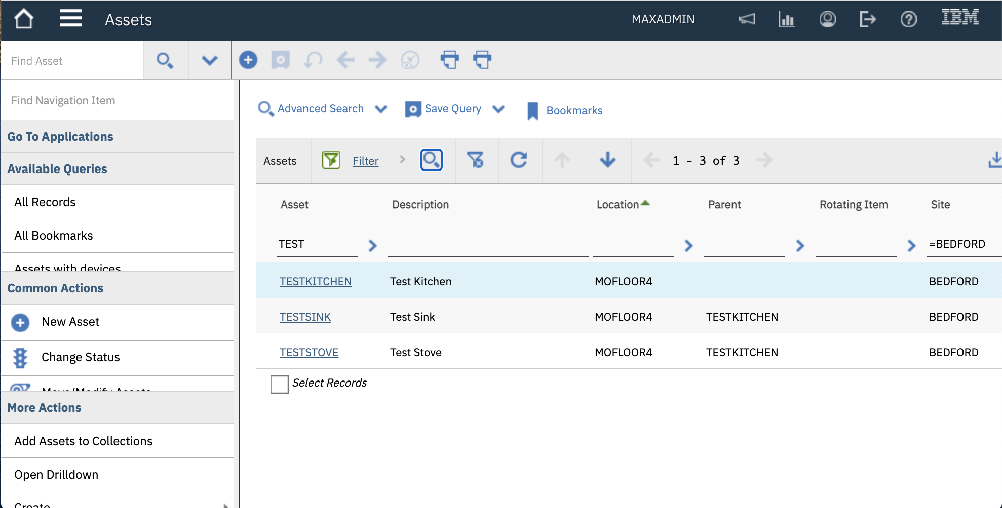

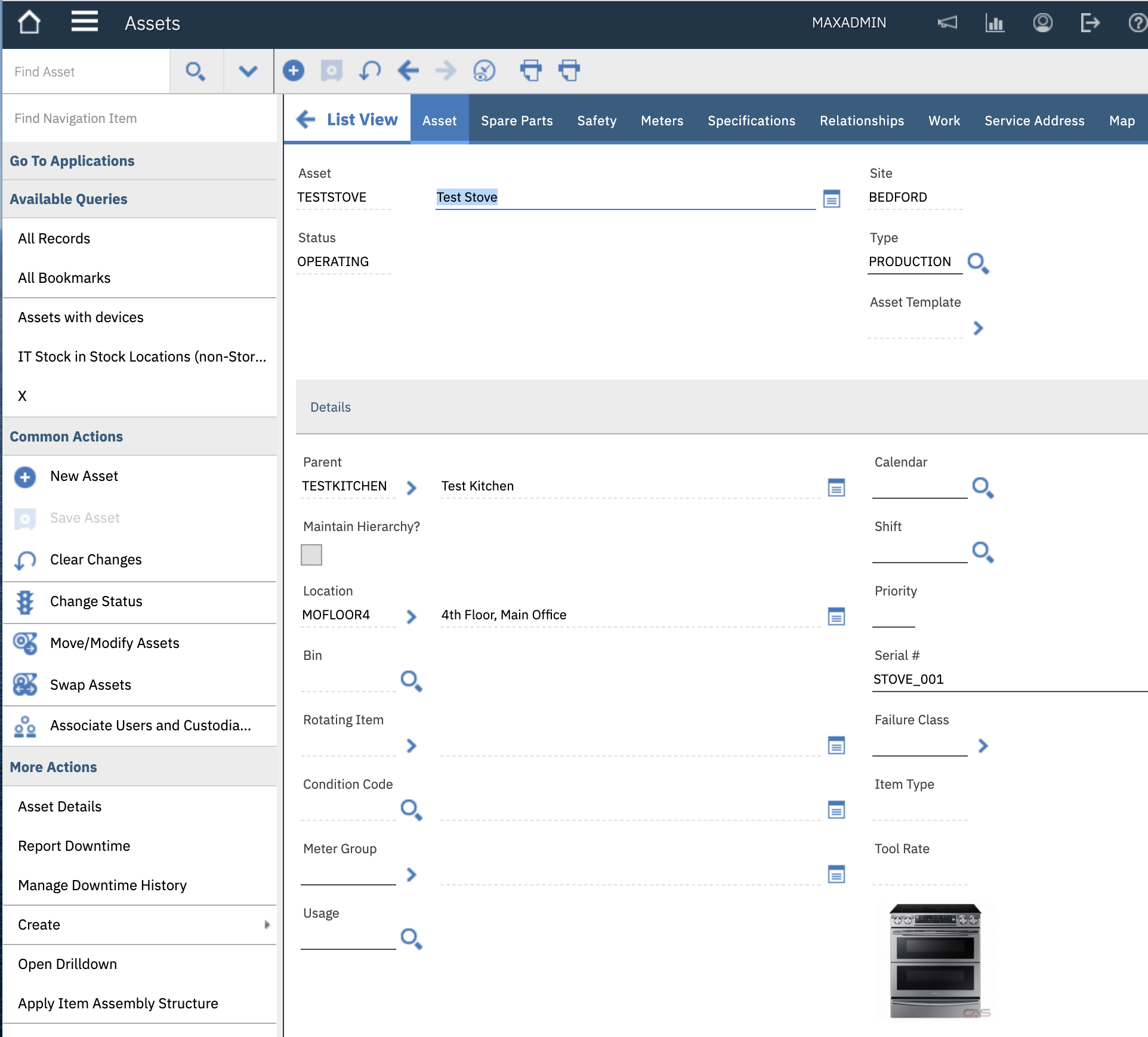

The result in Maximo is:
The details of the Sink show the uploaded image, and the Kitchen as a parent:

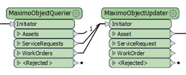

The first step is to add a MaximoObjectQuerier to get the url of the Test Stove

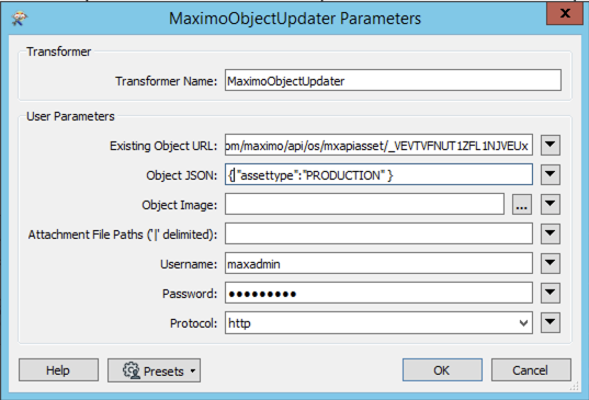

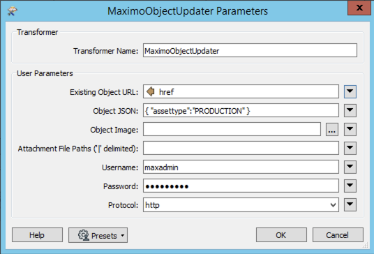

Next, we will add the MaximoObjectUpdater, with the Existing Object URL set to the href attribute of the input feature, and the Object JSON set to: {"assettype":"PRODUCTION"}
After we run the workspace and examine the Test Stove, we see that its asset type is now set to PRODUCTION

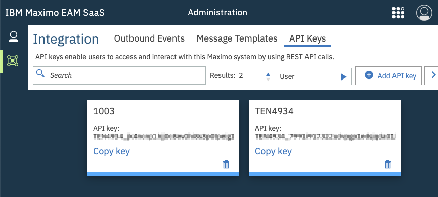

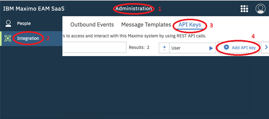

If you have Admin access to Maximo, you can generate an API key using the following steps:
1. Enter the Administration page
2. Choose Integration from the side menu
3. Pick API Keys from the top menu
4. Click on the Add API key button
5. In the dialog that pops up, click on the magnifying glass icon to bring up the user list, then choose the user you want to supply a key from the list.
6. A new API key will be displayed. Click on Copy key to copy to the clipboard.

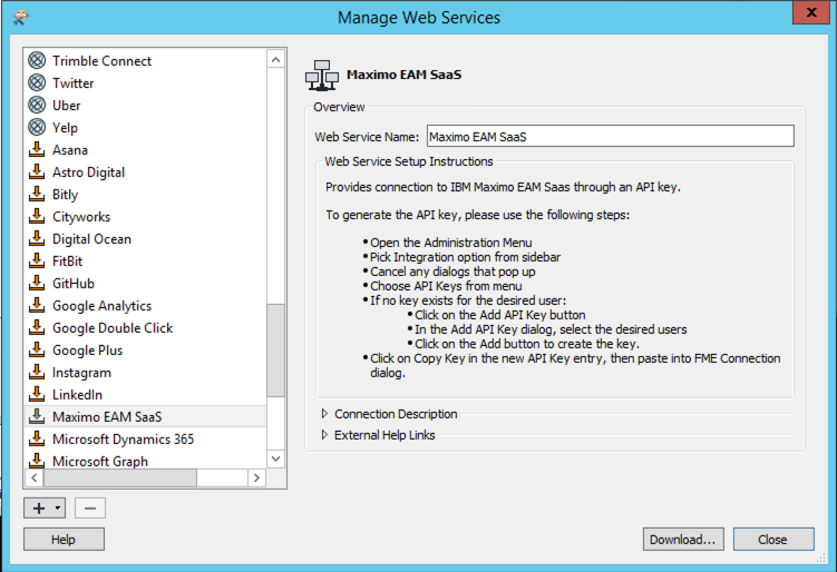

Adding Connection to FME

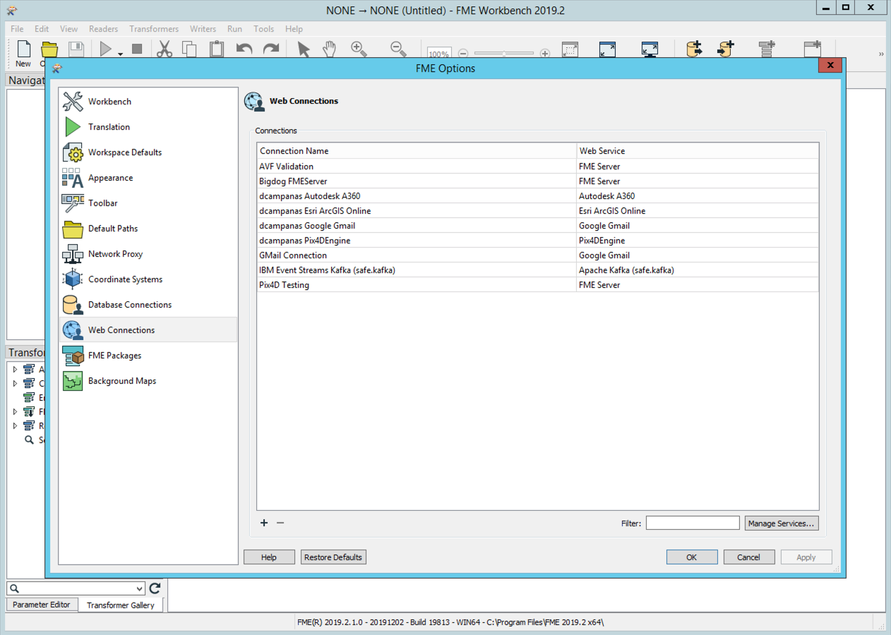

In FME Workbench, Pick Tools - FME Options from the top menu, then click on the Web Connections option.
Click on the Manage Service button to bring up the Manage Web Service dialog.
Select the Maximo EAM SaaS connection and click the Download button. Once the download is complete, close the dialog.

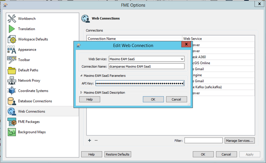

Click the '+' icon at the bottom of the Web Connection dialog to add a new connection.
  • Choose Maximo EAM SaaS as the Web Service.
  • Set a suitably descriptive name.
  • Paste in the API key from Maximo
Click OK to create the Web Connection that can be used in any of the Maximo transformers.
