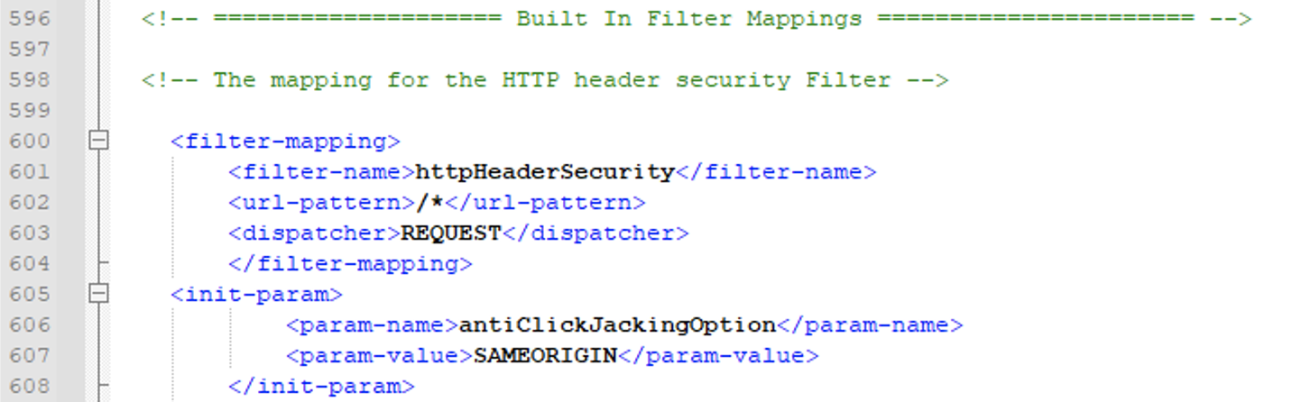

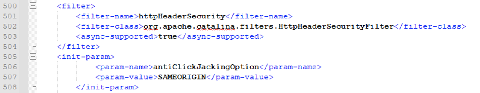

- Add in the following antiClickJackingOption parameter with the value SAMEORIGIN underneath both the closing </filter> and </filter-mapping> tags.
<init-param> <param-name>antiClickJackingOption</param-name> <param-value>SAMEORIGIN</param-value> </init-param>
6. Once complete this should look like:

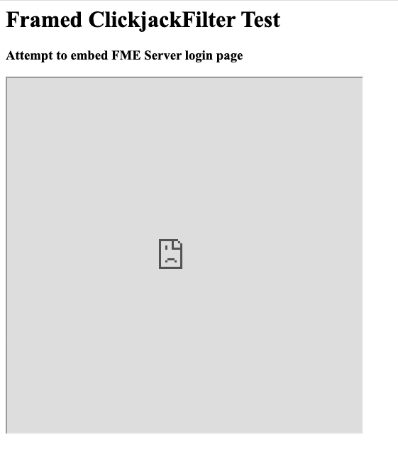

8. In the browser return to http(s)://<FMEServerHost>/tester.jsp and login, this time you'll see a refused to connect error.
