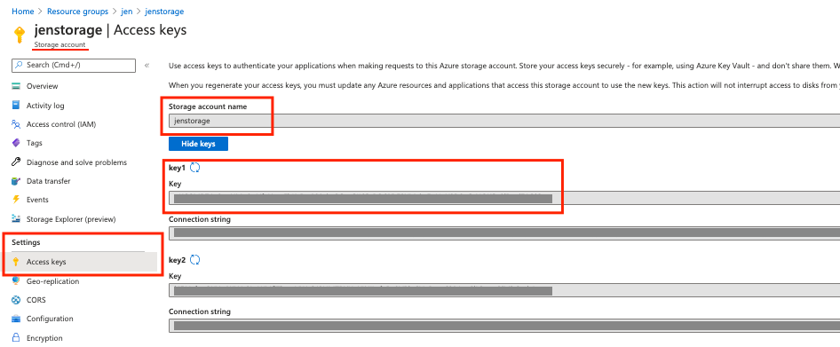

In order to set up the Azure Storage Web Connection you will need access to the Azure Portal or an Account Name and Account Key from your Azure Administrator.
Open the transformer parameters for the AzureStorageConnector that you’re using.
Choose Credential Source: Web Connection and Account: Add Web Connection
Enter in your Account Name and Account Key:
If you don’t already have the Account Name and Account Key, you will need to obtain them from the Azure Portal:

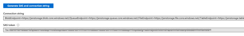

SAS (Shared Access Signature)
If you would prefer to use a Shared Access Signature (SAS) then you will need to generate this in the Azure Portal.
Be sure to configure it with the correct settings for your needs (permissions, expiration etc).
Copy the entire SAS token in the AzureStorageConnector parameter box and enter the Account Name.
