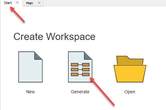

1. Generate a New Workspace
Open FME Workbench and click on Generate Workspace.

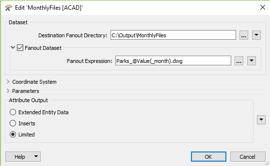

4. Setting Output Filename

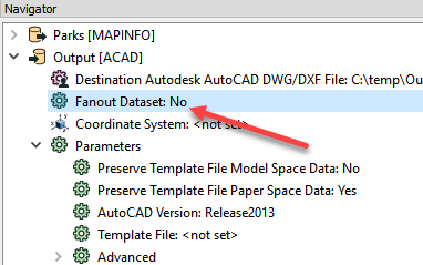

The next step is to use the newly generated date attribute in the destination file name using dataset fanout. Connect the output port of DateTimeConverter to the ACAD writer.
  • In the Navigator window, expand ACAD writer and click on ‘Fanout Dataset’.
  • Open the Fanout Expression dialog by clicking on the ellipsis button. In the text editor window, add the following expression: Parks_@Value(_month).dwg

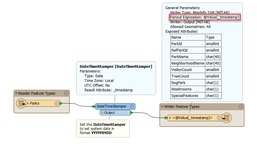

3. Setting File-name
The next step is to use this newly generated date attribute to name the destination file using feature-type fanout.

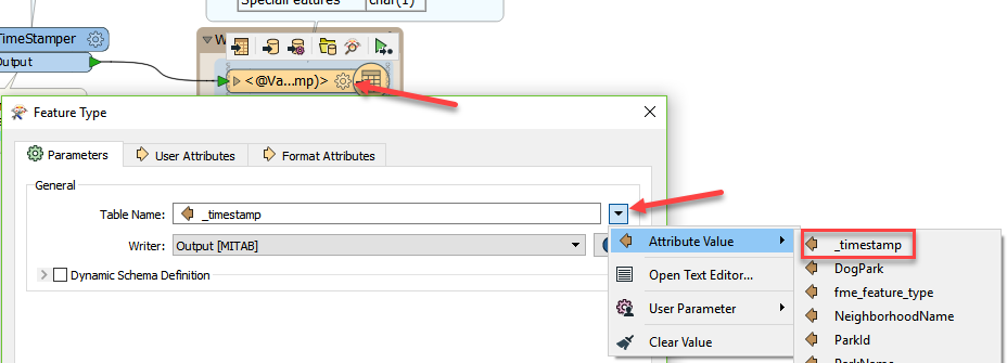

  • Open the writer FeatureType properties dialog.
  • Under the Parameters tab > General > TableName.
  • Click the drop-down button and select the _timestamp attribute as the input
4. Run Workspace
Run the workspace by pressing F5 or clicking the Run button on the toolbar. Confirm that the file is written with the date, as shown under Result
Workspace
The workspace after completion should appear as below.
Result
Run the workspace and open the Output directory. Notice that the file name contains the current date.
