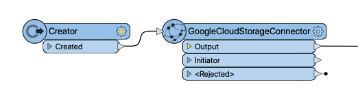

This workspace will be very simple, with a Creator, GoogleCloudStorageConnector, and an Automations writer.
1. Add a Creator and connect it to the GoogleCloudStorageConnector
2. Configure the GoogleCloudStorageConnector

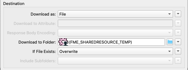

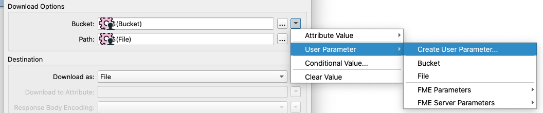

Set the Action type to Download and set up the Bucket and Path to be User Parameters. We will need these parameters to receive the values from the Google Cloud Storage Triggers.
The Destination should be a file in the FME Flow Temp location. It can go anywhere on FME Flow, but for this demo, it is being written to the temp location so that it doesn’t persist for a long time and take up space in the FME Flow System Share.
For the Output Attributes, ensure _download_path is selected.

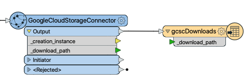

3. Add an Automations Writer
The Automations writer will output the download location of the file to the next workspace for processing.
Make sure the _download_path attribute is defined on the writer

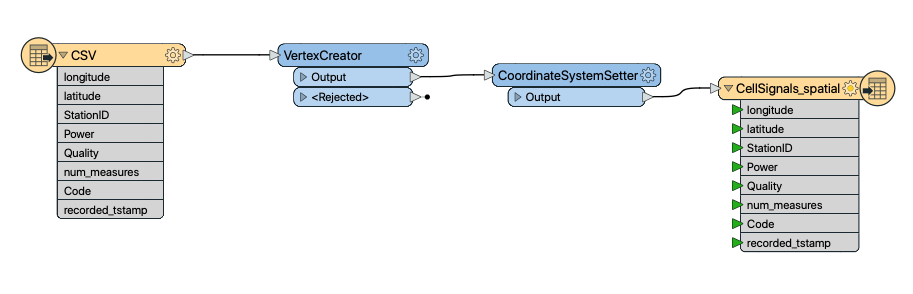

1. Add a CSV reader
Add a CSV reader, reading in the CellSignals.csv file.

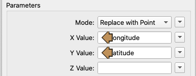

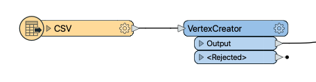

2. Connect the CSV output to a VertexCreator transformer
We will be taking the latitude and longitude columns in the CSV to create a spatial dataset for Google BigQuery. (Remember to get the X/Y and latitude/longitude the right way round!)
3. Add a CoordinateSystemSetter
Connect the CoordinateSystemSetter to the VertexCreator, so the created points have a location. Set the coordinate system to LL-WGS84.
4. Add a Google BigQuery writer
Now that the data is spatial, we are ready to write it to Google BigQuery.
When you add the writer, click on Parameters to set your credential source and dataset.

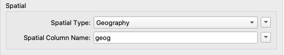

Make sure the writer is set up for spatial data:
5. Test and publish your workspace to FME Flow
Your final workspace should look like this:
You can test this in FME Form and confirm in Google BigQuery that the data was written:

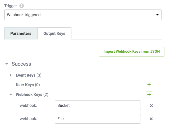

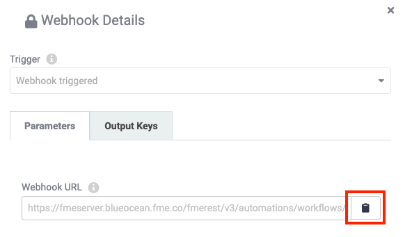

1. Add a Webhook Trigger
With a webhook trigger, the webhook URL will be generated once the automation is started. We will need this in Part 3.
On the Output Keys tab, add two webhook keys for Bucket and File:
In Part 3 when we create the Google Cloud Storage Triggers we will create JSON with those two keys.

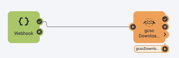

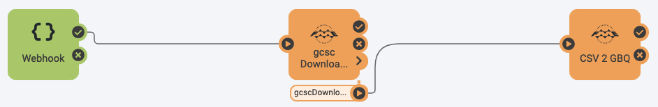

2. Add a Workspace Action
Connect the workspace action to the success port of the webhook trigger:
This workspace should be configured to download data from Google Cloud Storage.

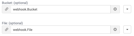

Set the published parameters to match the webhook output keys:
3. Add Another Workspace Action
Add the final workspace action, which is the workspace that uploads the data to Google BigQuery. Connect this to the automations writer output:
Set the Source CSV File to be the _download_path from the previous workspace:

Make sure to add the FME Flow webhook URL, which you can copy from the webhook trigger:

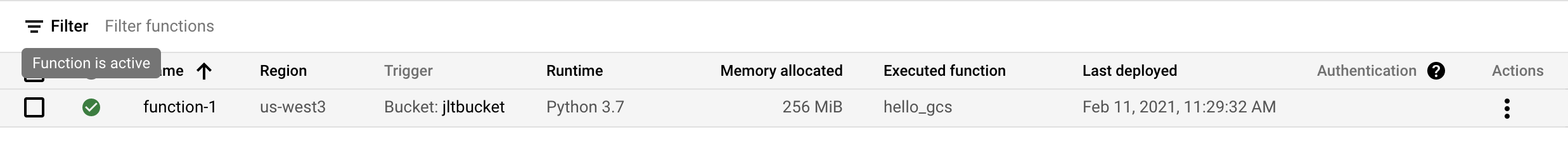

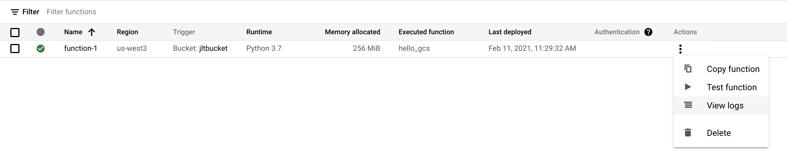

3. Deploy the Function
Click Deploy to deploy your function. On the main functions page, wait for the function to become active:

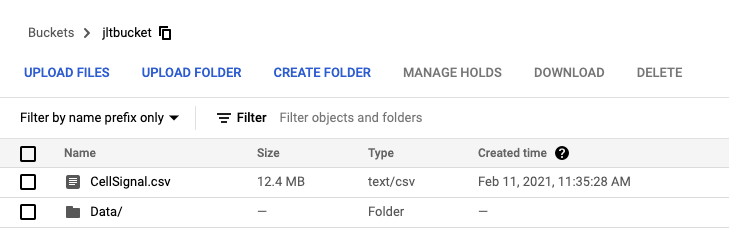

1. Upload CellSignals.csv to Your Bucket

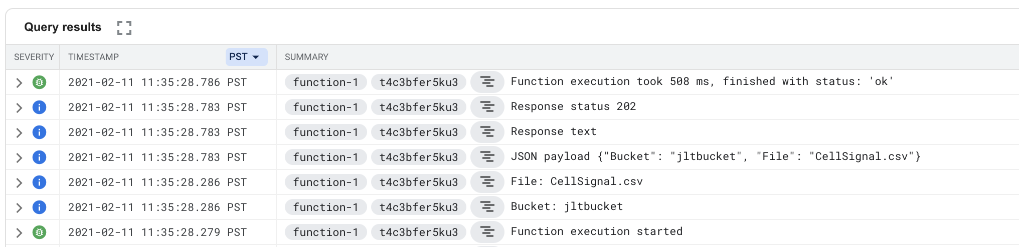

2. Check the Google Cloud Function Logs
You should see some information logged that shows the bucket, file, JSON payload and FME Flow response:

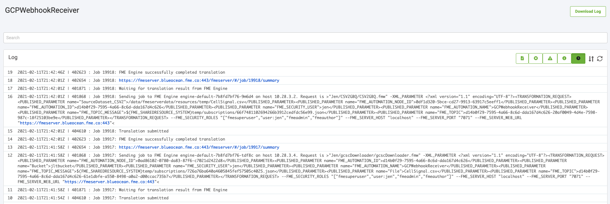

3. Check the Automations Log File
From the Automations page, open the Menu and click View Log File:
You should see two translations completed successfully.

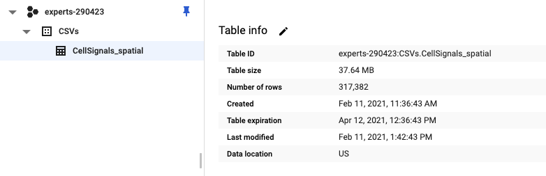

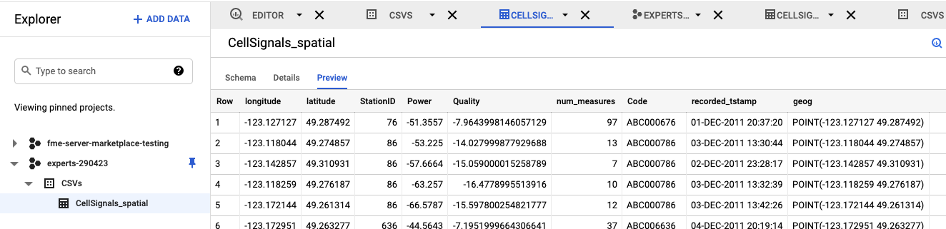

4. View the Data in Google BigQuery
You can check the table details to confirm that the Created or Last modified datetime is the same time that the workspace ran:

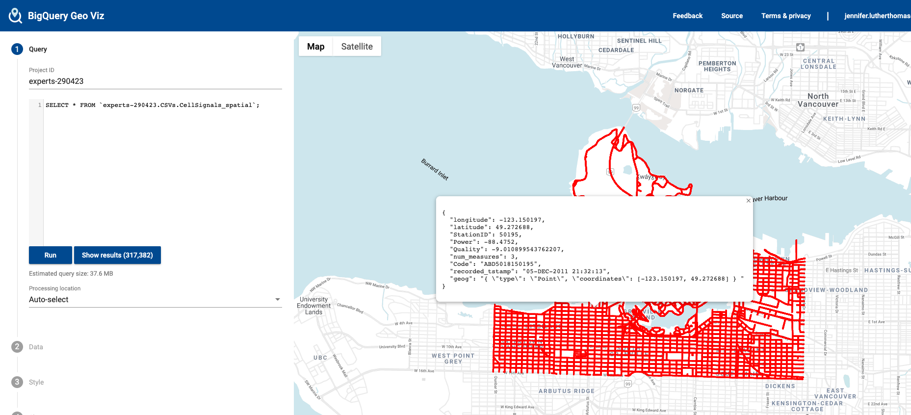

To visualize the data, click Export > Explore with GeoViz
Once GeoViz loads, run the query.
You should see the Cell Signal data points over Vancouver:
You can click on any of the points to see the attributes written by FME.
