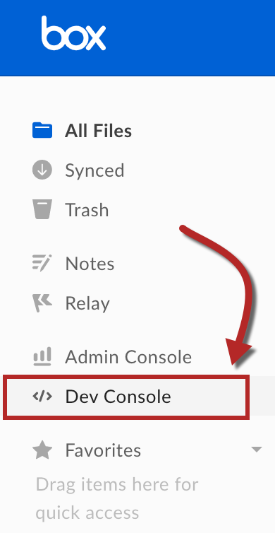

2. Navigate to the Developers Console
Once you are logged in, navigate to the Developers Console for Box.com either through the link or by clicking on Dev Console in the side menu bar.

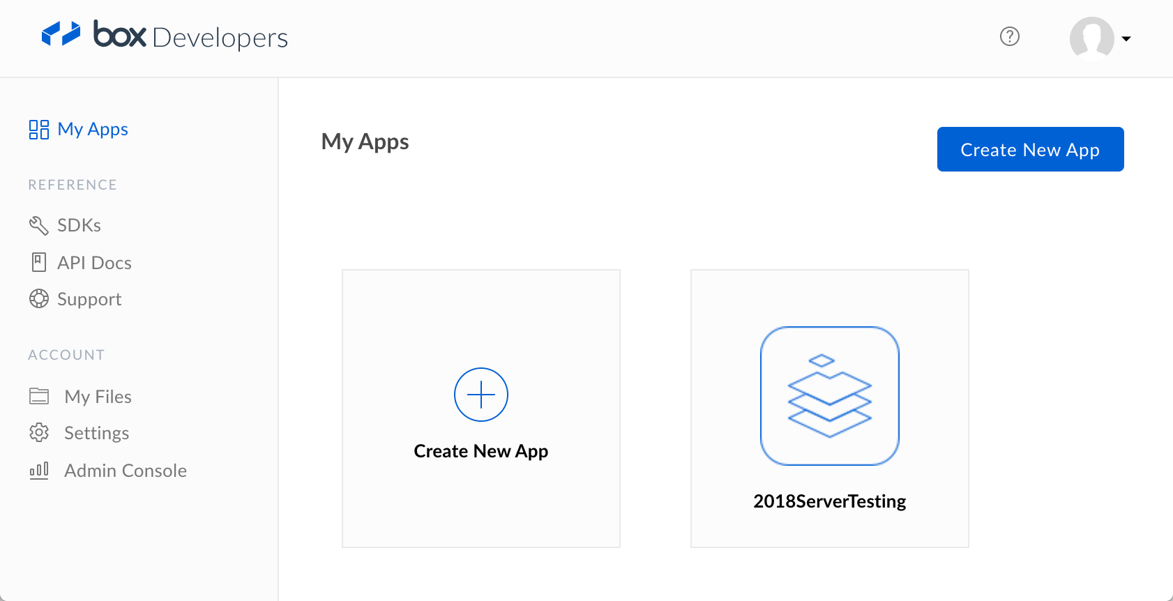

3. Create New App
Inside the Developers Console, click on the Create New App button. If you have any existing apps, they will also show up on this page.

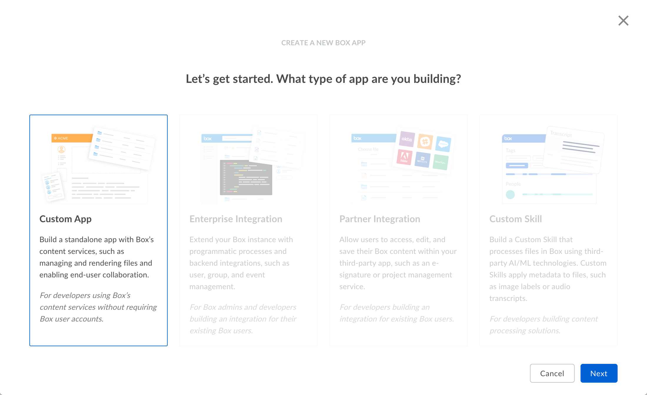

Now we will work through the Create New App wizard. Click on the Custom App box; we will be using the Custom App because it doesn’t require the enterprise to authorize our app. Click Next to move to the next screen in the wizard.

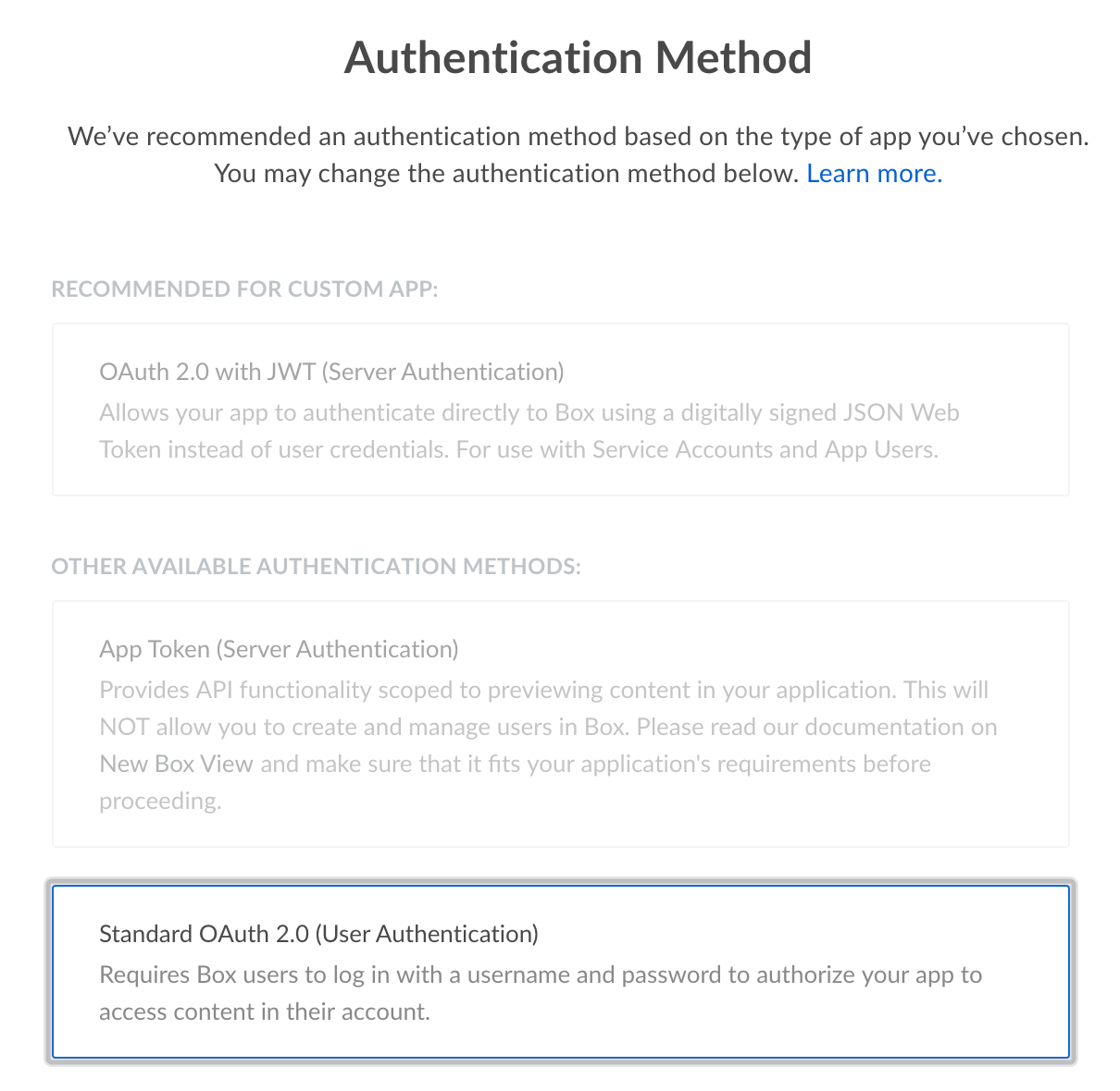

Now we will choose our authentication method. For our app, we want to have the user log in, select Standard OAuth 2.0 (User Authentication), and then click Next.

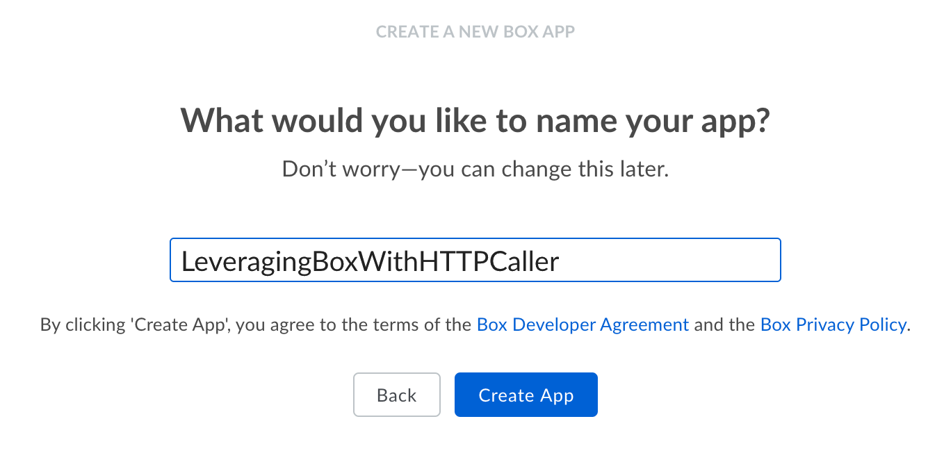

Finally, we need to give our app a name. You can name it whatever you like. In this example, we named it LeveragingBoxWithHTTPCaller. Once you are satisfied with your name, click Create App.

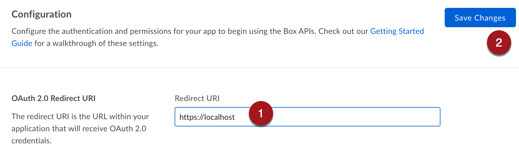

In the Configurations, we will set up our Redirect URI. Scroll down to find the OAuth 2.0 Redirect URI section, and then in the text box, change the URI to http://localhost . Using localhost is acceptable for our new application as we will consider it to be in development. Once your Redirect URI is set, click Save Changes.

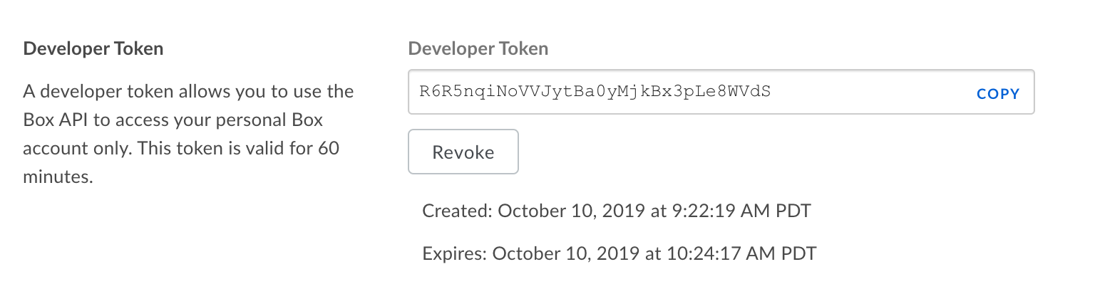

5. Copy Token
After the Redirect URI has been set, we can copy our Developer Token for use in the next articles. Still on the Configurations page, scroll back up to the Developer Token section and then click Copy.
The developer token string will grant anyone who uses it, access to your Box.com account through the API and is required for the next articles. Keep it private and safe! Note that the developer token will only be valid for 1 hour but can be manually refreshed through the console.
Limitations using developer tokens in addition to the expiration time are that tokens are only valid for your own account, and there is no paired refresh token.

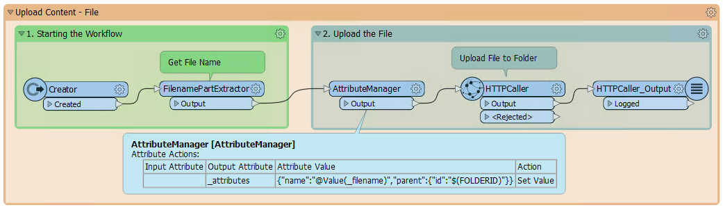

1. Upload a File to a Directory
The UploadFileToFolder.fmw workspace uploads a file to a directory in Box. Requires a Developer Token to run the workspace as well as a file or folder to upload. A file to upload can be found in the download folder attached at the beginning of this article.

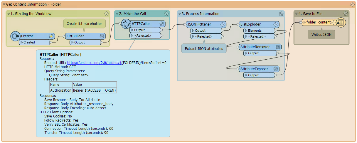

2. Get Content Information for a Folder
The GetFolderInfo.fmw workspace gets the content information for a folder or file. Requires a Developer Token to run the workspace as well as at least one file or folder uploaded to Box.com
