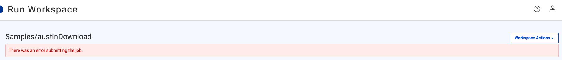

Trying to run a job in FME Flow will result in this error:

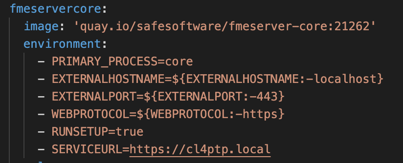

2. In the Docker Compose file, add an environment variable to the fmeflowcore service:
SERVICEURL=https://host:port
This will set the service URLs to the domain or hostname of the host machine. This environment variable saves doing this manually in the web ui post-install.
Omit this step if you want to retain the ability to edit service URLs in the FME Flow web interface.

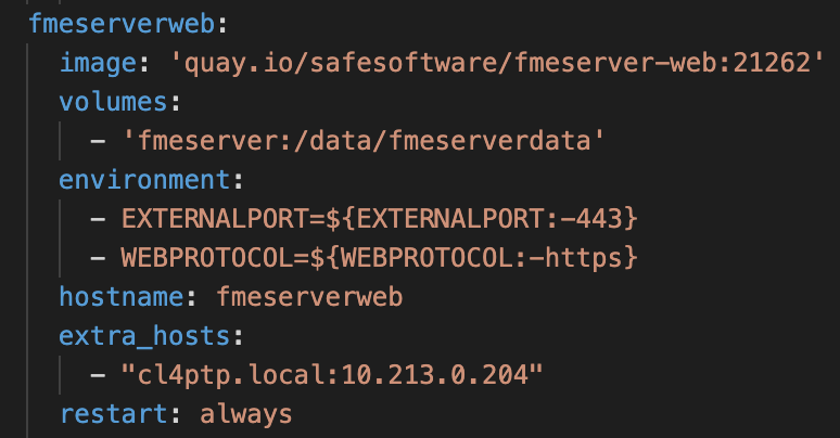

3. Configure extra_hosts for the fmeserverweb service. This maps the domain name to the IP address so the web container can resolve it.
    extra_hosts:
      - "host:ipaddress"

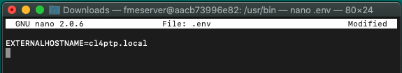

Option 2:
Create a .env file in the same directory as your Docker Compose files and add any environment variables to it. Docker will automatically use these values.
