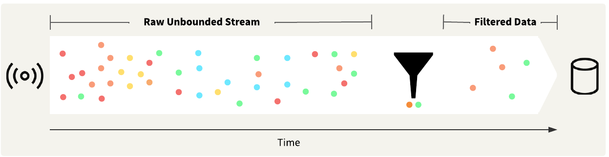

As sensors and devices become more ubiquitous, the volumes of data we have to handle will continue to increase. In some situations, storing all of this data (usually in a data lake) will be a requirement for downstream analysis. However, it is often the case that storing all the data coming from a stream is either not required for analysis or the costs to do so would be prohibitively expensive.
The primary goal of filtering unbounded data streams is therefore to reduce data volumes in memory before committing data to disk.
There are several ways in which data can be filtered: attribute values, location, or time.
Filter on Attribute Values
Read the attribute values on the incoming data, apply a filter condition, and then discard data that doesn’t meet the condition.
Streams Diagrams Rebranded - Filtering - Dicard Based upon Attributes (1).png
Scenario
A city is monitoring the location of all of its operational vehicles (e.g. SUVs, refuse vehicles, maintenance vans) so they can better understand vehicle movement. The specific study is looking at trucks only so they wish to identify vehicles that are of type trucks and commit them to a database.
Workflow
The workspace connects to the message broker, in this case, we are using Kafka. The JSON-formatted payload, which represents the location of the vehicle, is then flattened into individual attributes. The vehicle type attribute on each message/feature is then tested to see if the message originated from a truck. From there, the attributes are cleaned up in the AttributeManager and pushed to the output destination.
