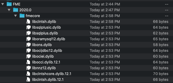

sudo sh -c "ln -fhs /Applications/OracleClient/instantclient_12_1/*.dylib* /Library/FME/2020.0/fmecore/"
5. If the Oracle Instant Client doesn't have a libclntsh.dylib file, create one more symbolic link. NOTE: New versions of the Oracle Instant Client will not require this.
sudo ln -s /path/to/OracleClient/libclntsh.dylib.<insert version eg 12.1> /Library/FME/2020.0/fmecore/libclntsh.dylib
example:
sudo ln -s /Applications/OracleClient/instantclient_12_1/libclntsh.dylib.12.1 /Library/FME/2020.0/fmecore/libclntsh.dylib
6. Launch FME Workbench and add an Oracle Reader and test the workspace.
Removing the Oracle Library references from macOS.
The commands above create the following files (libclntsh.dylib may not be present if step 7 skipped).
These files can simply be deleted from the /Library/FME/<2020.0>/fmecore location to remove the Oracle Client configuration from FME on your macOS.  Note: <2020.0> may represent 2019.2, 2020.0, 2020.1, 2020.2, 2021.0 and so on.  These files will only exist if these instructions were used to configure FME with the Oracle Client.
