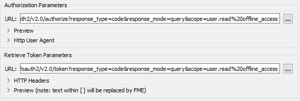

7. Configure the Authorization and Token URL Parameters
View the Get access on behalf of a user documentation to see what FME needs to send to the Microsoft identity platform endpoint.
As some of those parameters are already specified in FME (client ID, for example), we only need to add a few.
Edit the Authorization URL, Token Refresh URL, and append
?response_type=code&response_mode=query&state=13278&scope=offline_access%20user.read
In this example, the only scope requested is offline_access and user.read. "%20" is the URL-encoded representation of a space character.
Offline access gives you a token with a longer lifetime, so you don’t have to re-authenticate regularly.
User reading allows Microsoft to verify identity by authenticating the user's profile.
The Permissions and Consent section of the Microsoft identity platform documentation describes the offline_access scope and others.
We could also include the permissions from step 4 in the scope, but as they have already been consented to, they don’t need to be. You can read about the consent experience here.
