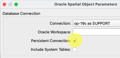

Persistent Connection
Workspaces that use the “Persistent Connection” for Oracle will have this behaviour. This reduces the number of new connections made to the database, reducing resource usage at the database (reducing open sessions). This is an optional setting when selecting an Oracle Database Connection in the workspace. So, this can be unchecked (see screen grab below), and that will also close the connection once the job is complete.
