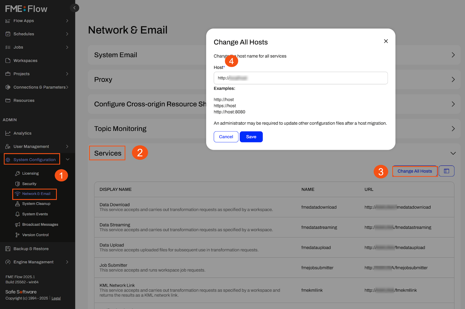

Update Service URLs
FME Flow's Web User Interface uses various service URLs when submitting requests to each service. These service URLs must be updated to use the hostname of the reverse proxy. Start by logging into FME Flow under an admin account:
  1. Locate Services under Admin > System Configuration> Network & Email.
  2. Expand the “Services" section.
  3. Click the “Change All Hosts" button.
  4. Update the hostname for all Service URLs to use the hostname of the reverse proxy.
This screenshot was taken in FME Flow 2025.1; the interface may differ, but the concepts are the same.

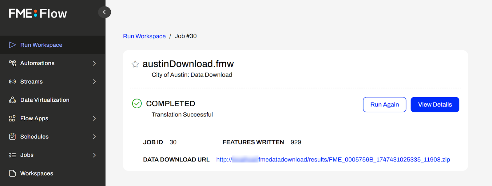

  • Similarly, confirm that FME Flow can run the workspace with Service: Data Streaming
  • Confirm that FME Flow can run the workspace with Service: Data Download
  1. On the Run Workspace page, specify:
a. Repository: Samples
b. Workspace: austinDownload.fmw
c. Service: Data Download
  1. Click Run, and upon job completion, click the “Data Download URL” to download the result. Ensure that the URL uses the reverse proxy hostname.
