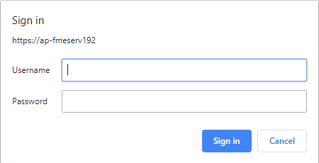

"When I click on the 'Use Windows Credentials' button an additional Sign in dialog pops up"
Using Google Chrome after attempting to log in to FME using SSO a second Sign In box appears requesting my credentials:
but if I insert my credentials and click Sign in, nothing will load and the pages stays blank. When I check the fmeserver.log there is no record of my attempt to sign in, this is because the client browser does not trust my server, so logging will be limited.
This is a web browser configuration issue that can be resolved through the Internet Options settings, where you must add FME Flow to the list of trusted sites. You can find instructions on how to do this under the Microsoft Edge heading here.

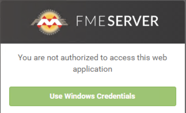

“Using ‘Use Windows Credentials’ I am returned You are not authorized to access this web application”
When I attempt to login to FME Flow via single sign-on, the login page is returned with a warning that I am not authorized to access this web application. However if I type in my active directory credentials the login is a success.
There are two known causes for this error.
1. For your Active Directory Connection set up check what you have entered for the SSO Service Account Name. This username should just be entered in as USERNAME (i.e. no DOMAIN) unlike the Search Account Name. If you have entered a domain name here then you will be presented with the above error and will be unable to log in using SSO.
2. Please specify a Realm in the Optional Fields section of the Active Directory Connection set up.
