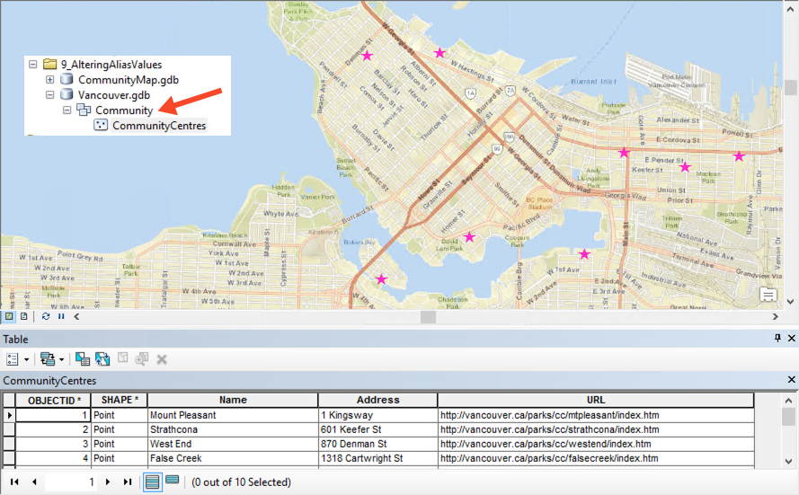

As an optional step, if you wish to write the Community Centres data to a feature dataset, open the writer feature type parameters, and under Table Creation Parameters, type "Community" for Feature Dataset.
4. Save and Run the Workspace
Save and run your workspace. You can view the new alias names in ArcMap.
