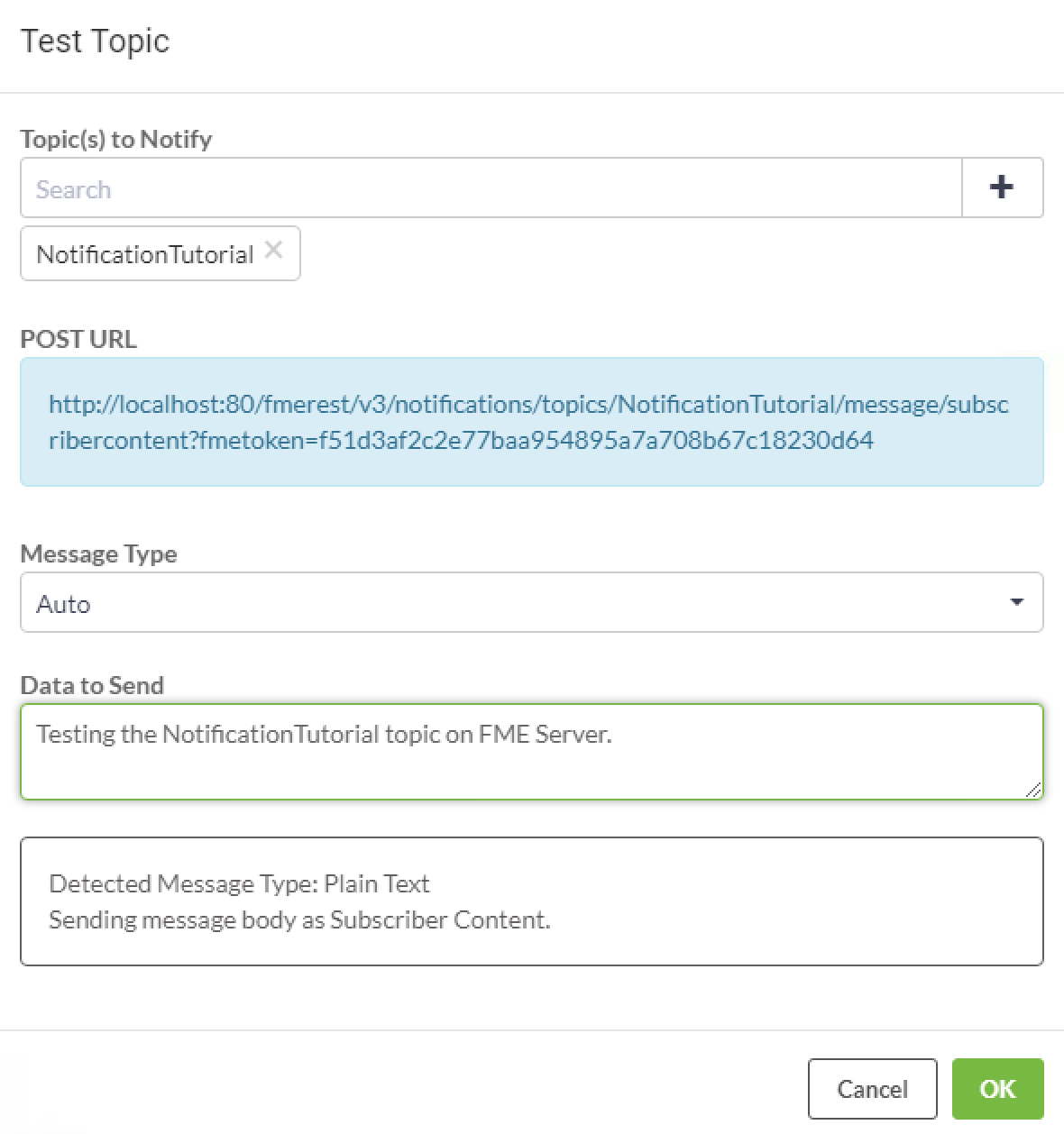

Alternatively, we can use the FMEFlowNotifier transformer. In most cases, a publication (defined in the Web User Interface) will send a message to a topic. However, the Test Topic option can be used when developing the solution:

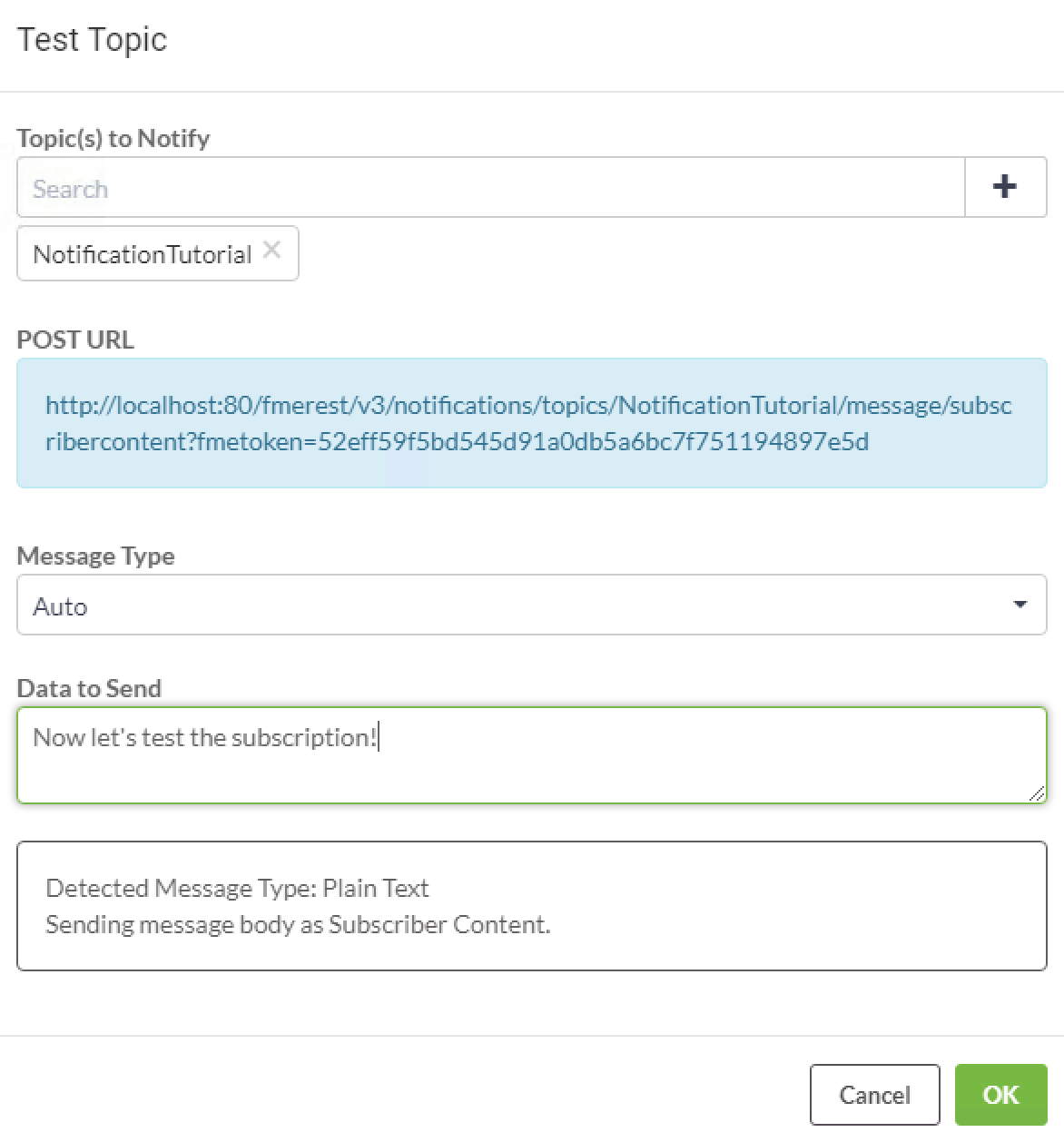

1. Click Notifications > Topics.
2. Select the topic you created previously, NotificationTutorial, and click Test Topic.
3. Enter some text to send in a notification message and click OK.

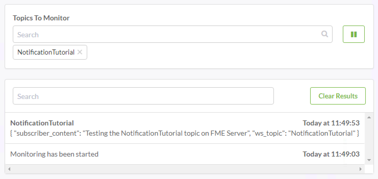

Messages can be inspected using the Topic Monitoring ability in the Web User Interface:
1. In a new browser window/tab, open Notifications > Topic Monitoring; this window needs to stay open for Topic Monitoring to continue running.
2. Select the topic you want to monitor, NotificationTutorial, and click the play buttonjuowgyNc5XfHmBxLzKZGf6iFP9PFzW5i9uptQS0Y8xhsYTJJ4suwawnROLBEuUeSRreEsh5iKWbI-HQgX0X7SAP60BxTGRJqz3IqpxavH1kk_jrE111maHDajt80Q9xHfC4d_9Y to start monitoring the topic. Any messages sent to the topic will be displayed.
4. In a different window/tab, go to Notifications > Topics and use the Test Topic option mentioned previously to send a message.

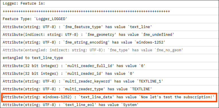

Sample Notification Message
To create the workspace you need a sample message that can be utilized in transformers throughout the workspace - this message is often JSON or XML. A quick way to generate the sample message is to use Topic Monitoring, mentioned previously, or you can copy a sample from somewhere else, and then save the sample message into a text file.

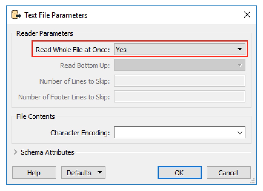

1. In FME Workbench, open up the CreateNotification.fmwt workspace and skip to step 5 or create a new workspace that reads the sample notification message using a Text File reader. Ensure that you set the Text File reader parameter 'Read Whole File at Once' to 'Yes'.

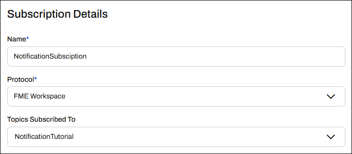

To have the workspace process messages you need to create a workspace subscription:

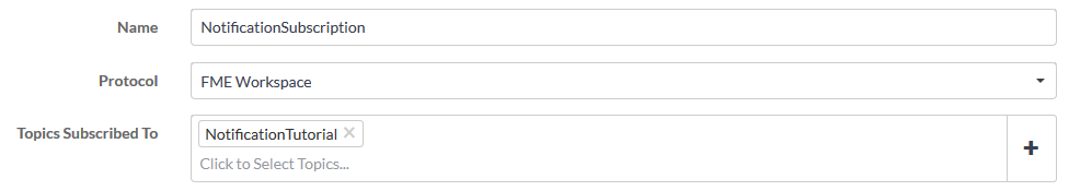

1. Click Notifications (Classic) > Subscriptions.
2. Click Create to create a new subscription. Give it a name such as NotificationSubscription.
3. Under Protocol, select FME Workspace.
4. Select the topic you defined previously, NotificationTutorial, for the Topics Subscribed To parameter.

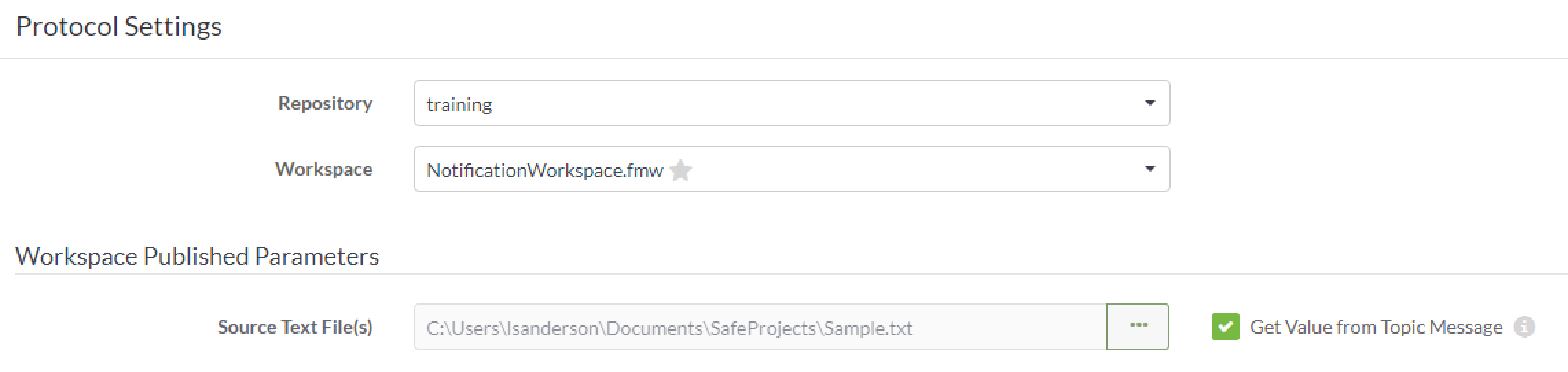

5. Under Protocol Settings, set the Repository as training and the Workspace as NotificationTutorial. Ensure that Get Value from Topic Message is enabled.
6. Click Create to create the subscription. The subscription will be listed as NotificationSubscription.

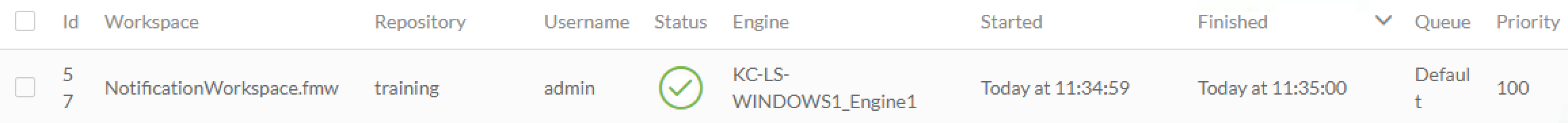

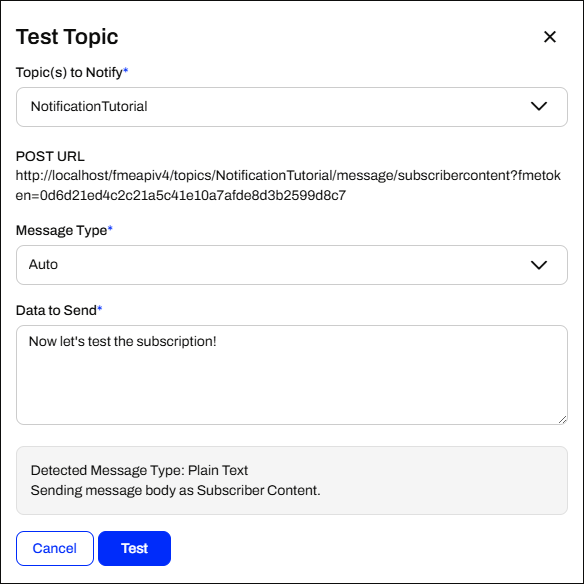

Test the Subscription

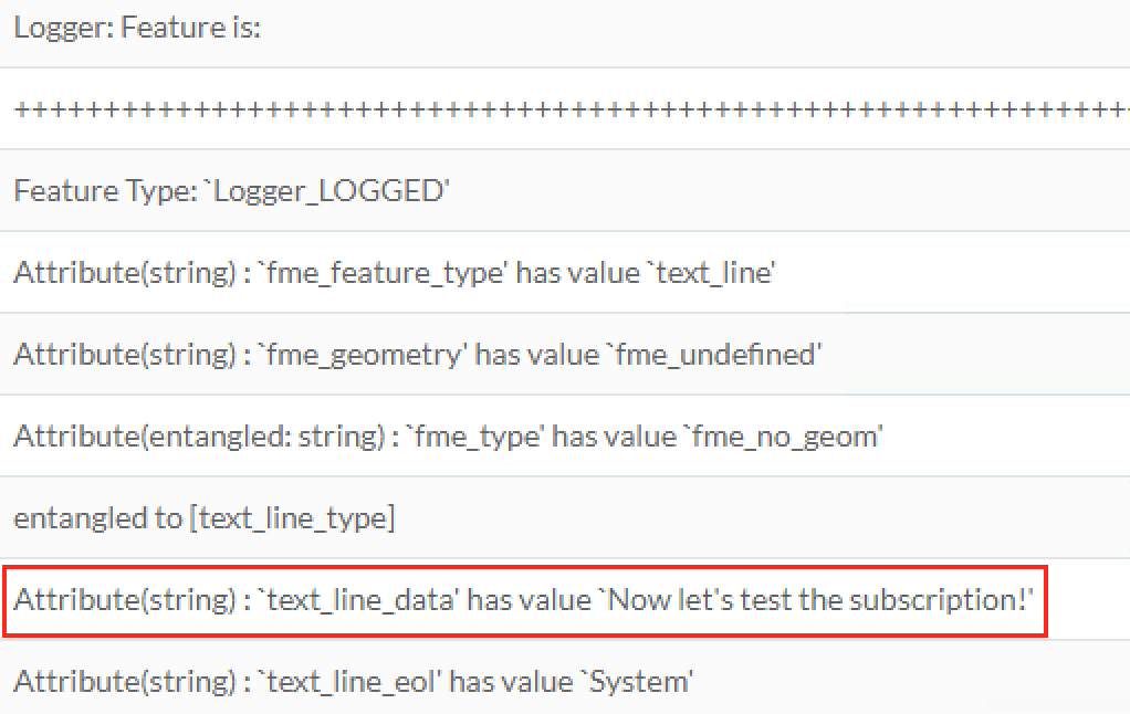

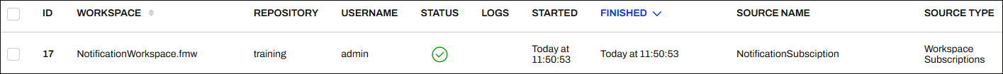

1. Use the Test Topic option to send a message
2. Check the Jobs page to confirm that the workspace ran successfully. This will be the same result for both Option 1 or 2 when setting up the Subscription.
Congratulations! You have now successfully created a subscription that will run a workspace when a specific topic is triggered!
