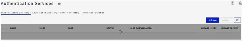

This issue occurs after creating a backup in a 2021.x version of FME Server and restoring it to a 2023.x FME Flow. When navigating to User Management > Authentication Services on the 2023.x FME Flow, an “Internal Server Error” message pops up and the screen stays greyed out with a loading icon. The HAR log says 500 Internal Error.
AD-imported users are able to log in but they cannot access the authentication services page or create another connection.

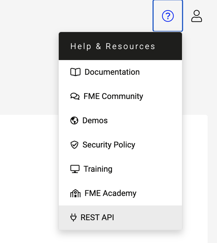

1. Navigate to the APIs found in the Help & Resources question mark icon > REST API. Once on the page, request a token on the top right with Get Token.

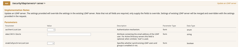

3. Find the PUT call /security/ldap/servers/<server> (description Update an LDAP Server) and expand. Here you will fill out two fields in the API form: server and redundantServers.

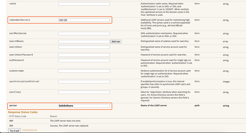

4. Enter the name of the LDAP server that is affected in the server field. In the redundantServers field, enter in a valid string such as 123;123.
5. Click Try it out! To send the API request and you should see a response code of 204.

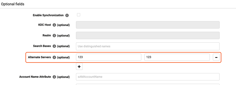

This will unblock the Authentication Services and you should be able to view your LDAP servers. In the server’s details, you can go to Optional fields and remove the redundant server that was added under Alternate Servers.
