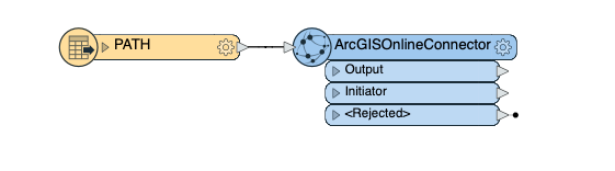

2. Add a Directory and File Pathnames Reader to the canvas
Add a Directory and File Pathnames Reader to your canvas by clicking on the canvas and typing “Directory and File Pathnames”. The Directory and File Pathnames Reader will read in the Pathnames of the files we are uploading. Select the Zipped Shapefiles directory, which is available for download at the top of the page. Unzip the file to get access to the Zipped Shapefiles folder.
3. Add an ArcGISOnlineConnector
Next, add the ArcGISOnlineConnector to the canvas. Connect the ArcGISOnlineConnector to the Directory and Filenames Reader.

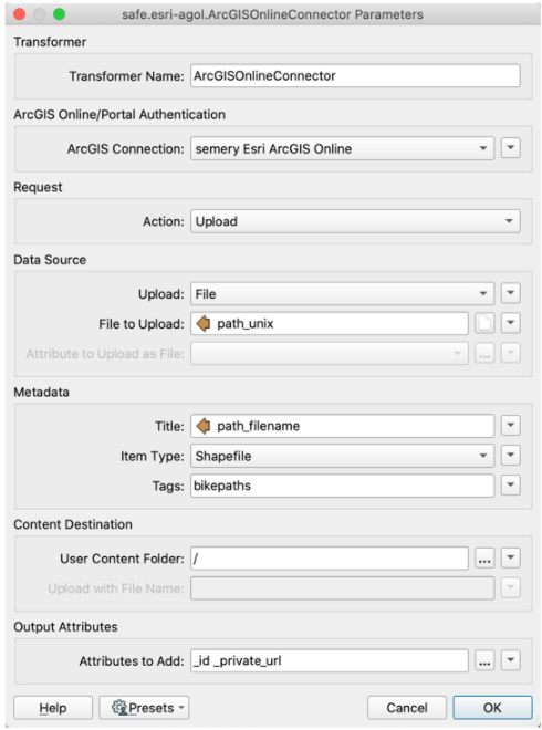

2021-10-05_11-58-58.png Open the ArcGISConnector parameters. In the parameters, find the section that says ArcGIS Connection and click the down arrow to view your options.  If you have previously set up an ArcGIS Online or ArcGIS Enterprise Portal connection, you can select it here. If you need assistance creating a connection please see the articles listed in the requirements section.
In the Request section of the transformer, find the field action and select Upload.
In the Data Source section, select the dropdown arrow beside File to Upload, find Attribute Value, and then select path_unix (if you are on a Mac) or path_windows (if you are on a Windows machine). In the Metadata section, find the Title field and select the attribute path_filename. In the Item Type field select Shapefile. Then, in the Tag field write bikepaths.
Find the Content Destination section. Here a content folder can be selected in FME. For now, leave this at the default to upload files that are not in a specialized folder in ArcGISOnline.
Click OK to close the parameters dialog.

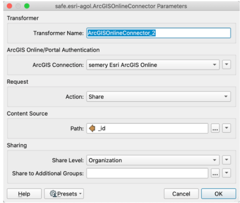

In FME Workbench, add a new ArcGISOnlineConnector and attach it to the existing ArcGISOnlineConnector. This new ArcGISOnlineConnector will be used to share resources with the organization.
Open up the parameters. Find the ArcGIS Connection field and select the same connection used in the first ArcGISOnlineConnector.
Find the Action field and select Share. Next, find the Path field and select the attribute _id. Finally, find the Share Level field and select Organization.
Select OK to close the dialog.

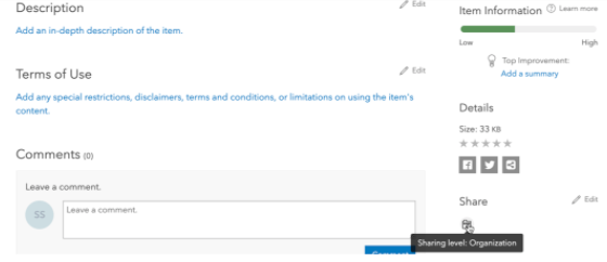

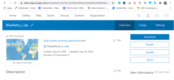

Run the workspace again.  Once the workspace has completed, click the green magnifying glass on the Output of the ArcGISOnlineConnector_2 to inspect the output. This will show the attributes in the Visual Preview window. Find the _private_url attribute, then copy and paste it into a browser window.
Scroll down the page and find the Share section. Here, you should see that the shapefile is now shared with your organization.

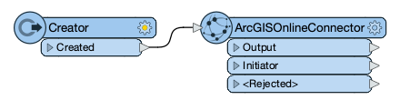

3. Add the ArcGISOnlineConnector

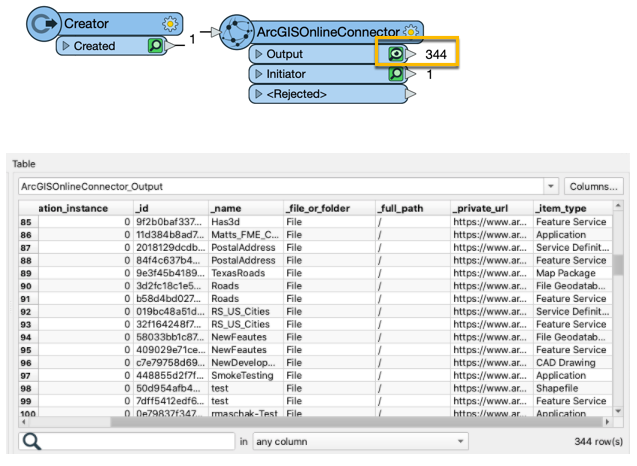

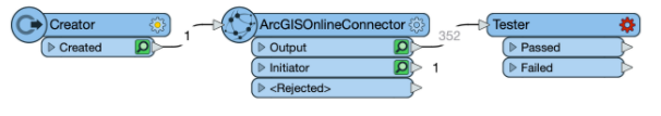

Next, add the ArcGISOnlineConnector to the canvas. Connect the ArcGISOnlineConnector to the Creator.
Open the ArcGISOnlineConnector parameters. Find the ArcGIS Connection field and select the same connection used in Part 1.

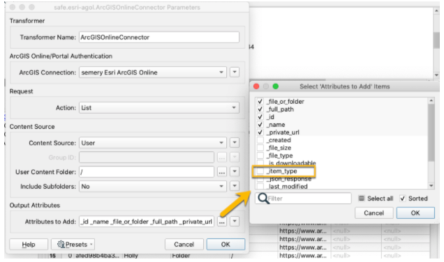

After your connection has been selected. Modify the Attributes to Add and add the _item_type attribute. This will expose the file type attribute, which can be used to filter the results of the ArcGISOnlineConnector. Select OK to exit the Attributes to Add dialog.
Select OK to exit the ArcGISOnlineConnector Parameters Dialog.
4. Run the Translation and Inspect the Output
Run Workspace to run the translation. Click on the Output button to view the data output from the ArcGISOnlineConnector.

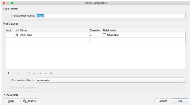

5. Add a Tester
Add a Tester to the canvas. Connect the Tester to the ArcGISOnlineConnector.

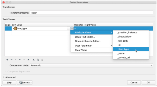

In the Tester parameters, select the Left Value, find Attribute Value, then select _item_type.
Then, in the Right Value, select Shapefile from Cached Values, or type Shapefile.

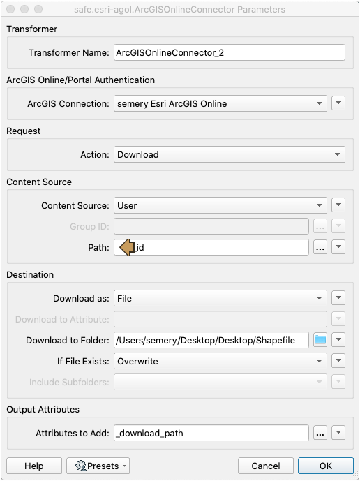

Open up the ArcGISOnlineConnector_2. Set the Authentication by selecting an ArcGISOnline Connection or Portal. Next, select the Download action. The Content Source should be User and the Path should be set to the Attribute _Id.
Under the Destination section, set the Download as parameter to File. Then, select a Download To Folder.

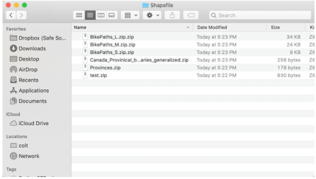

7. Run the Translation and View the Results
Click Run, to run the final step of the translation. This will download all your shapefiles to the folder selected. Open the folder and find the files downloaded from ArcGIS Online!
