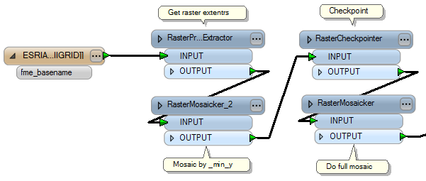

To work around the problem, create a set of smaller sub-mosaics using a RasterMosaicker and then use the RasterCheckpointer to cache them to disk. The subsequent full mosaic will use the checkpointed sub-mosaics as its image source rather than the original data, avoiding the need to open a large number of files.
Example:
In this example, the RasterPropertiesExtractor is used to get the extents of the source images. The first RasterMosaicker has its Group By set to _min_y, so it will create a sub-mosaic for each horizontal line of source images. The RasterCheckPointer writes the sub-mosaics out to a disk cache. The second RasterMosaicker uses a smaller number of cached images to create the full mosaic.
Because the sub-mosaics are cached to disk, only the source files required for a single sub-mosaic will be open at any given time. The Group By for the sub-mosaicker should be set to an attribute value that will keep the number of source images in a sub-mosaic less than the 512 file limit, while also limiting the number of sub-mosaics to less than 512. In this example, we used each horizontal line of source images, but your source data may require a different strategy.
