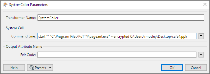

Modify this command to point to the Pageant.exe located on your machine if the installation path is different and the location of your private key, then add the following line in the SystemCaller:
start "" "C:\Program Files\PuTTY\pageant.exe" --encrypted C:\Users\rmosley\Desktop\safe4.ppk
System Caller Parameters
Note: the --encrypted command option adds a private key to Pageant without decryption and works for keys created with and without a passphrase. If the key was created with a passphrase, Pageant will prompt for the passphrase using a dialog when the client application (eg. FTPCaller) attempts to use the key.

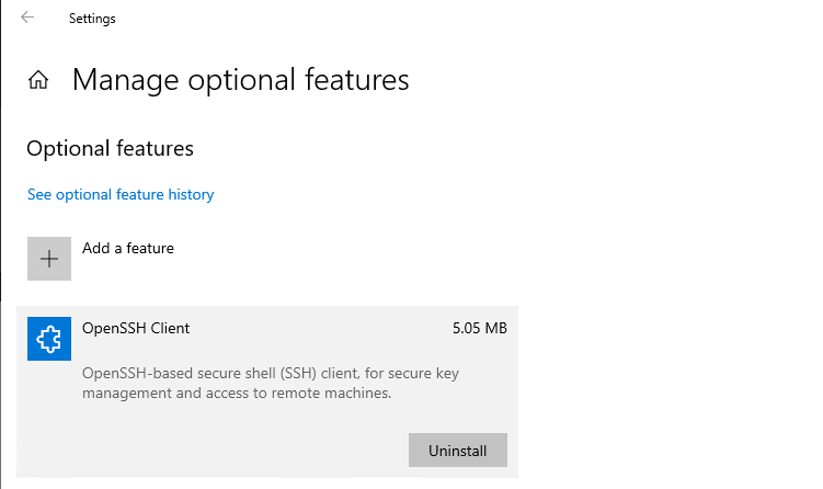

OpenSSH for Windows is now supported on certain Windows versions such as Windows Server 2022, Windows Server 2019, Windows 10 (build 1809 and later). In order for a client machine to connect to a destination SFTP server using the SSH protocol, OpenSSH Client must be installed on the client machine.
OpenSSH Client is an optional feature and may not be installed by default. Ensure it is installed by going to Settings > Apps & features > Manage Optional Features before attempting the steps in this section.
Ensure OpenSSH client is installed on the machine as it is an optional feature on Windows

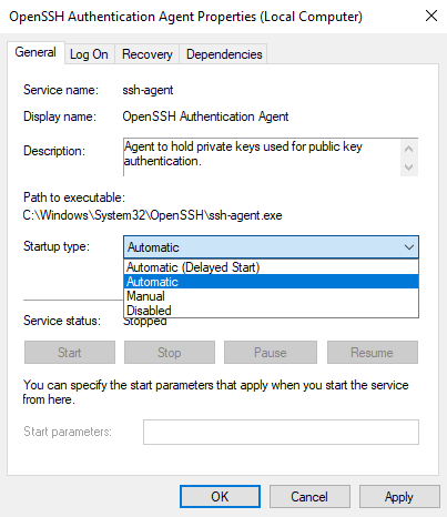

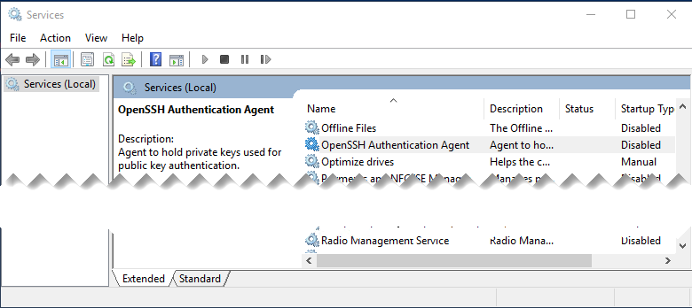

3. By default, OpenSSH for Window’s ssh-agent service is disabled and does not start automatically. Configure ssh-agent to start automatically by running services.msc as an Administrator to open Windows Services dialog window and changing the OpenSSH Authentication Agent service Startup Type to Automatic.
OpenSSH Authentication Agent is disabled in services.msc by default
OpenSSH Authentication Agent is disabled on startup by default.
Change OpenSSH Authentication Agent to startup type to
Manually configure OpenSSH Authentication Agent to start automatically.
4. Either restart the client machine to start ssh-agent or manually start ssh-agent by running the command "ssh-agent" in a Powershell or Command Prompt window.

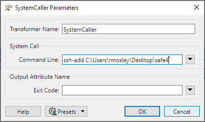

Modify the following command to the location of your private key, then add the line in the SystemCaller.
ssh-add C:\Users\rmosley\Desktop\safe4
Use "ssh-add \\path\to\key" syntax in the SystemCaller to add a private key to ssh-agent

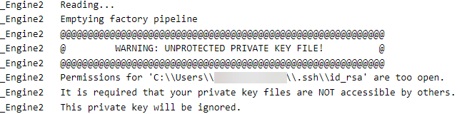

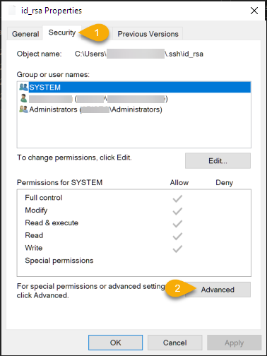

Unprotected private key file warning when adding SSH key to ssh-agent
You may run into the following error when adding your private key to ssh-agent:
Warning: Unprotected private key file!
Permissions for 'C:\path\to\private\key' are too open.
It is required that your private key files are NOT accessible by others.
This private key will be ignored.

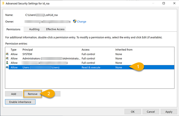

To resolve this error, right-click on the private key and select Properties from the drop-down menu. Select the Security tab and select the Advanced option.
Access the private key file's security properties in the Properties > Security > Advanced

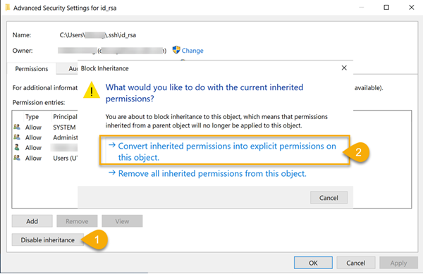

Disable inheritance and select ‘Convert inherited permissions into explicit permission on this object’ in the resulting dialog.
Disable inheritance and convert permissions to explicit on the private key file
Select the Users group entry and remove it from the permission entries.
Select the Users group entry and remove from permission entries
