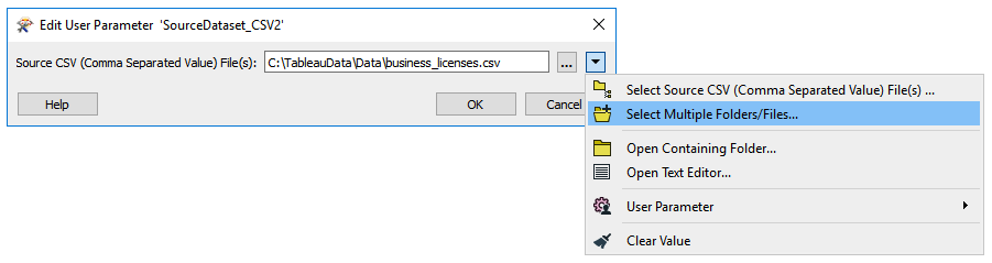

In the Navigator pane, expand the CSV reader. Double-click on the source CSV file parameter, then open the advanced browser. Click on "Select Multiple Folders/Files..." Navigate to the folder containing the four CSV files, and select it. Read the files with a .csv extension from that folder. Remove the .gz file and the .txt file, and the previous .csv file, we are only interested in .csv files from the PastYears folder.

Change the Source CSV file(s) in the the Navigator
Select Multiple Folders/Files... then click on the PastYears folder to add it

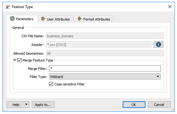

Now that we've set up the reader, the next step is to set up the existing source feature type on the canvas to handle all the files read by the CSV Reader. Open the Writer Feature Type properties. It was originally set up to read the single business license file. Checking the Merge Feature Type option allows this feature type to process all of the CSV files that are read. We'll use the default wildcard option the Merge Filter and Filter Type. It's important to note that when we turn the Merge Feature Type, FME automatically exposes an attribute called "fme_feature_type". Each feature read is tagged with this attribute, which holds the name of the file each feature was read from. We'll make use of this attribute shortly. The name of the reader will have changed from business_licenses to <All>
Open up the properties of the writer, enable Merge Feature Type and accept the defaults

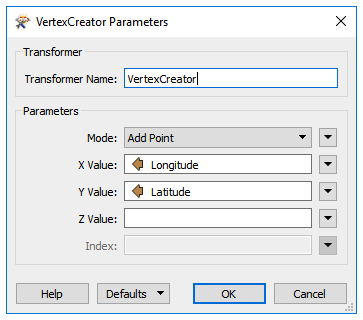

Connect a VertexCreator transformer to the Reader. This will create points with our Latitude and Longitude attributes. For mode, ensure that "Add Point" is selected and then change your X Value to read the Longitude attribute and your Y Value to read the Latitude attribute, then click ok.
Add a VertexCreator and set the X and Y Value

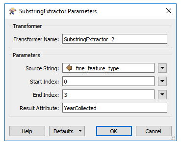

Place a SubstringExtractor between the AttributeManager and the writer feature type. Set it up to extract the first 4 characters of the fme_feature_type attribute, which is in effect the year. Store the year value in a new attribute called YearCollected.
The destination Tableau schema should be updated with the new attribute.
We only want the year from the fme_feature_type, set the Start Index to 0 and End to 3

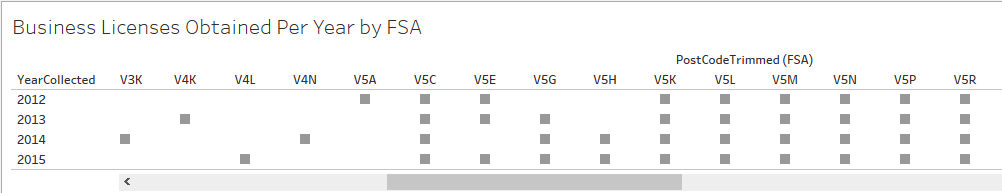

A single Tableau file is created, with a new attribute YearCollected. View this file in Tableau to ensure the YearCollected field is populated
View the BusinessLicenses.hyper in Tableau to ensure the YearCollected field is populated

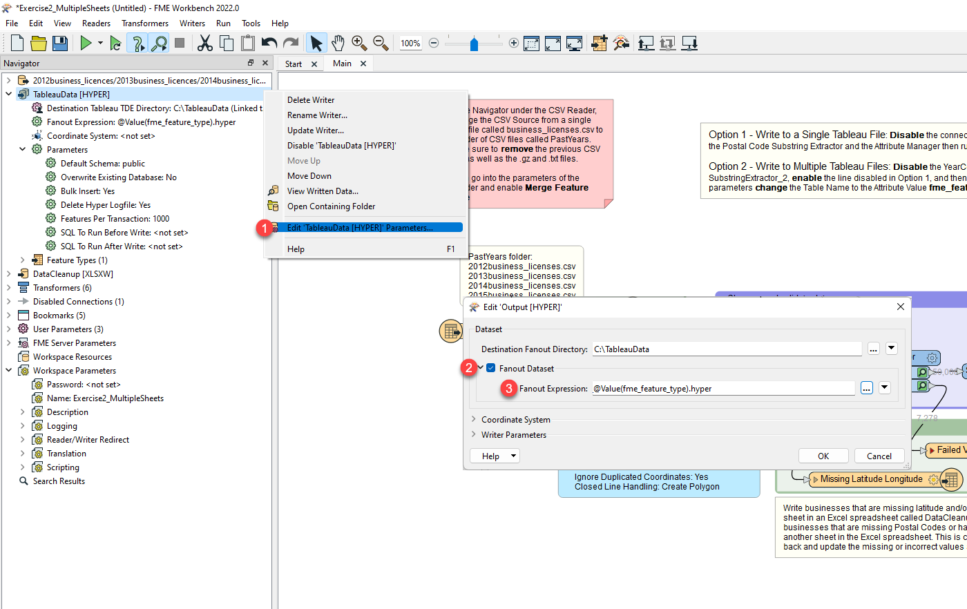

In the Navigator Window, right click on the .Hyper reader and choose Edit Parameters. In the writer parameters, enable the Fanout Dataset option and set the Fanout Expression to @Value(YearCollected)_@Value(fme_feature_type).hyper to create a new .hyper file for each year.
