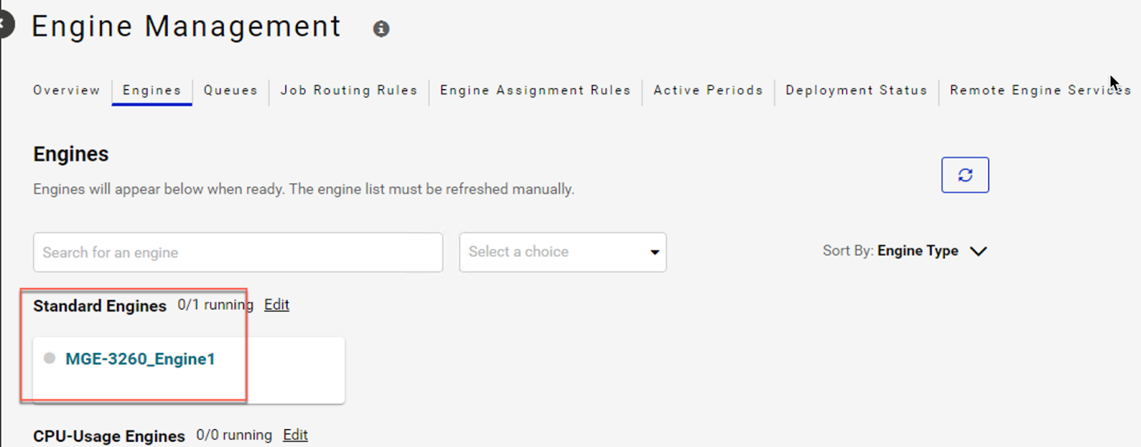

In this example, the engine will be assigned using the property type ”standard”. Currently, there is only one engine. But this is useful because if additional standard engines are added in the future, ​​the engine assignment rule doesn’t need to be updated.

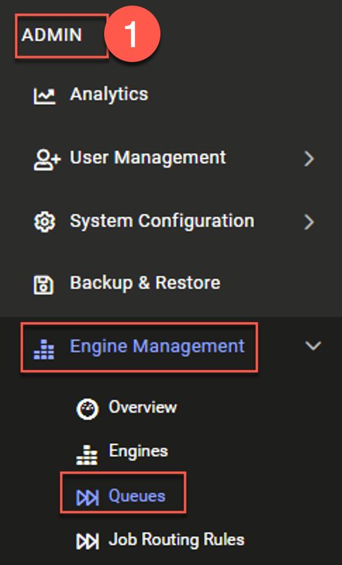

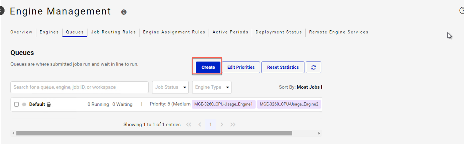

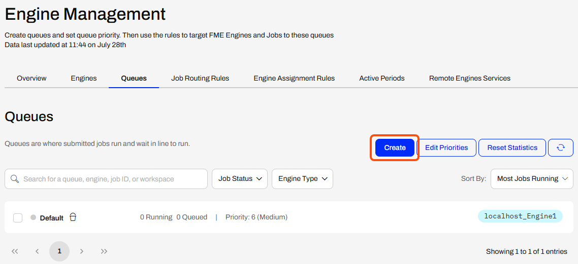

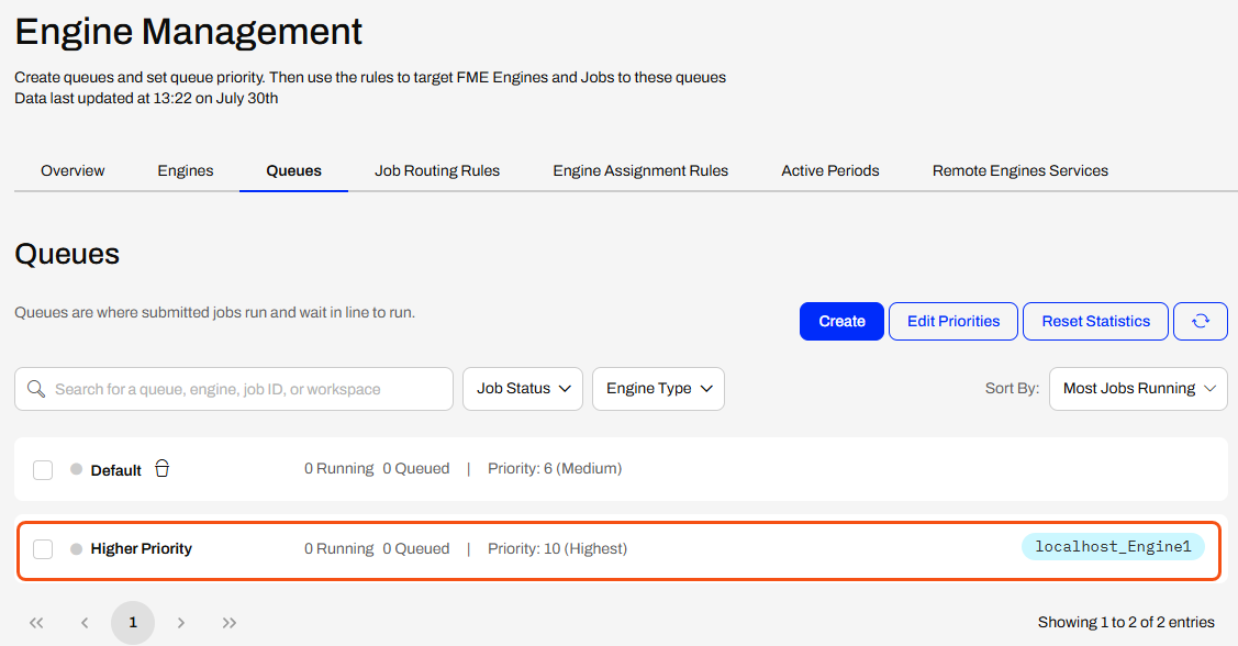

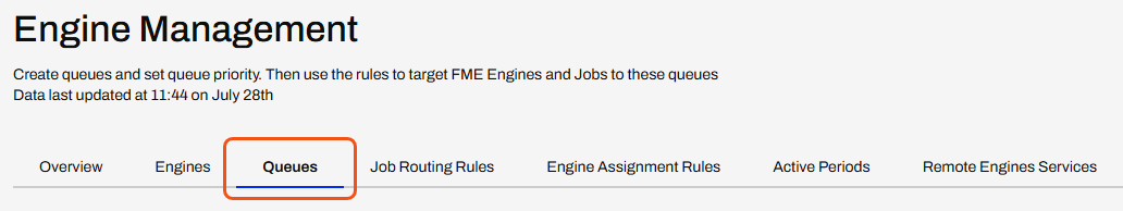

1. Navigate to “Engine Management” under the “Admin” section and select “Queues” on the FME Flow Web UI.

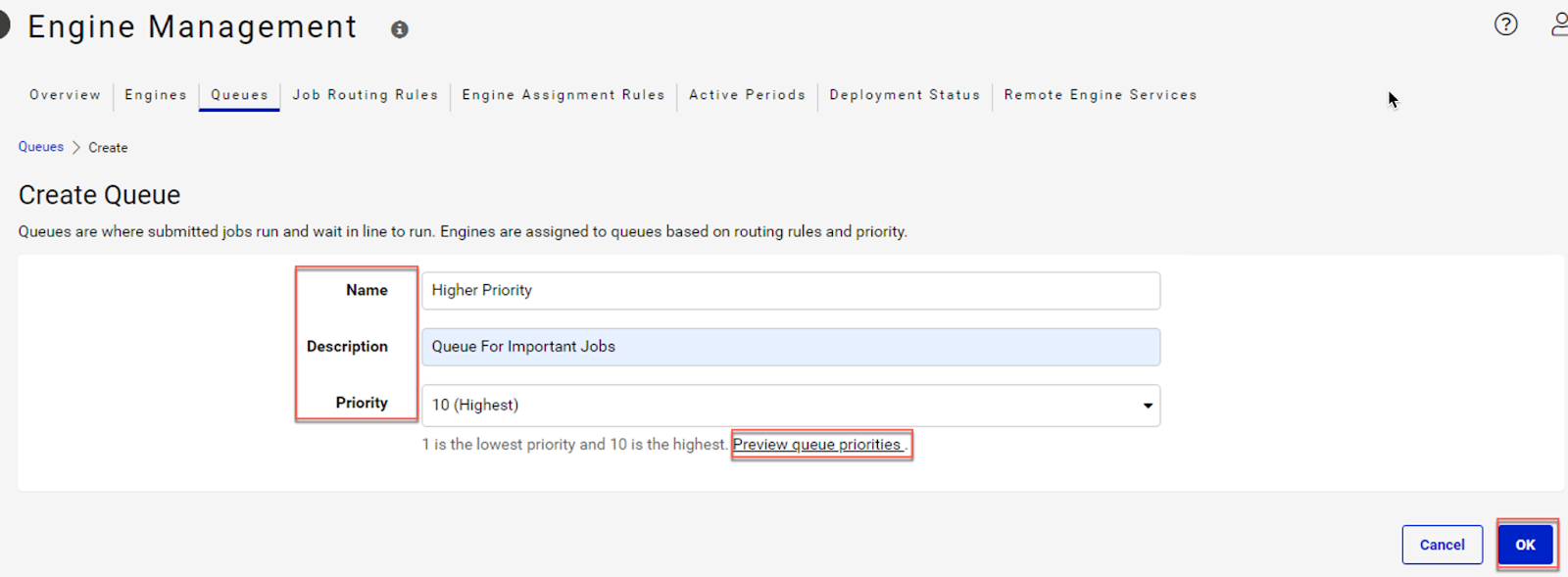

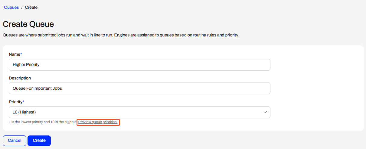

2. Click on “Create ” to create a new queue.

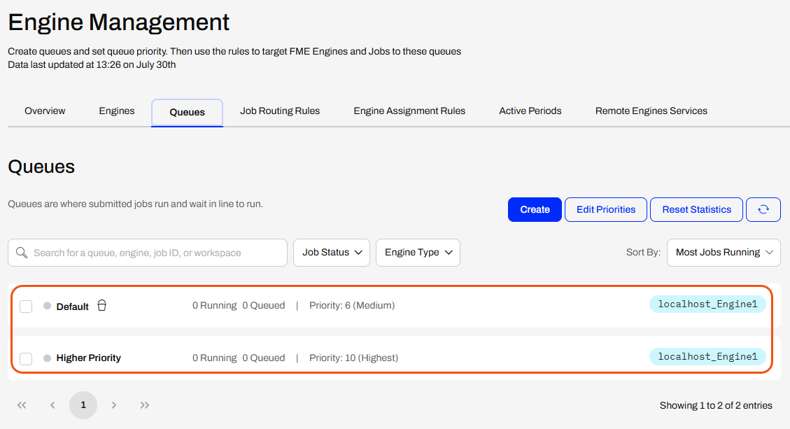

3. Fill in the appropriate queue name, description, and priority, and click OK. For this demo, the name is set to “Higher Priority” and priority set to 10 (Highest).
If no queues are set up on FME Flow, all jobs are routed to a Default queue with priority set to 5(Medium). By setting the new queue priority to 10, any jobs submitted to this queue will be run before those waiting in the Default queue. We can preview the priorities of other existing queues in the system by clicking “Preview queue priorities”

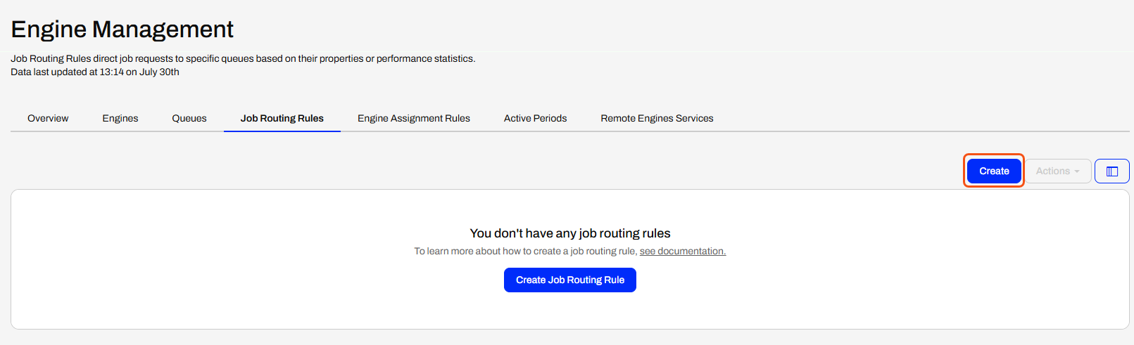

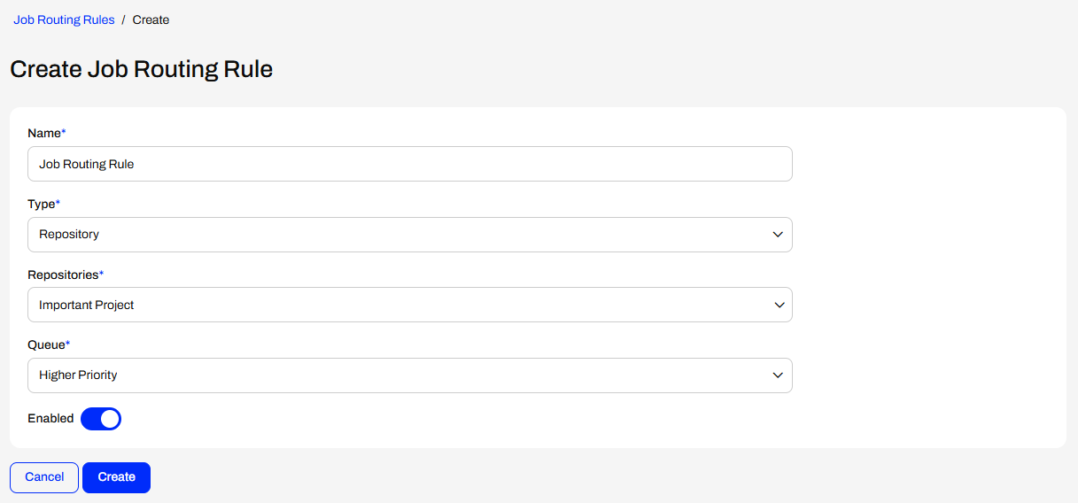

1. Navigate to “Engine Management” under the “Admin” section and select “Job Routing Rules” on the FME Flow Web UI.
2. Click on “Create” to create a new rule and configure all the parameters as follows, and then select OK:
  • Name: Important Job Routing
  • Type: Repository
  • Repositories: <RepositoryThatStoresHighPriorityJobs> (In this demo, it is “Important Project”)
  • Queue: <QueueCreatedInPart1> (In this demo, it is “Higher Priority”)
  • Enabled: On

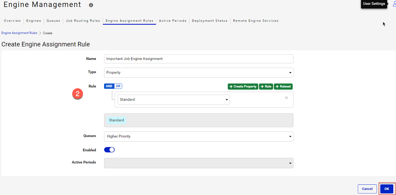

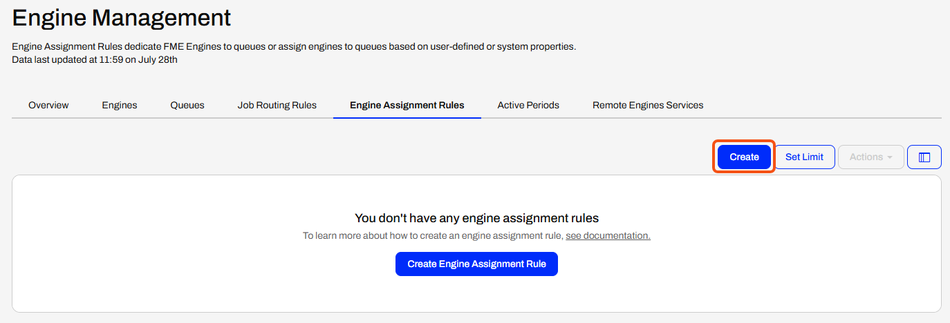

1. Navigate to “Engine Management” under the “Admin” section and select  “Engine Assignment Rules” on the FME Flow  Web UI and click "Create"
2. Configure all the parameters as follows and then select OK:
  • Name: Important Job Engine Assignment
  • Type: Property
  • Rule: Select “Standard” from the drop-down menu
  • Enabled: On
  • Active Periods: Leave this blank.
    • For more information on setting up an active period, please see this document. Once an active period is created, you can select the option in the drop-down menu. For this tutorial, we will skip this field.

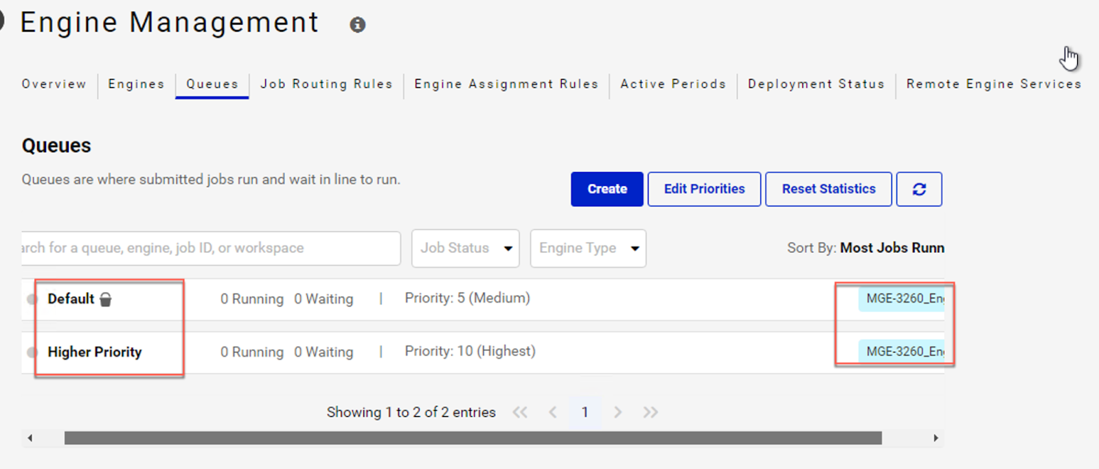

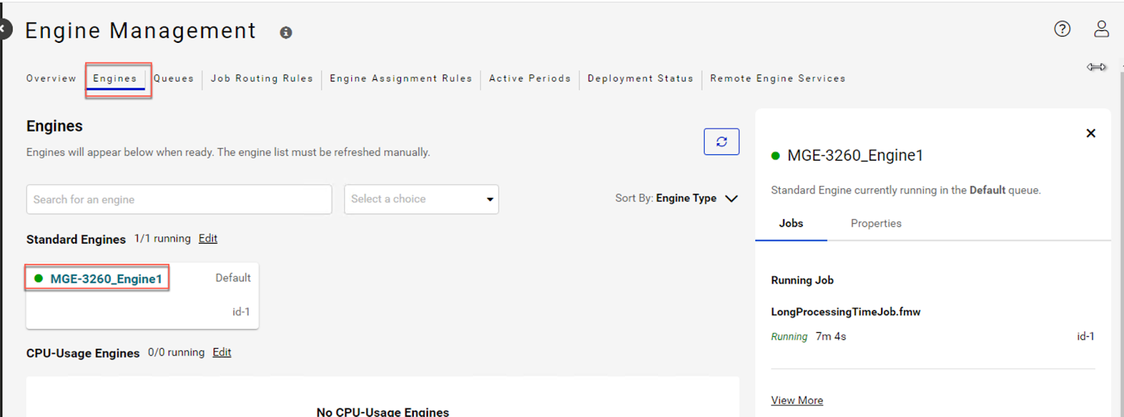

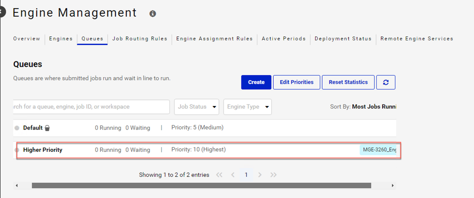

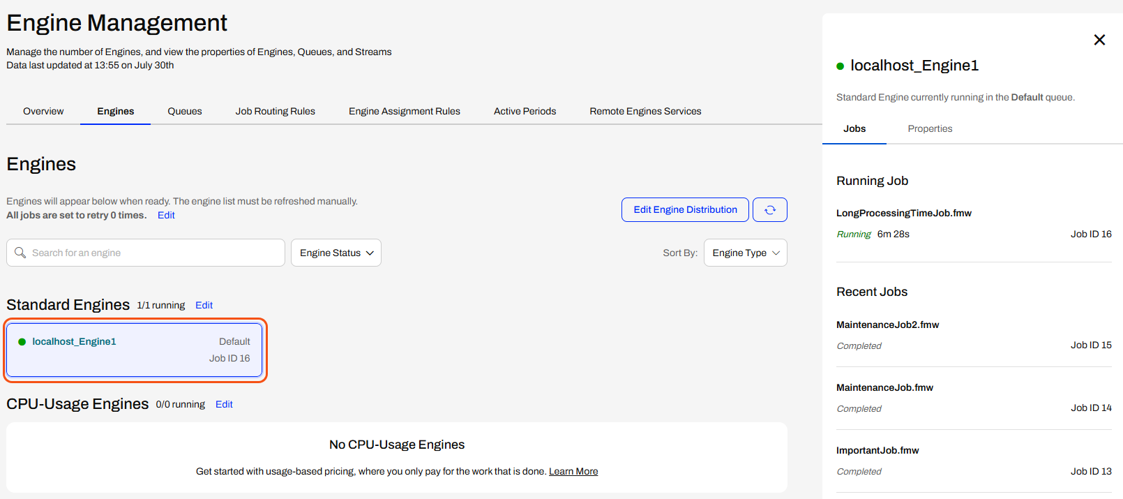

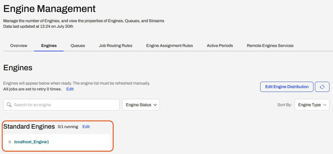

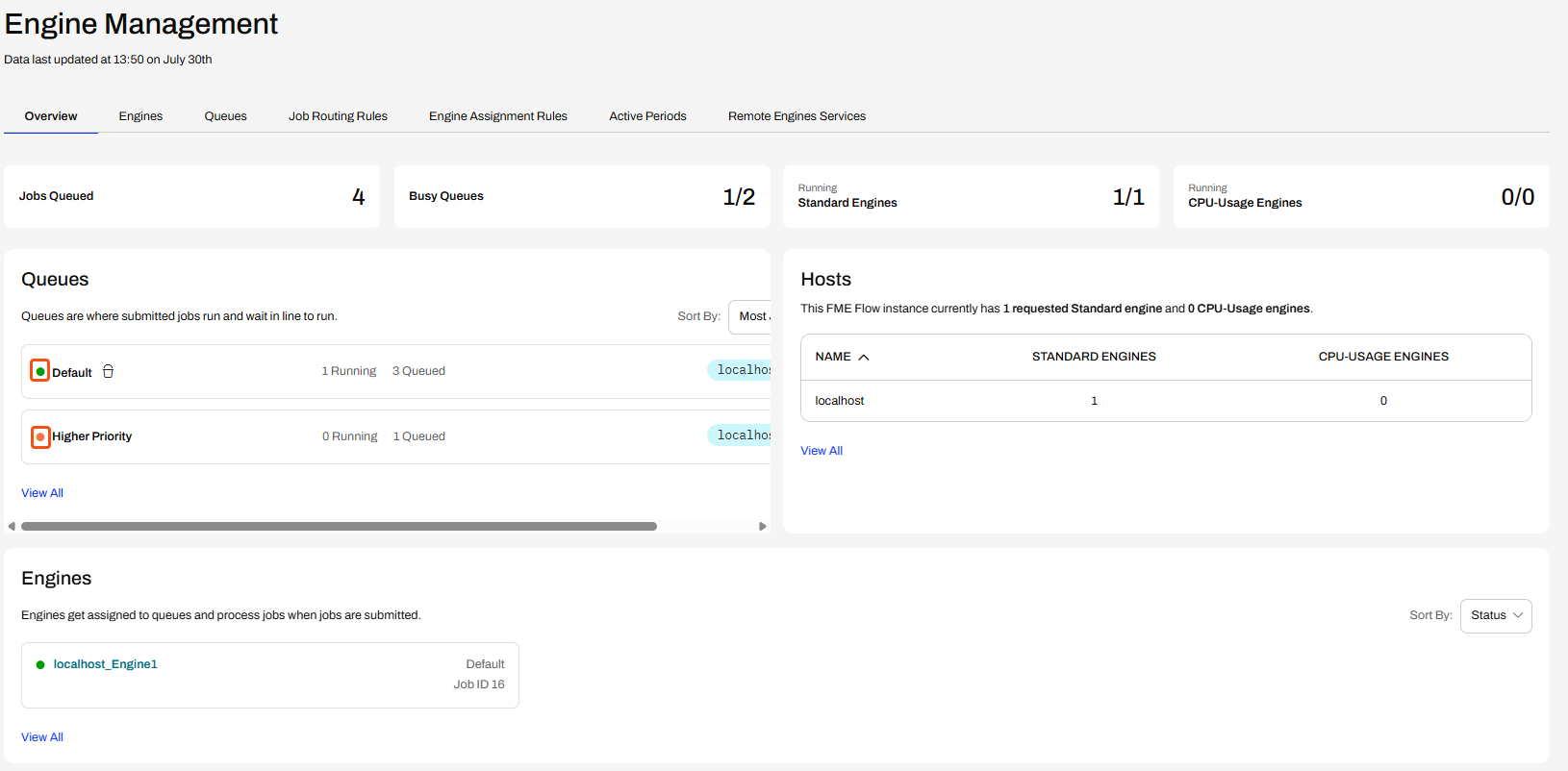

Once the Queue, Job, and Engine assignment rules have been set, navigate to the “Overview ” or “Queues” page to check the configuration. The “Higher Priority” queue is now assigned to the one and only engine on our FME Flow instance since it is a standard engine.
Note that the “Default” queue is no longer assigned to an engine. In this state, any job that is submitted to the “Default” queue will stay in the queued state and never run because there is no engine assigned to process those jobs.

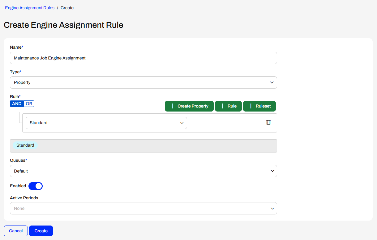

For this demo, all the jobs are to be processed by the same engine and the two queues are used to control the order in which they are run. To do this, create a new Engine Assignment Rule “Maintenance Job Engine Assignment”. Configure all the parameters as follows and then select OK:
  • Name: Maintenance Job Engine Assignment
  • Type: Property
  • Queue: <DefaultQueue>
    • In this demo, it is “Default”
  • Enabled: On
  • Active Periods: Not Applicable
Now, navigate to the “Overview” or “Queues” page to confirm that both queues are assigned to one engine.

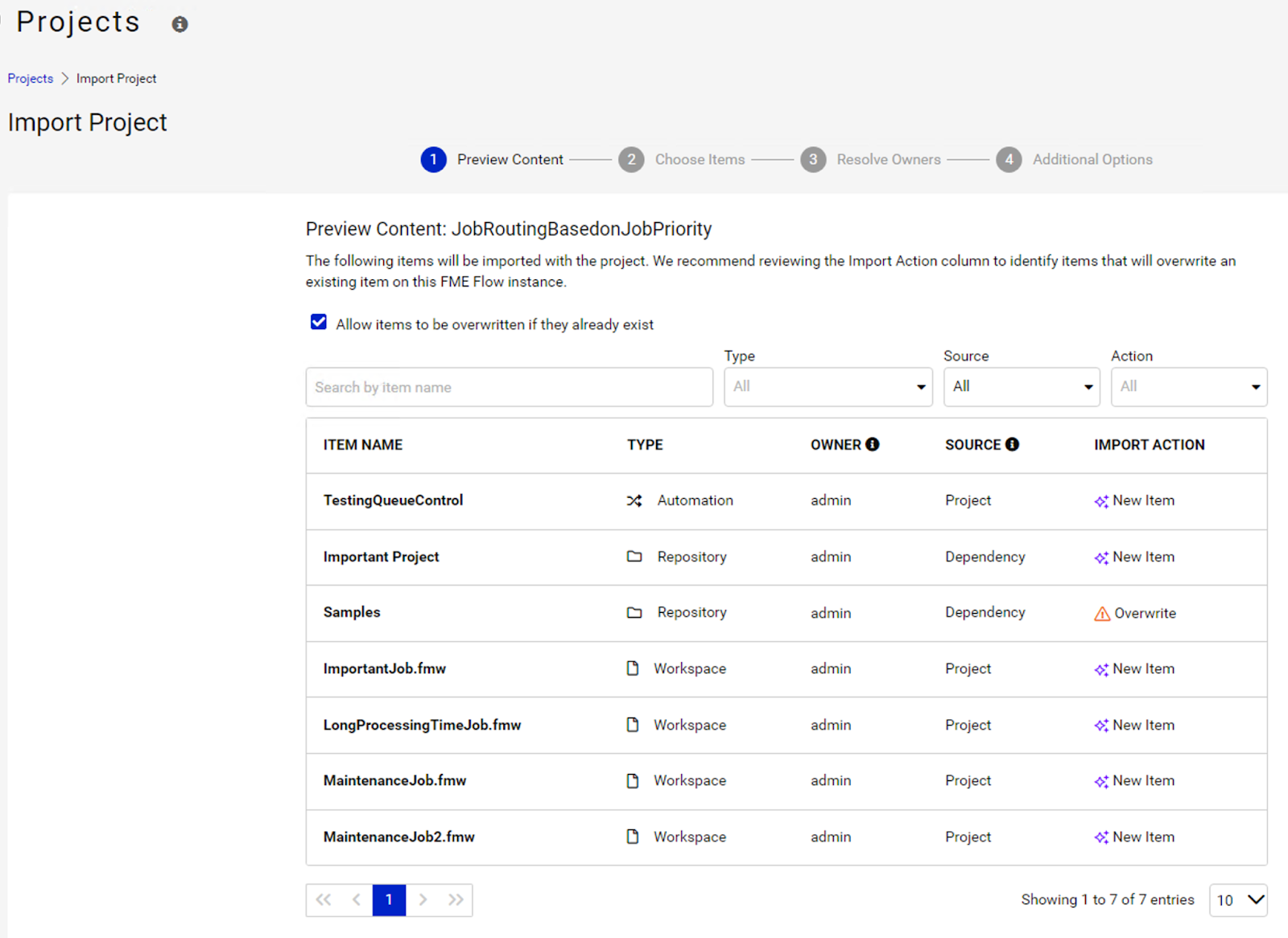

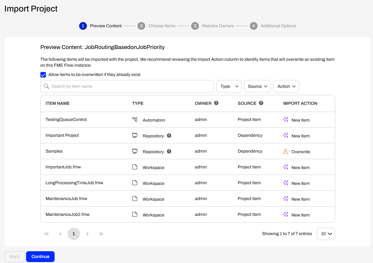

To test this configuration, if you have not already done so, please download the attached .fsproject and import it to FME Flow. To follow the remaining steps, you should make sure in Part 2 that |you setthe Job Routing Rule to the ‘Important Project’ Repository.
The project file “JobRoutingBasedonJobPriority” consists of the following components -
  • 1 workspace with a long processing time [LongProcessingTimeJob.fmw]
Queue configuration only applies to jobs that are waiting in the queue. Therefore, to test the setup, a workspace needs to be triggered that will occupy the engine, forcing both important and maintenance jobs to be ‘waiting’ in the queued state. This is accomplished by the workspace with a long processing time “LongProcessingTimeJob.fmw”.

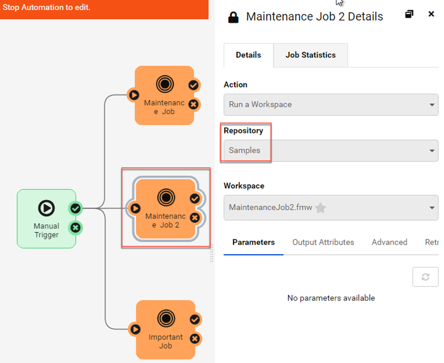

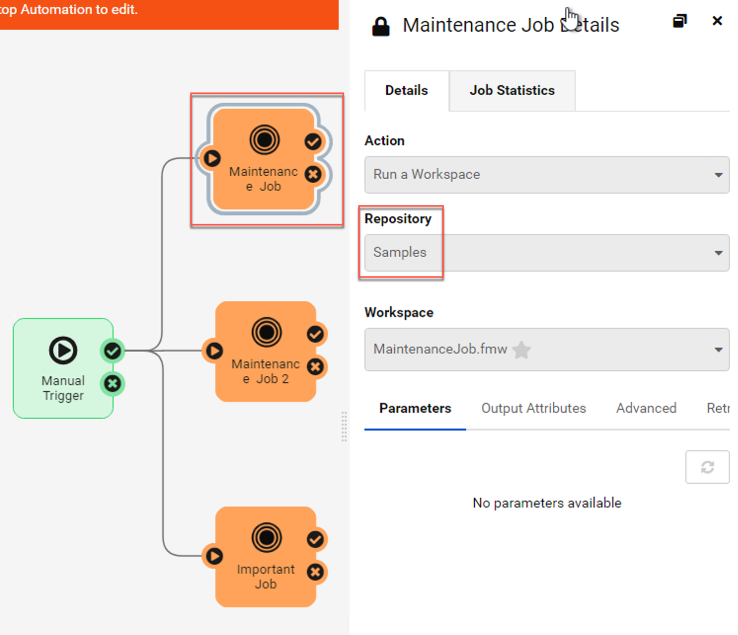

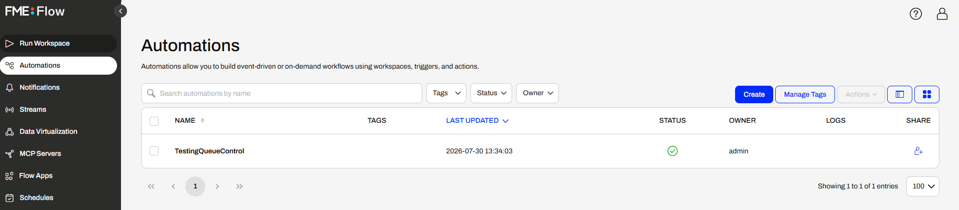

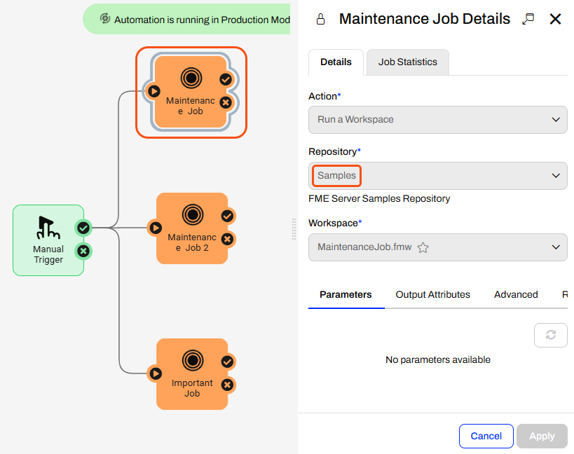

  • 1 manually triggered automation called ‘TestingQueueControl’. It consists of the following workspaces-
    • 2 maintenance jobs [MaintenanceJob.fmw and MaintenanceJob2.fmw]

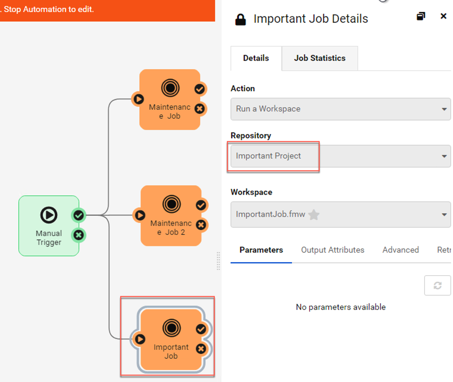

    • 1 important job [ImportantJob.fmw]

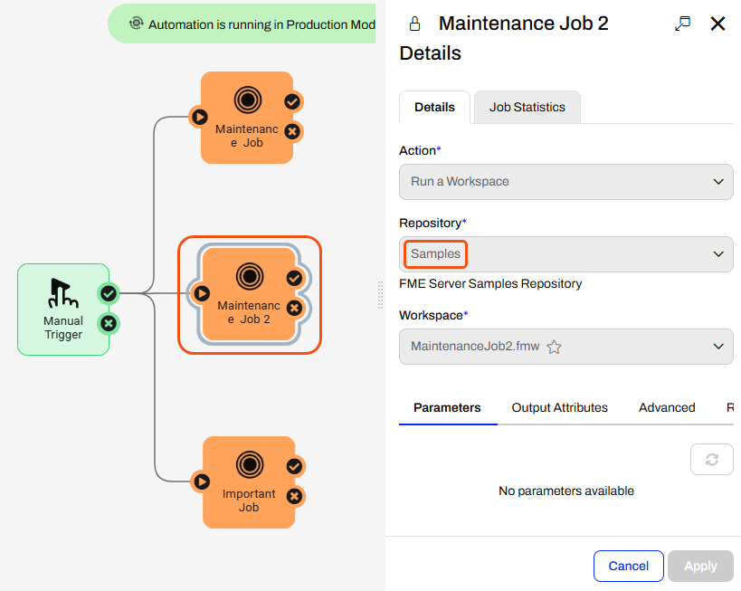

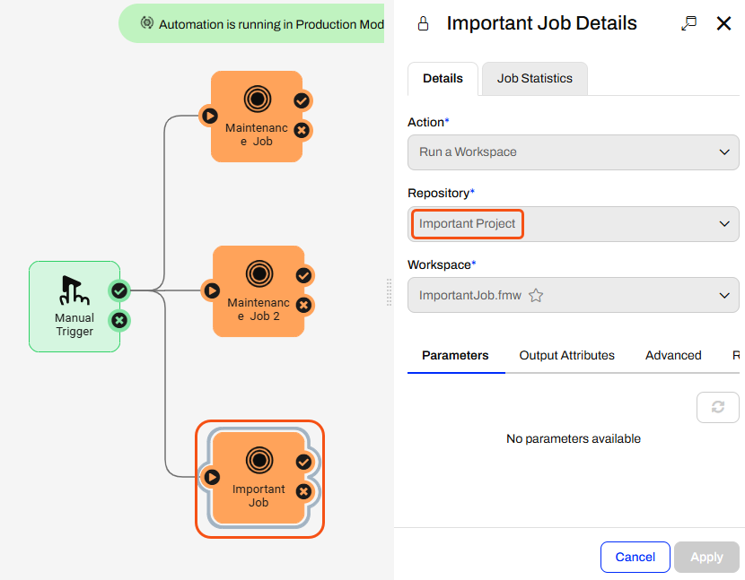

Note that the workspace “ImportantJob.fmw” is saved in the “Important Project” repository, which is linked to the “Higher Priority” queue. The other two workspaces are saved in the “Samples” repository and are linked to the “Default” queue [by default].

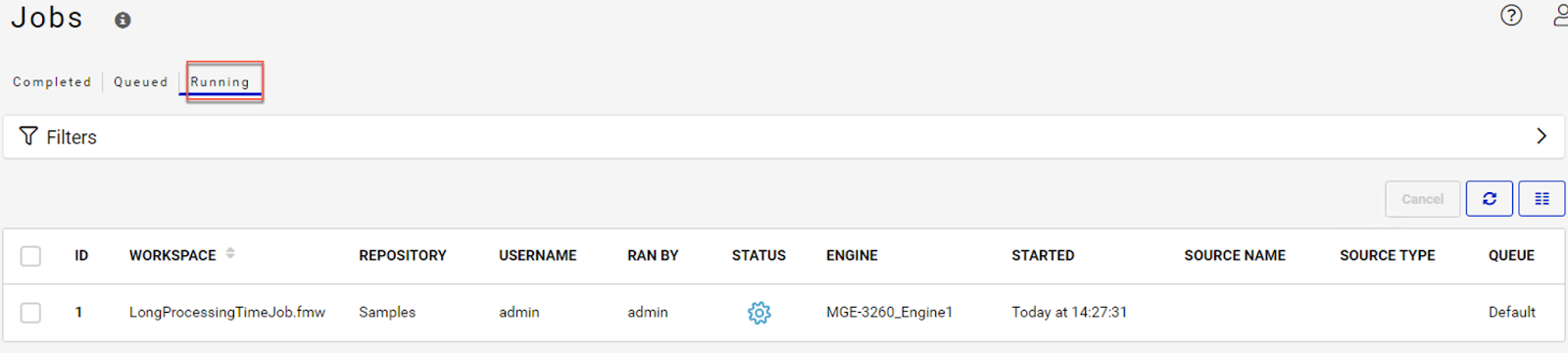

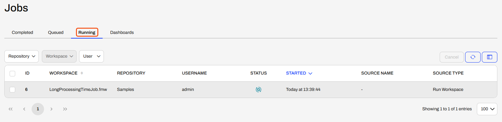

1. Run the workspace “LongProcessingTimeJob.fmw” on your FME Flow.
Note that the default value for “Delay Per Feature (Seconds)” is set at 120 secs. Please feel free to edit this field to increase or decrease the job processing time.

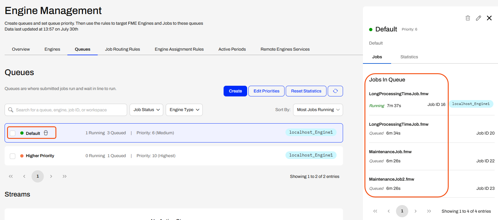

2. While the workspace “LongProcessingTimeJob.fmw” is still running-

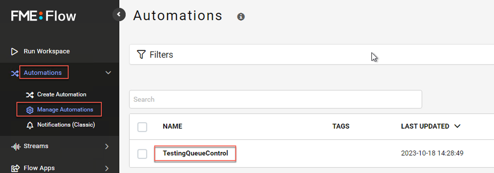

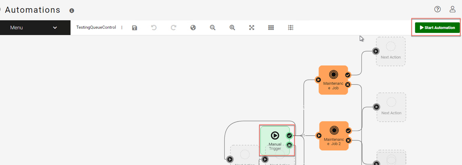

Navigate to “Automations” and select the “TestingQueueControl” automation.
3. Click on “Start Automation” and then click the “Manual Trigger” component and the Trigger button to run the automation.

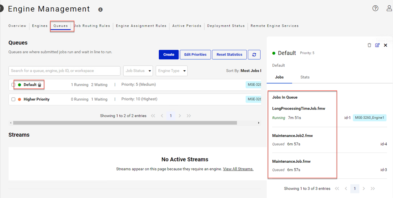

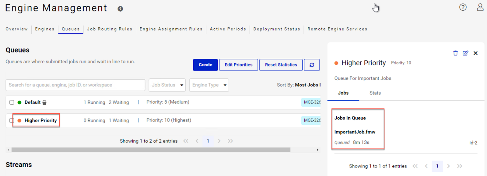

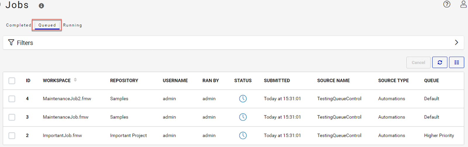

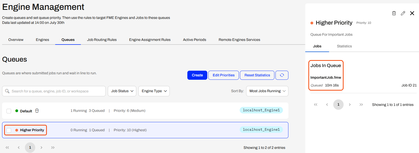

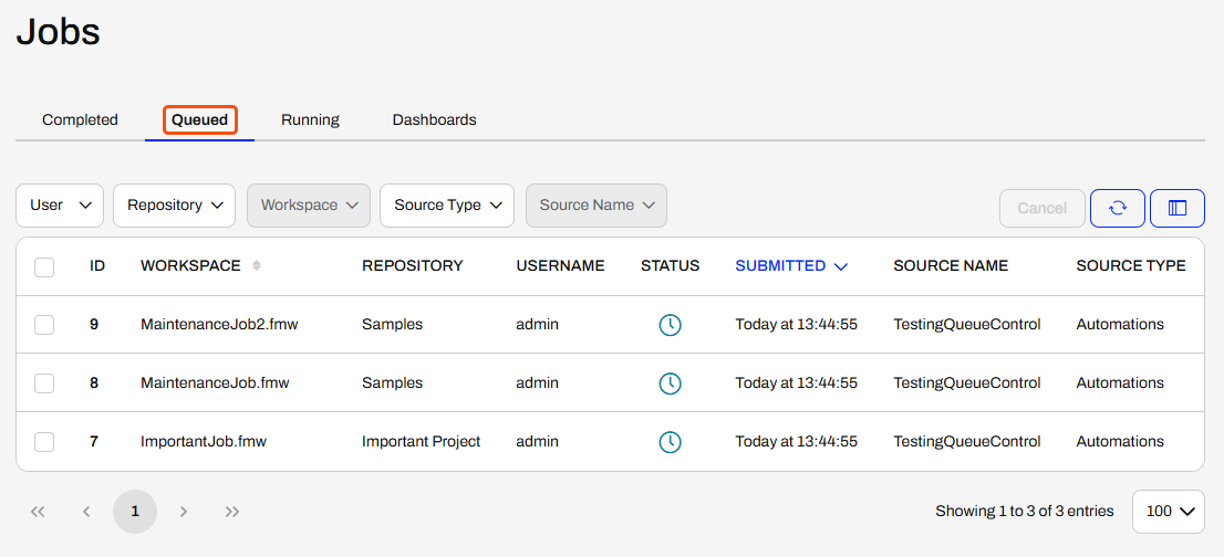

4. You will see the three included workspaces queued to be processed.

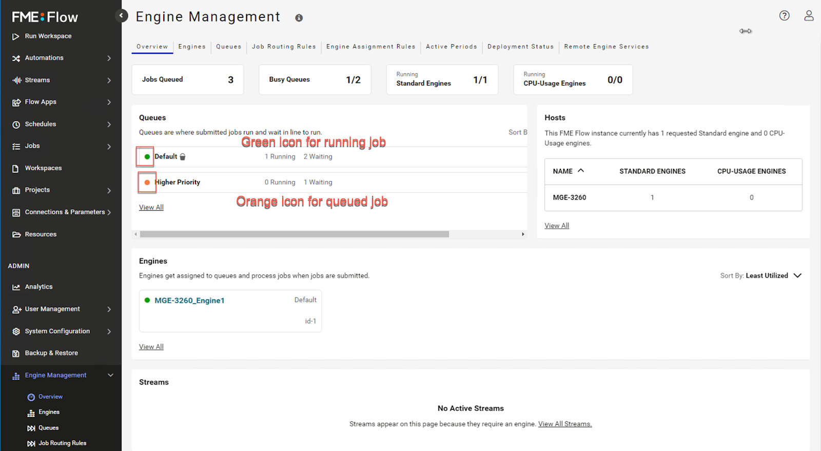

The “Overview”, “Engines”, and “Queues” pages would also show when engines and queues have jobs running and queued. A green icon indicates that a job is running. An orange icon indicates that a job is queued.
You can also see the most recently run jobs on a queue/engine or jobs currently running on the engines/queues.

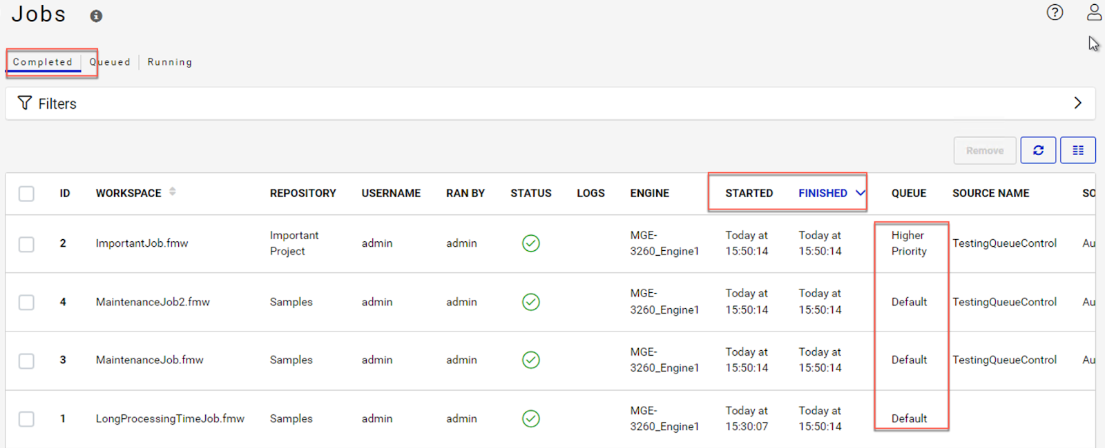

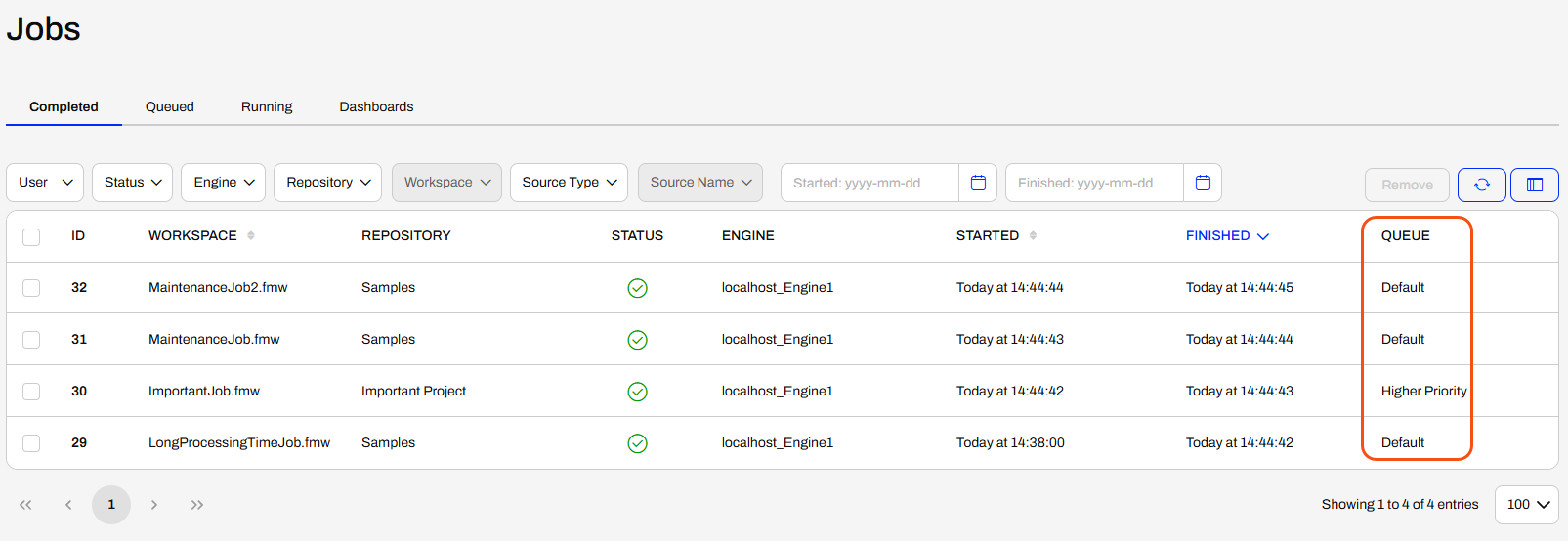

5. Without configuring the higher priority queue, the workspaces would be run in the order they were received. Instead, after the workspace “LongProcessingTimeJob.fmw” has finished processing, go to the completed jobs page to confirm that the higher priority workspace was processed first.
