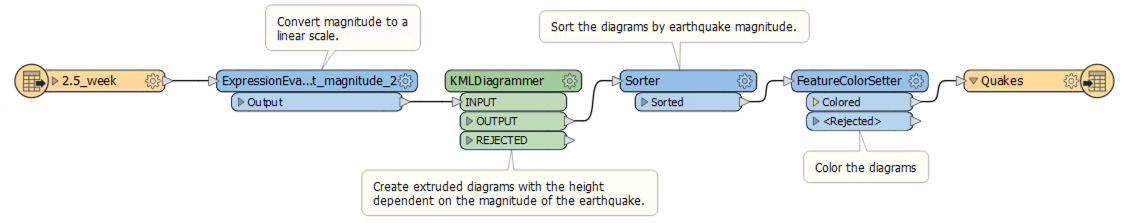

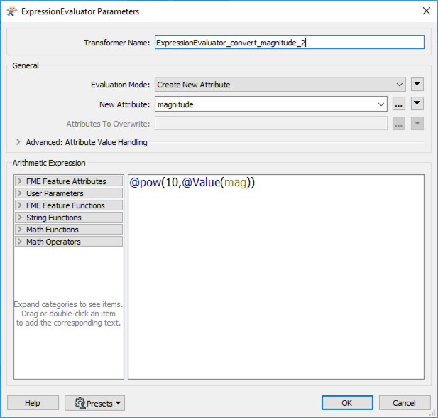

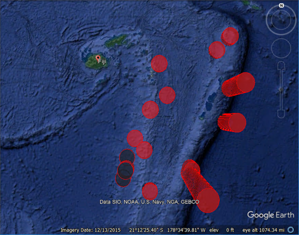

The workspace is fairly straightforward: it reads a GeoJSON feed from USGS, then, based on the magnitude listed in the JSON, raises it to the power of 10 to exaggerate the data.

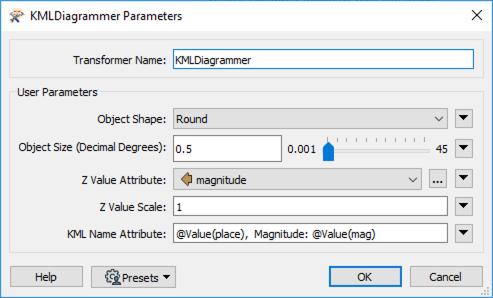

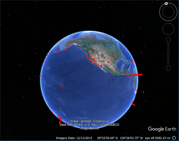

Next, the workspace uses the KMLDiagrammer custom transformer, available for download from the FME Hub. This transformer creates features that appear in 3D when opened in Google Earth.
Once the earthquake extrusions have been created, they are then sorted by magnitude and colored red. Finally, the data is written out to OGC/Google KML.

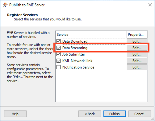

Data streaming setup begins in FME Workbench when the data is uploaded to FME Flow. When using the FME Flow Publishing Wizard, on the final page where you Register Services, be sure to enable Data Streaming. If you have more than one writer, click on Edit to confirm which writers you would like to use for the output.

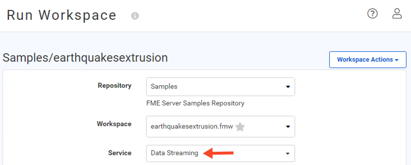

In FME Flow, navigate to the Run Workspace page, then select Samples as the Repository, earthquakesextrusion.fmw as the Workspace, then set the Service to Data Streaming.
If you clicked Run, the workspace would run, and quakes.kml would be downloaded to your computer. Instead, let’s build our URL to share with other users.
