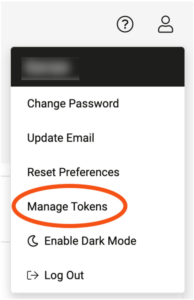

5. Configure the Flow App Permissions
FME Flow does not, by default, extend access to dependent web and database connections. Therefore, we must manually grant the app permission to use the Cityworks Web Connection.
Click on the Admin icon at the top right of the FME Flow web interface, and choose Manage Tokens from the dropdown.
From the list of API Tokens, find the token named after your new app.
Token Mgmt Page
When open, expand the Connections category. Find your Cityworks web connection and give the token Access. Click OK to finish.
