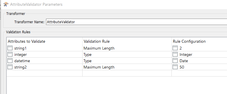

Step 2: Validate attributes to match the existing schema
For this step, we will use the  AttributeValidator transformer and configure the validation rules for each attribute based on the writer’s schema. Here is an example of what the AttributeValidator could be configured to:
Add a logger transformer to the “Failed” port to investigate the features that are failing. Example error messages from the sample workspace:
`_fme_validation_message' has value `Attribute 'string1' with value 'yes' fails check for Maximum Length = 2'
`_fme_validation_message_list{0}' has value `Attribute 'string1' with value 'yes' fails check for Maximum Length = 2'
`_fme_validation_message_list{1}' has value `Attribute 'integer' with value 'test' fails check for type is 'INT''
`_fme_validation_message_list{2}' has value `Attribute 'string2' with value 'This is test string with a total length of fiftyone' fails check for Maximum Length = 50'
