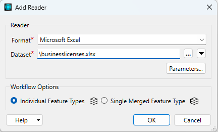

2. Add an Excel Reader
Add a reader for the source data. On the top menu, click Add Reader. In the Add Reader dialog:
  • Format: Microsoft Excel
  • Dataset: /businesslicenses.xlsx
    • Browse to downloaded dataset
Review the parameters in the dialog, then click OK to close it, and click OK again to add the reader to the canvas. The default parameter values are fine for this example.

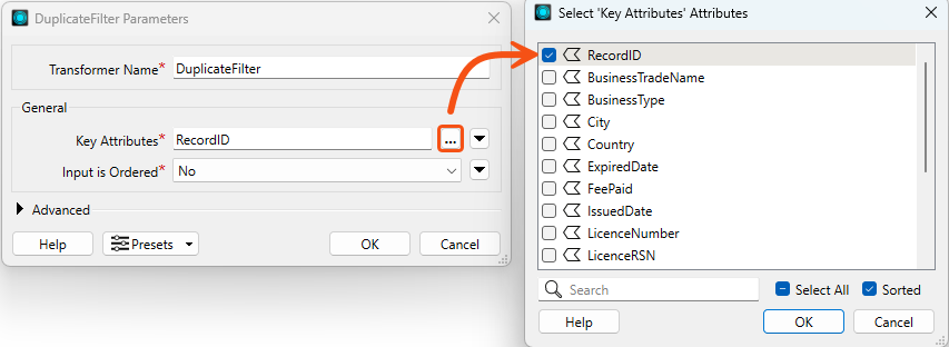

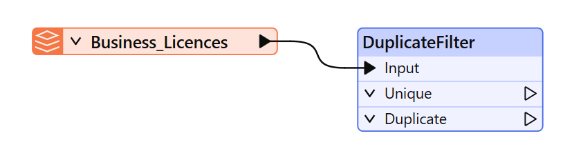

3. Add a DuplicateFilter Transformer to Check for Duplicate RecordID Values
Add a DuplicateFilter transformer to the canvas, connected to the reader feature type. In the parameters dialog, set the following:
  • Key Attributes: RecordID

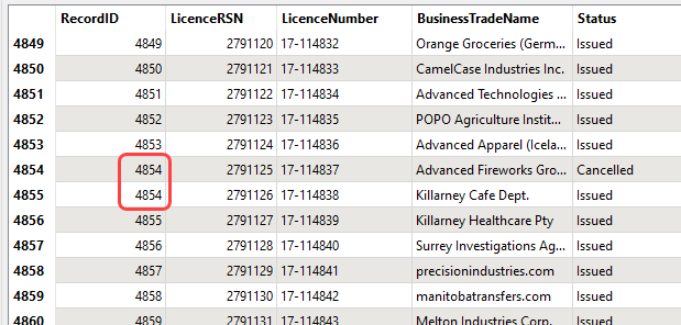

Enable Feature Caching and run the workspace. Once the run is complete, click the green magnifying glass icon on the Duplicate output port to open the data cache in Data Preview. One duplicate RecordID is found and output to the Duplicate output port. The RecordID number is 4854.

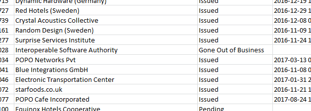

Only the duplicate record is displayed; the record it duplicates is not also flagged. In many cases, this is enough. However, to compare both records, open the full dataset:
When the "Advanced Fireworks Group" business license was canceled, it appears the "Killarney Cafe Dept." (the next license issued) was given the same record ID number in error.

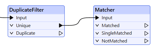

4. Add a Matcher Transformer to Check for Duplicate LicenseRSN Values

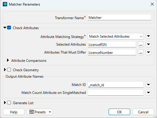

Duplicate values are not a problem unless the duplicates have a different value for LicenseNumber (LicenseRSN should have a 1:1 match with LicenseNumber). Add a Matcher transformer connected to the Unique output port of the DuplicateFilter.
  • Check Attributes: Enabled
    • Attribute Matching Strategy: Match Selected Attributes
    • Selected Attributes: LicenseRSN
    • Attributes That Must Differ: LicenseNumber
  • Check Geometry: Disabled

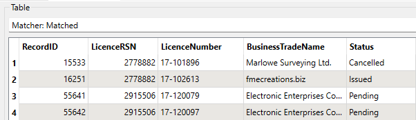

5. Inspect the Output from the Matcher
Run the workspace and inspect the Matched output port on the Matcher. Four records are identified as matching:
For "Electronic Enterprises Corp.," one of the LicenseNumbers contains a typo (120097 instead of 120079). The cause of the other duplicate is harder to determine.
This transformer returns both instances of the duplicate record, not just one. This comes with a performance cost, so it is not always the best solution.

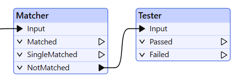

6. Add a Tester Transformer to Test for Issued Licenses
A final check is for a duplicate LicenseNumber with a different LicenseRSN. Because the LicenseNumber value can be reused, there may be many of these, but the duplication is only a problem when both licenses are active at the same time. Add a Tester transformer connected to the Matcher's NotMatched output port.

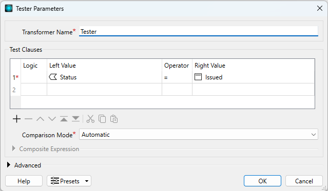

 In the parameters dialog, set the following and click OK:
  • Test Clauses:
    • Left Value: Status
    • Operator: =
    • Right Value: Issued

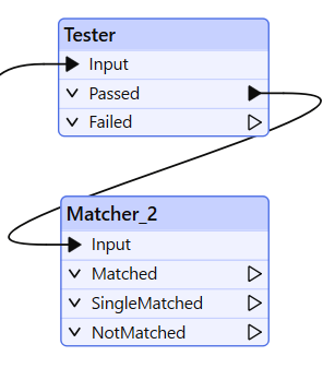

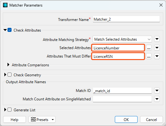

7. Add a Second Matcher Transformer
Add another Matcher transformer to the workspace, connected to the Tester's Passed port. Set up the parameters as before, except this time:
    • Selected Attributes: LicenseNumber
    • Attributes That Must Differ: LicenseRSN

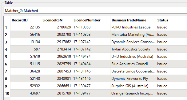

8. Run the Workspace and Inspect the Matcher's Matched Output Port
Run the workspace and inspect the Matched output port on the second Matcher transformer. Ten features exit through the Matched port:
These features have a duplicate LicenseNumber that does not match the same LicenseRSN number.

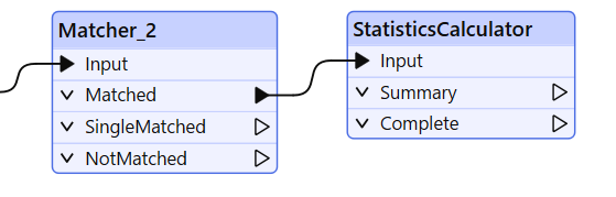

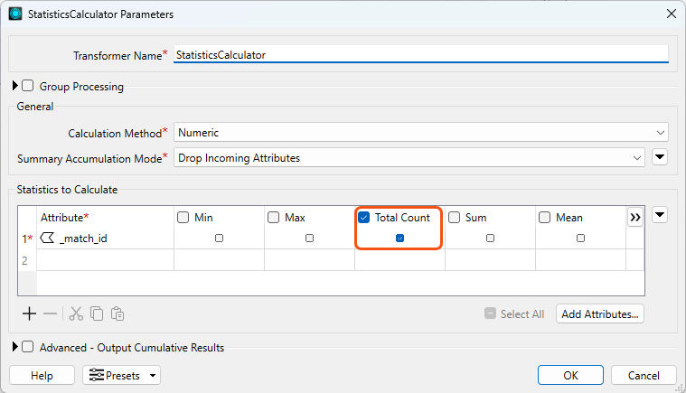

9. Add a StatisticsCalculator Transformer to Count Duplicate Features
To count duplicate features, add a StatisticsCalculator transformer connected to the second Matcher's Matched port. Set the transformer to analyze any attribute, and set the following:
  • Statistics to Calculate:
    • Attribute: _match_id
    • Total Count: Enabled
Click OK to close the transformer.

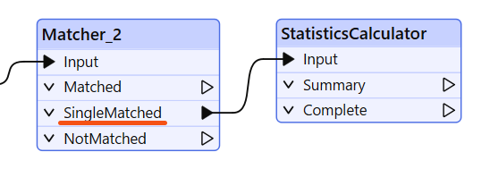

10. Count Matches as a Single Issue
The DuplicateFilter transformer filtered the duplicate RecordID features, so only one feature was flagged as a duplicate; the record it duplicates is not counted. The Matcher transformer returns two features for each match. To count each match as a single issue instead of two, switch the connection from the Matcher's Matched port to its SingleMatched port:
