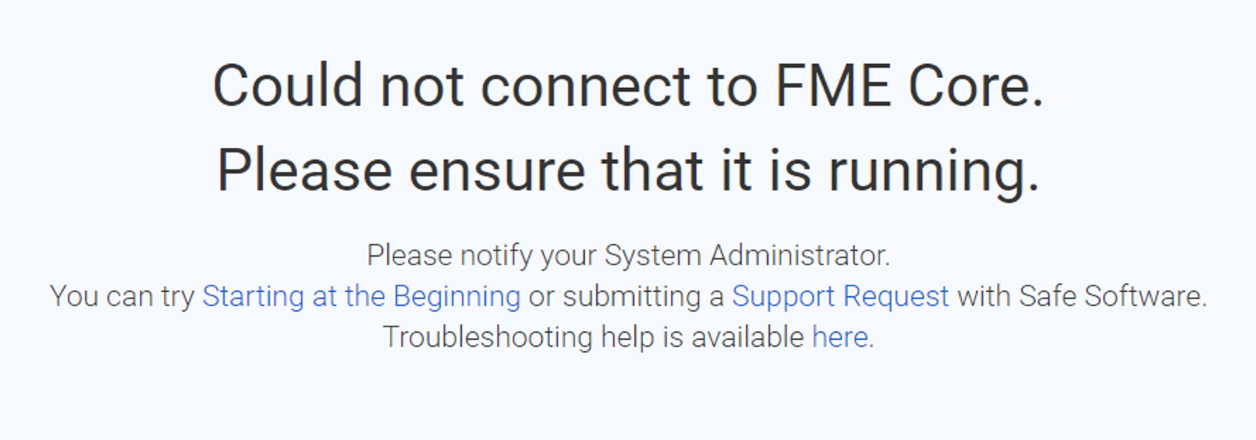

After performing an install of FME Server, when you try and log in the response is
Could not connect to FME Core.
Please ensure that it is running.
