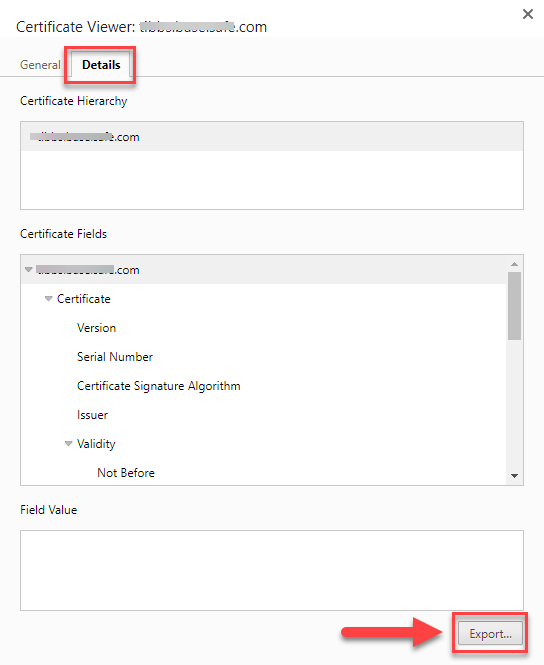

  • Click the Certificate Details tab and "Export"
Export Cert
