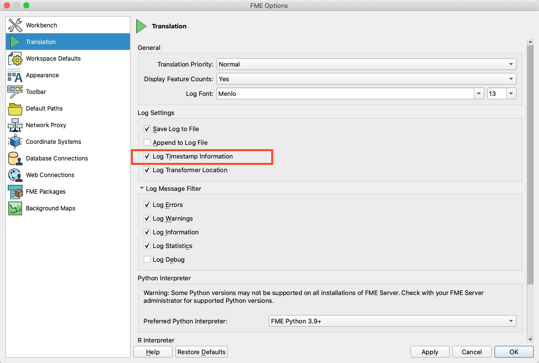

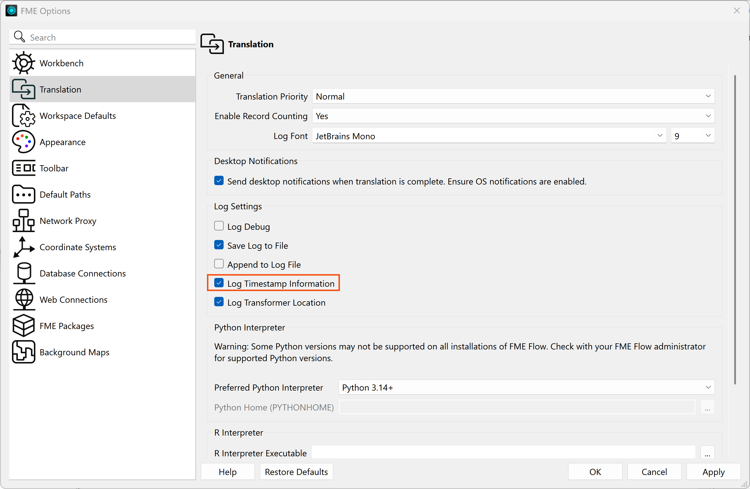

When trying to speed up a translation, it is always beneficial to check the log file timings to determine exactly where time is being spent. Timings are always written to the log file, but are optional in the log window.
Check that Utilities > FME Options > Translation > Log Settings > Log Timestamp Information is checked (this is in Tools for 2025.0 or older). This will cause timestamps to appear in the FME Workbench log window.
For more information on Translation settings and its parameters, see the Translation documentation.
