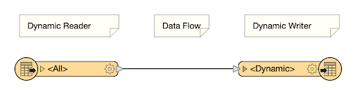

This is a dynamic workflow:
A dynamic workflow like this is NOT bound to a specific schema.
At the moment that you run the workspace:
  • The workspace can accept any input, regardless of schema.
  • The workspace accepts a new output schema from one of many different sources.
  • The writer schema source may be:
    • Any incoming dataset
    • Any external dataset
    • A lookup table
    • Defined within the workspace
In other words, the schemas do not need to be defined beforehand. They are fetched dynamically at run time.

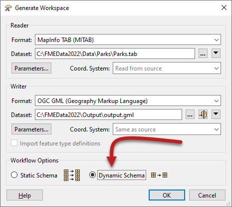

1. Generate Workspace
Start FME Workbench and choose File > Generate Workspace.
In the dialog that opens, set the following:
  • Reader:
    • Format: MapInfo TAB (MITAB)
    • Dataset: <path>\Parks.tab
      • Click on the ellipsis to navigate to the location of the file on your computer
  • Writer:
    • Format: OGC GML (Geography Markup Language)
    • Dataset: <path>\output.gml
  • Workflow Options:
    • Dynamic Schema: enabled
Click OK to generate the workspace.

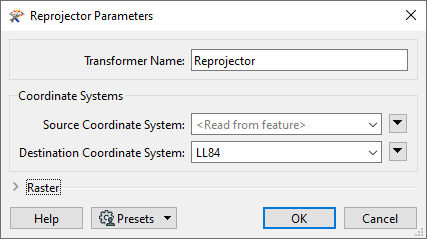

4. Reproject Data (Optional)
If you have time, add a Reprojector transformer into the workspace and connect it between the reader and writer feature types. Set it up to reproject the data from UTM83-10 to LL84; leave the Source Coordinate System set to <Read from Feature>.
This is an example of why you might want to use a dynamic workspace. Now we have a workspace that converts any MapInfo TAB dataset to GML, including a coordinate reprojection.
