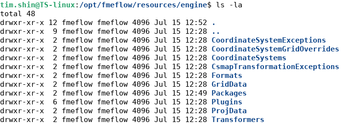

  5. If the steps above don't resolve the issue, you may need to check that the Packages folder has the correct permissions. In a Linux / container environment, change directories to opt/fmeflow/resources/engine and run ls -la and check that the Packages folder is owned by fmeflow:
    If that folder is owned by a different user to fmeflow (or root) you will need to do a chown so that fmeflow owns that folder (fmeflow uid and gui is 1363). Adding a -R flag will recursively change permissions of all of the files within that directory.
    chown fmeflow:fmeflow -R Packages
    ​​​​​​​chown 1363:1363 -R Packages
