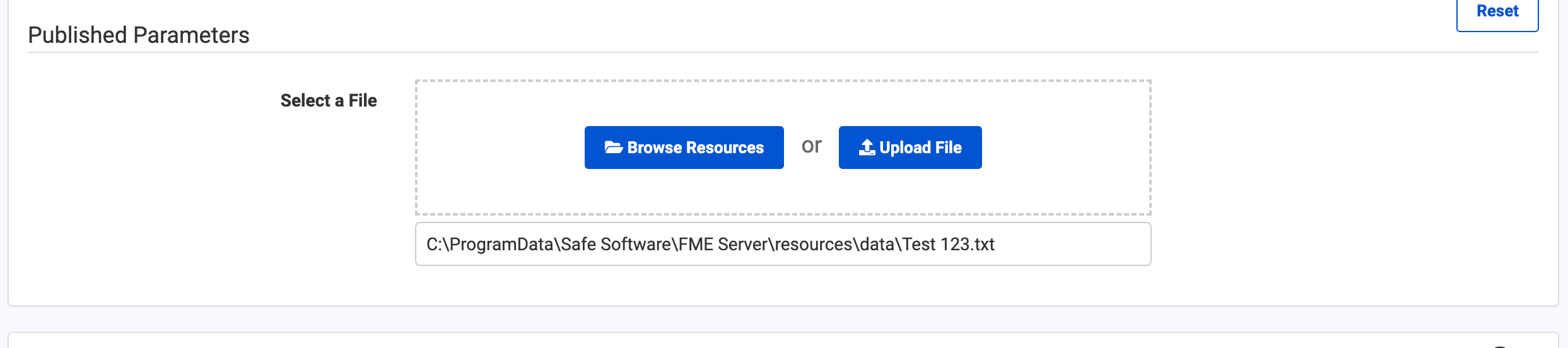

Workaround B: Avoid using the FME Server Parameters
Instead of changing the FME Server Parameter, you can remove them and set it to the File Path instead.

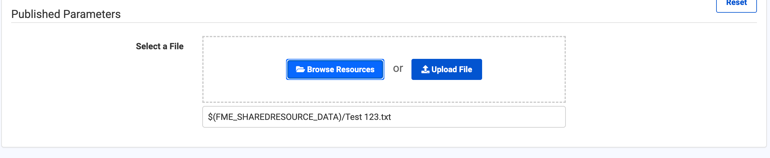

For example, if this is failing:
FME server parameter
Try this instead:
Please note that C:\ProgramData\Safe Software\FME Server\resources\data will be the default path for Windows. However, it may be different depending on the Shared Resources Folder specified during the installation of FME Server.
