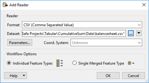

1. Add CSV
Open FME Workbench and add a CSV reader to a blank canvas. Browse to the BalanceSheet.csv file, which can be downloaded from the Files section of this article.

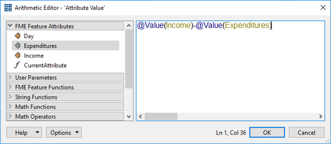

2. Create Net Attribute
Add an AttributeCreator to the canvas, and connect it to the CSV reader feature type. In the parameters, create a New Attribute called Net. Then, for the Attribute Value, click the drop-down and select Open Arithmetic Editor.
In the Arithmetic Editor, enter the following equation: @Value(Income)-@Value(Expenditures)
