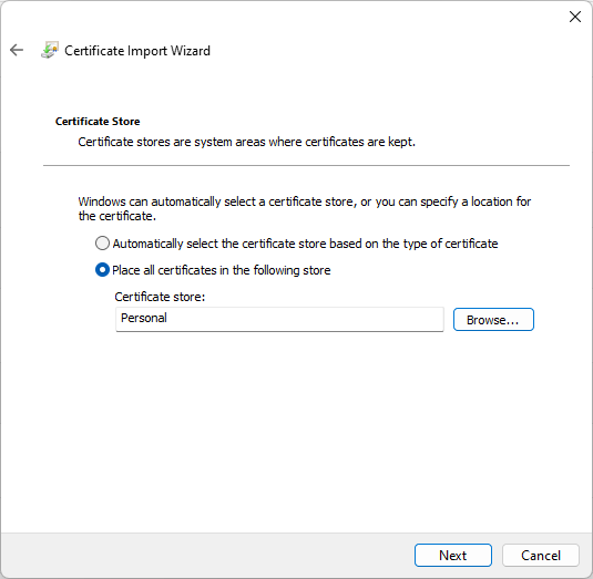

2. Since this is temporary, you can import them wherever is convenient. The Personal store is ok.
Personal Cert Store
