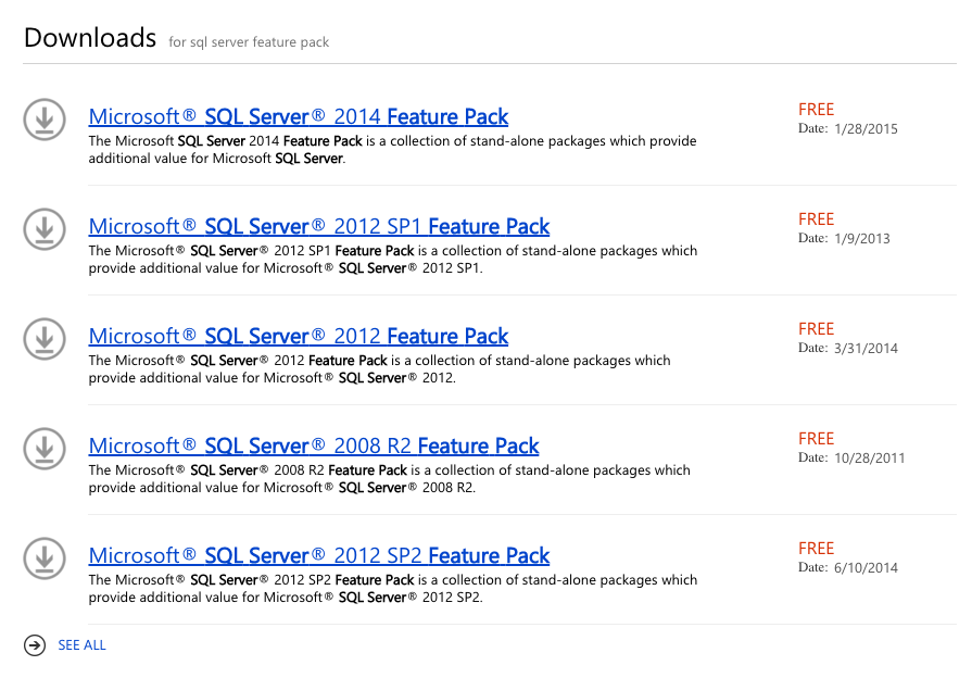

FME Desktop and FME Server should install the appropriate SQL Server Native Client. If a specific version of the SSNC is needed then this link https://www.microsoft.com/en-us/search/result.aspx... returns a list of SQL Server Feature Packs.screenshot-2015-11-09-114053.png
[At the time of creating this article the URL above returns the list of SQL Server Feature Packs in the image. Let us know via the comments if the URL stops working.]
Click the appropriate version and locate the Install Instructions button

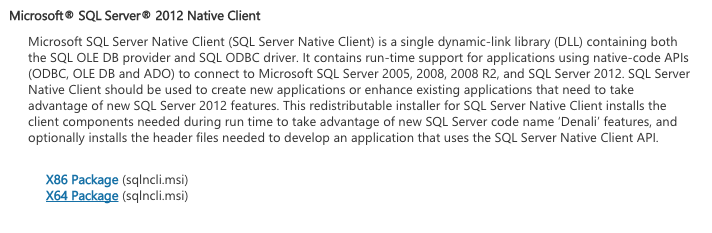

In the expanded list locate the SQL Server Native Client you wish to install. Consider the bit version of your FME software you are using and download that SQL Server Native Client software. Not all Clients have separate installers for 32bit and 64bit software.
Here is an example of the SQL Server 2012 Native Client information:
