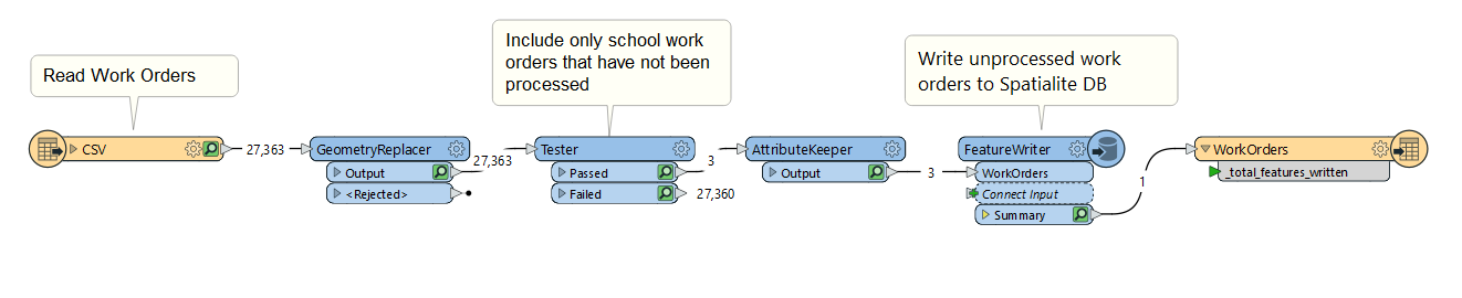

Let’s take a look at the workspace. It simply reads the CSV file of work orders (Traffic_Signal_Work_Orders.csv) and writes any that have not yet been processed to a SpatiaLite database using a FeatureWriter.
Workspace

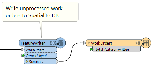

Open the FeatureWriter parameters. It outputs a feature through the Summary port that summarizes what was written, including a count of the total features written.
SummaryPort
2. Connect the FeatureWriter to an FME Flow Automations writer
The FeatureWriter’s Summary output port is connected to an FME Flow Automations writer. The summary feature with _total_features_written will be passed to an Automation that uses this workspace, so it can be used downstream.

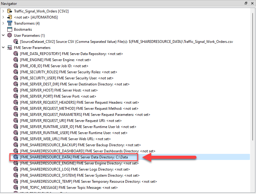

The FeatureWriter is already configured to create the SpatiaLite DB in the Data resource folder on FME Flow. To test the workspace before uploading it, set the FME_SHAREDRESOURCE_DATA parameter to a location on your local computer. Once published to FME Flow, the local folder set here will be ignored.
DataFolder

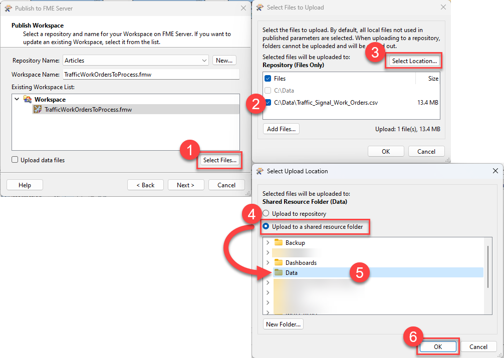

Upload the Traffic_Signal_Work_Orders.csv file to the Data Shared Resource folder on FME Flow. This is the location where the workspace is looking for the input file.
UploadCSV

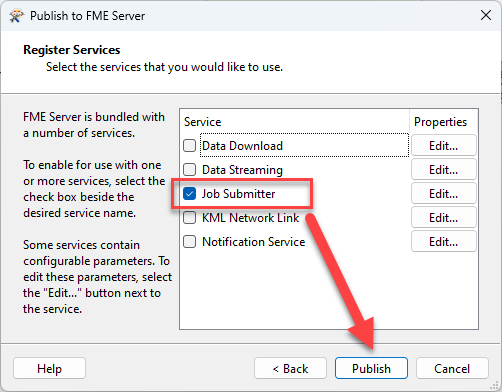

Leave the default Job Submitter Service checked and publish.
JobSubmitter

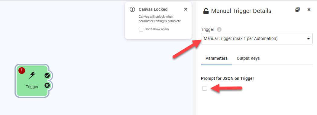

For demonstration purposes, we’ll use a manual trigger. In the Manual Trigger settings, disable Prompt for JSON on Trigger.
ManualTrigger

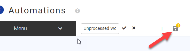

Save the Automation as Unprocessed Work Orders.
SaveAutomation

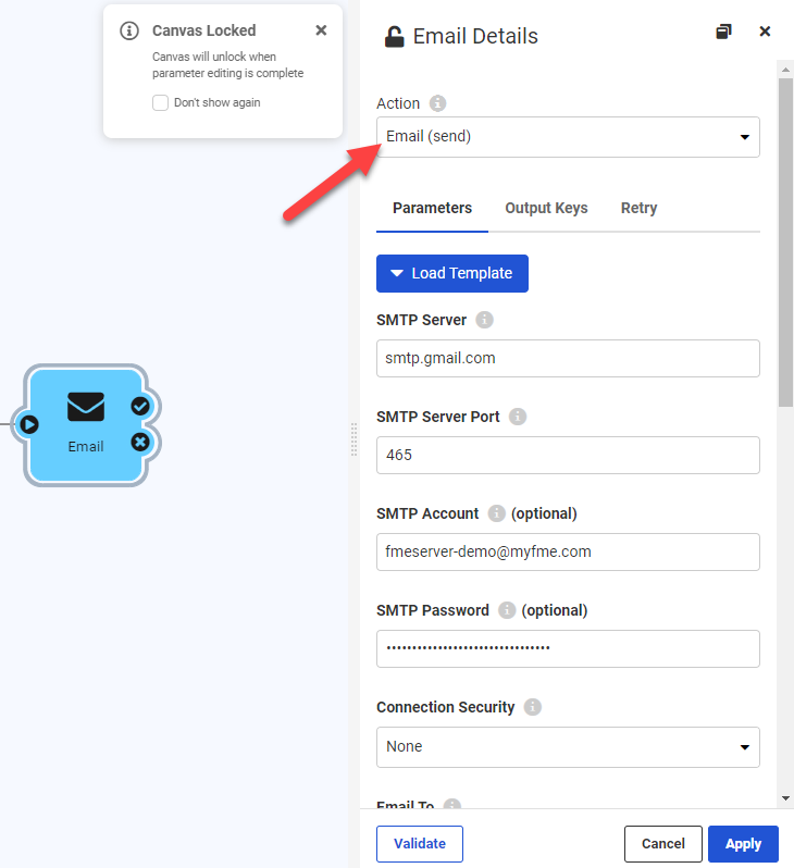

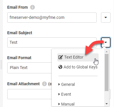

Add an External Action and choose Email (send) as the action. You can click Load Template to pick from popular services. In this case, the Gmail template was used. Enter the required Email action parameters up to the Email Subject.
EmailAction

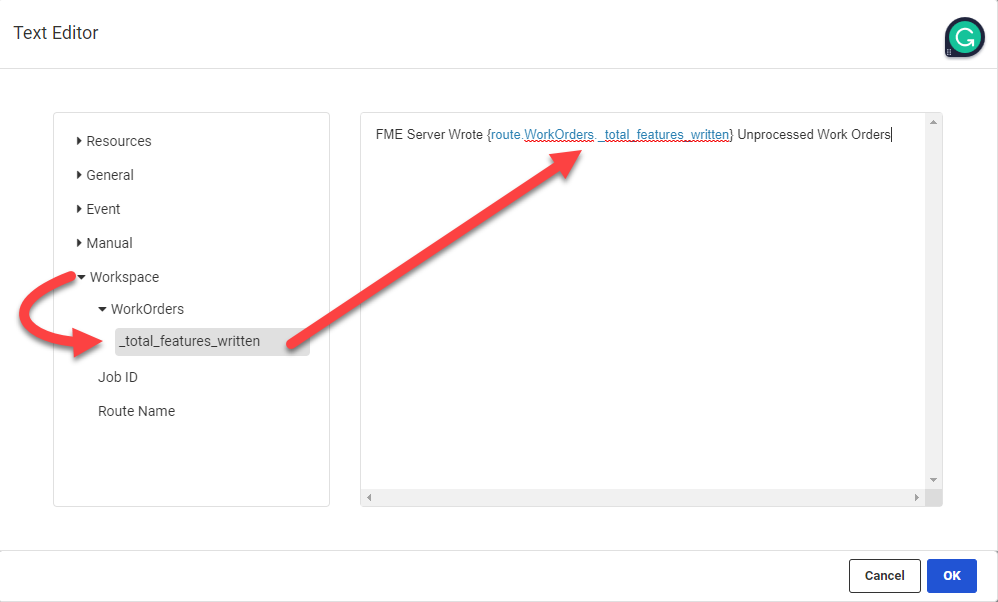

Let’s include the total features written in the Email Subject. Click the drop-down arrow and choose Text Editor.
TextEditor
Use the Text Editor to create a subject line that includes the _total_features_written attribute passed from the workspace. Click OK and Apply to save the Email Action. Save the Automation.
EditSubject

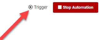

Click the Trigger button to trigger the Automation.
TriggerAutomation
You should see a message that the automation has been triggered.

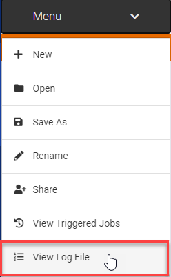

If you do not receive an email, check the Automation’s Log File for errors, like incorrect email account credentials.
LogFile
