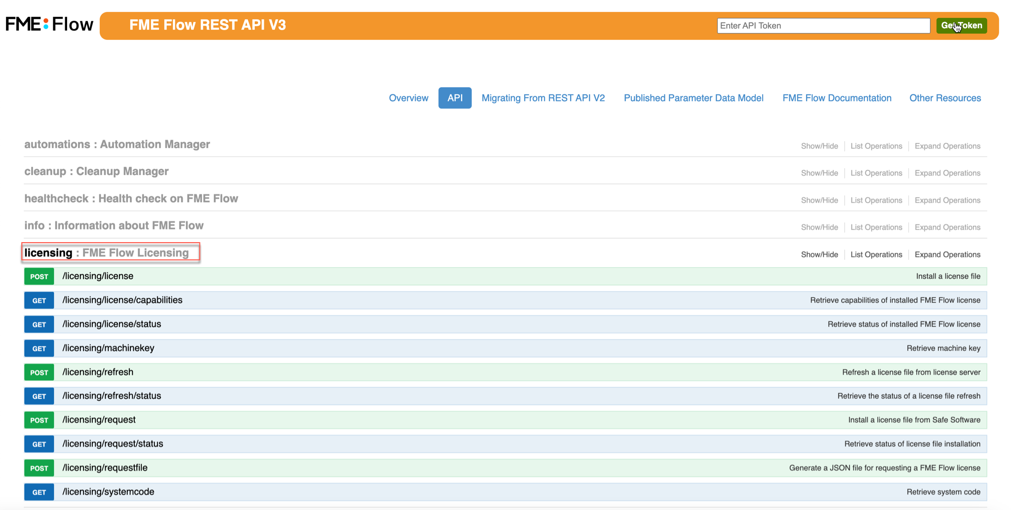

How can FME Flow Kubernetes deployments remain licensed if deployments are deleted and created?
FME Flow licensing mandates that the FME Flow System Share (resources) remain persistent to keep the software licensed. Should you fully dismantle the deployment, re-licensing will be necessary. For those looking to streamline this into an existing CI/CD workflow, licensing can be automated using the FME Flow REST API.
As of FME Flow 2025.1, the V3 REST API has been deprecated. The current API will remain accessible, but no new features or general bug fixes will be implemented. Starting with FME Flow 2026.1, the V3 API will be removed. We encourage all users to prepare their systems for this change.
The V4 REST API offers enhanced security and usability, including new and reorganized endpoints, as well as the removal of certain endpoints. For information on migrating from V3 to V4, please see the FME Flow REST API V4 documentation and click on the heading Migrating from REST API V4.
