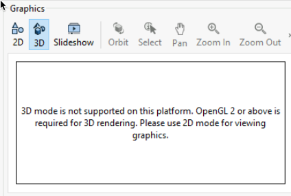

When running FME Form on a virtual machine (such as Amazon EC2), 3D data may not display in Data Preview or FME Data Inspector. This happens because 3D mode is disabled in environments that do not meet graphics requirements. This is not a defect in FME Form, but a limitation of the virtual environment. Note that this only applies to 3D data.
Why This Happens
An update to FME Form introduced updated libraries that require OpenGL 2.0 or higher for 3D rendering in Data Preview and FME Data Inspector. Many virtual machines do not support this requirement because of the following possible reasons:
  • Virtualized environments often lack GPU acceleration
  • OpenGL support is limited or not configurable
  • Standard VM configurations prioritize compute over graphics
As a result, 3D viewing is disabled even though the data itself is valid.
