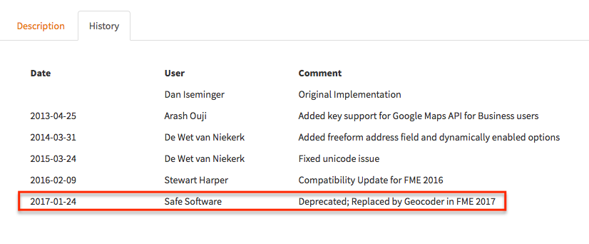

On the FME Hub page for the GoogleGeocoder, note that Version 5 was created with FME 2017.0 Build 17228. This indicates the build of FME when the transformer was deprecated.
Navigate to the History tab, here we can find valuable information about why the transformer was deprecated. In this example, we find that the GoogleGeocoder has been replaced by a new transformer for FME 2017.0, the Geocoder! It's always great when a custom transformer is promoted to our base product (often with more features).

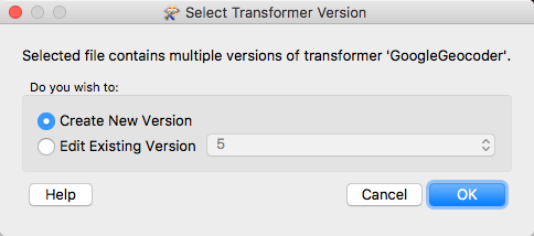

Step 2) Open the transformer with FME Workbench. You may be prompted to either "Create New Version" or "Edit Existing Version" - it is best practice to always create a new version.
IMPORTANT NOTE: Editing a custom transformer locally by modifying an existing version or creating a new version will only affect your local installations of FME. It is also recommended to only use deprecated transformers as 'Embedded' and not 'Linked'. (Linked transformers will try to communicate with FME Hub and download the latest version - there is a chance for conflict here!)
