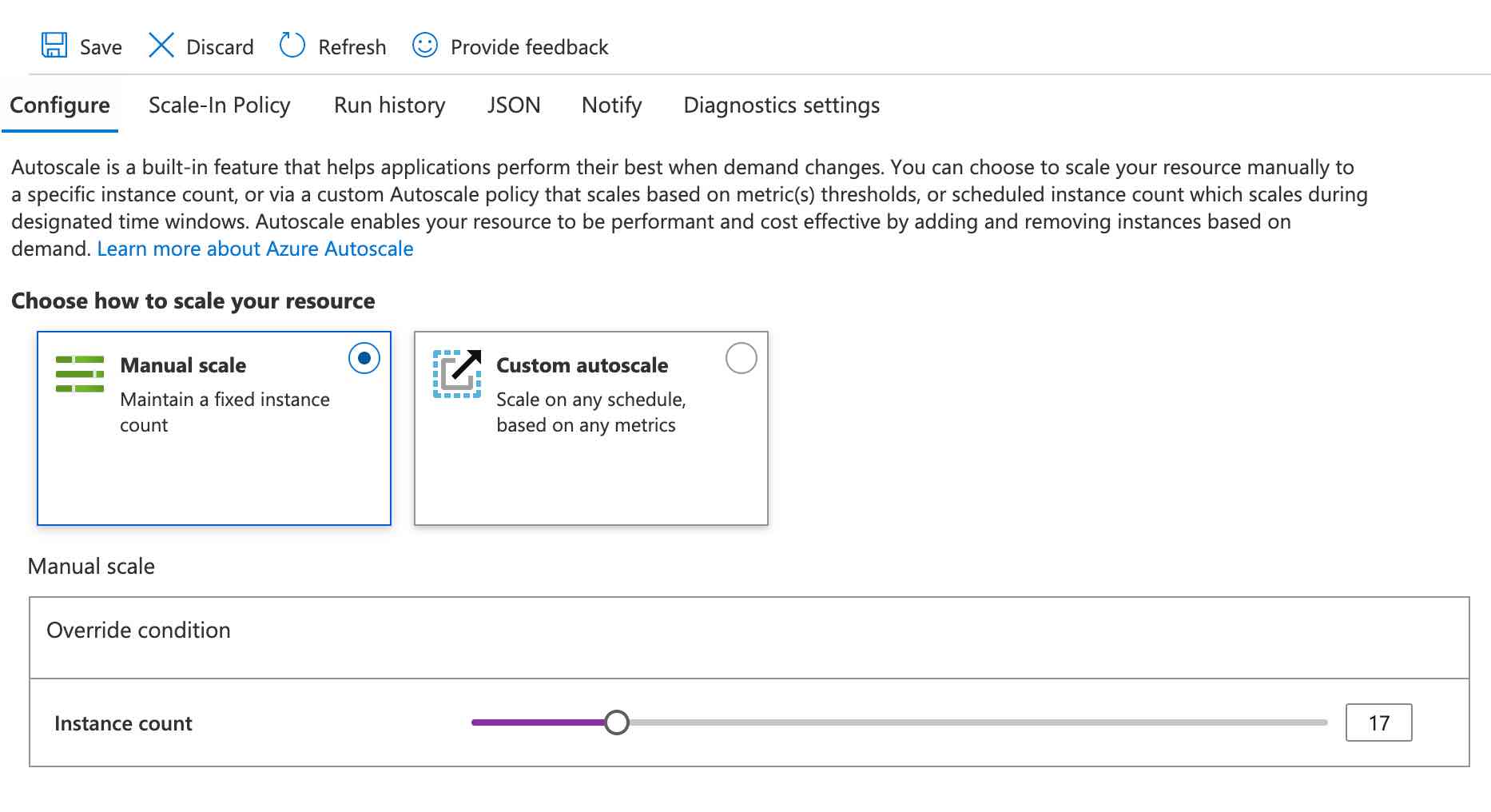

Manual Scaling
The simplest way is to manually scale the number of FME Engine hosts up or down:
  1. In the Azure portal, select the `fmeserver-engine` Virtual Machine scale set.
  2. Click Scaling under Settings.
  3. You can then scale the number of hosts up or down using the slider.

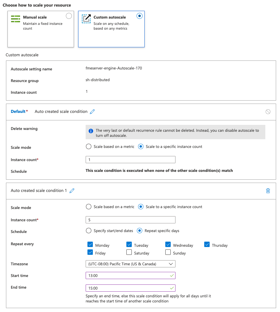

Scaling on a Schedule
These instructions are based on this document here and detail how to scale up and down the FME Engine hosts.
  3. Choose Custom autoscale.
  4. Set the Scale mode to Scale to a specific instance count.
  5. Set the Instance Count to scale to the desired number of instances when no scaling conditions are met.
  6. Add a scale condition and select Scale to a specific instance count
  7. You can then define your schedule.
In the example below, the scheduler will scale the number of FME Engine VMs from 1 to 5, Monday through Friday, during a two-hour period in the afternoon. Since each instance has two FME Engines installed, the capacity will increase from two FME Engines to ten FME Engines. Since the FME Engines are pre-configured, they will automatically connect to the Default queue and begin processing jobs.
