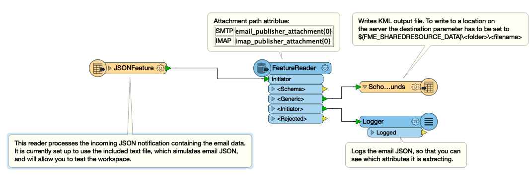

  1. Add a FeatureReader after the Reader, set the format to Esri Shape, and for the dataset use the email_publisher_attachment{0} or imap_publisher_attachment{0} attribute, respective of whether you used the SMTP or IMAP publisher.

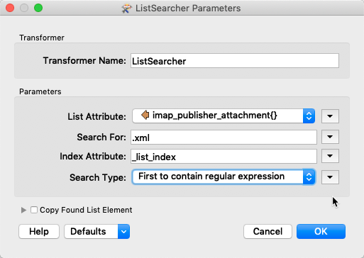

    Note: If the email body includes images these will also appear in the _publisher_attachment{} list so you may need to filter your result by type first. One way to do this could be to use a ListSearcher to find which element of the list contains the xml path.listsearcher.png
    Search for .xml in publisher_attachment list to identify correct list index to use if there is more than one
  2. To read all incoming feature types, simply leave the Feature Types to Read parameter under the Constraints section unset. It will display <All Feature Types>.
  3. At the bottom of the parameter editor under Output Ports change the selection to Single Output Port. Alternatively, leave it on the default setting to have each output feature type as a separate port, or if you are only interested in specific feature types, you can set them by manually entering a list or an attribute.
  4. Connect a KML Writer to the <Generic> port and set the destination path to a location on the server using the FME Server Parameters, i.e. $(FME_SHAREDRESOURCE_DATA)\<folder>\<filename>
Receive Email 3 final workspace

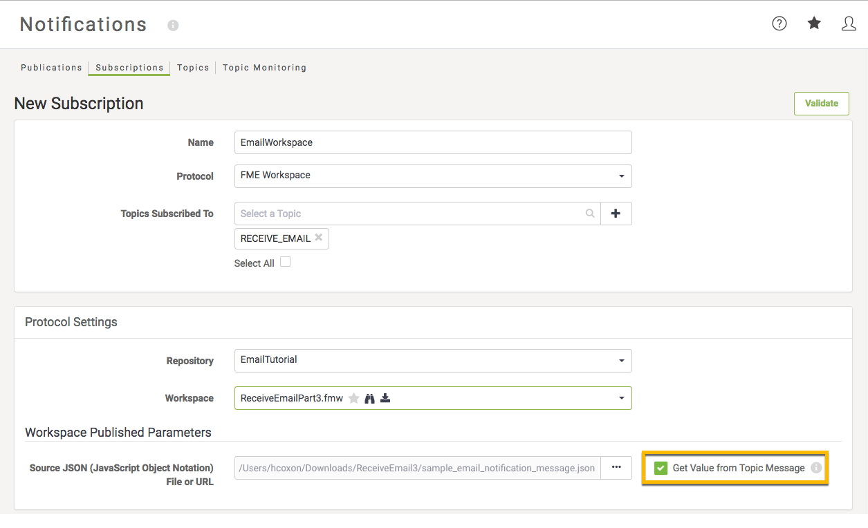

  1. Go to the FME Server Web Interface and under Notifications > Subscriptions select New.
  2. Give your Subscription a Name, select FME Workspace as the protocol and subscribe this workspace to the RECEIVE_EMAIL topic set up in the previous section of this tutorial
  3. Once you have selected the recently published workspace the Source JSON published parameter will appear, check the box to the right-hand side that states ‘Get Value from Topic Message’.
  4. Leave the Notifications and Advanced settings of the Subscription blank.
FME Workspace Subscription
It is important to ensure that box is selected so that the Reader will pick up the incoming message posted from the Topic to pass the attachment path into the FeatureReader.

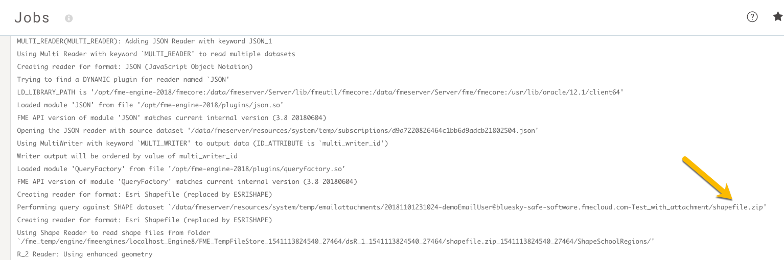

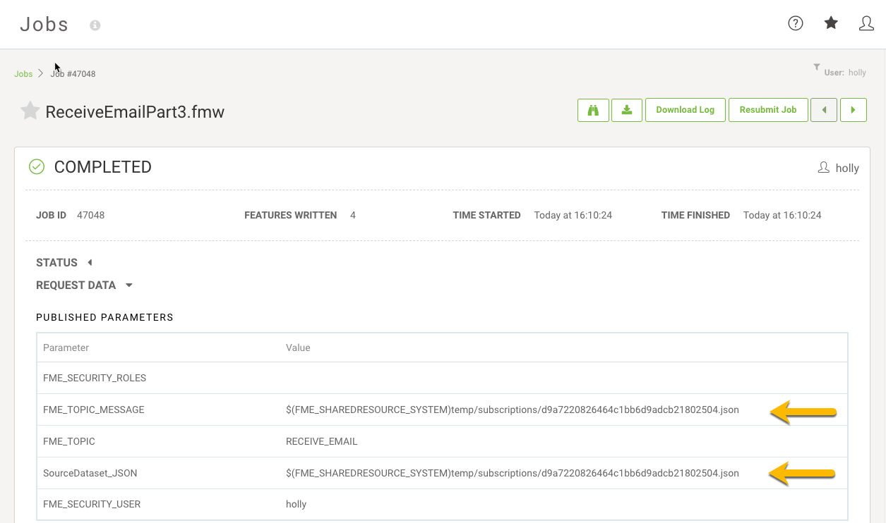

In the FME Server Web UI you should see the ReceiveEmailPart3.fmw listed in the Completed Job History. View the job log to confirm the attachment was correctly processed.
Receive Email workspaces uses the Topic Message as the JSON Source Dataset
Email attachment being processed in the workspace
