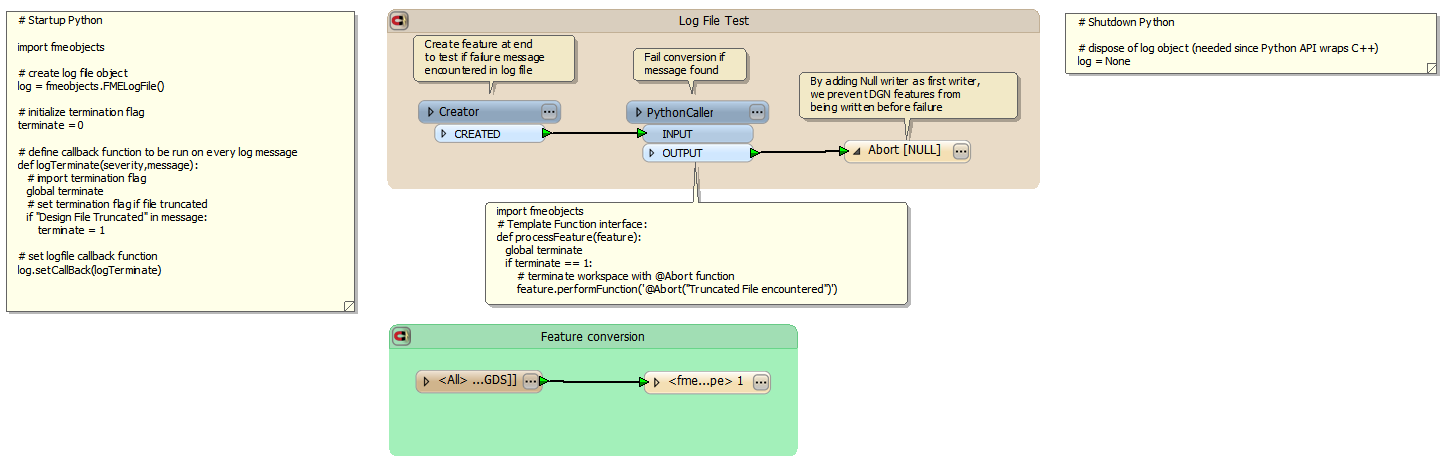

A customer found that some of their Microstation DGN files had been truncated. Normally, FME would post a warning in the log file if it encountered a truncated file, but it doesn't fail the translation. The customer wanted failures in order to separate the truncated files from the correct ones.
  • The Startup Python Script, in the FailTruncated workspace, searches each log message for the DGN file truncated warning and sets a flag if found.
  • At the end of the process, after all the DGN features have been read, a Creator transformer creates a new feature.
  • This new feature is sent to a PythonCaller, which checks to see if the truncation flag is set. If so, the workspace is terminated.
  • The PythonCaller's output is routed to a NULL writer, which is set as the first writer in the workspace.
  • The second-place DGN writer will not write its features until the workspace is complete, so no output file will be created if the workspace is terminated.

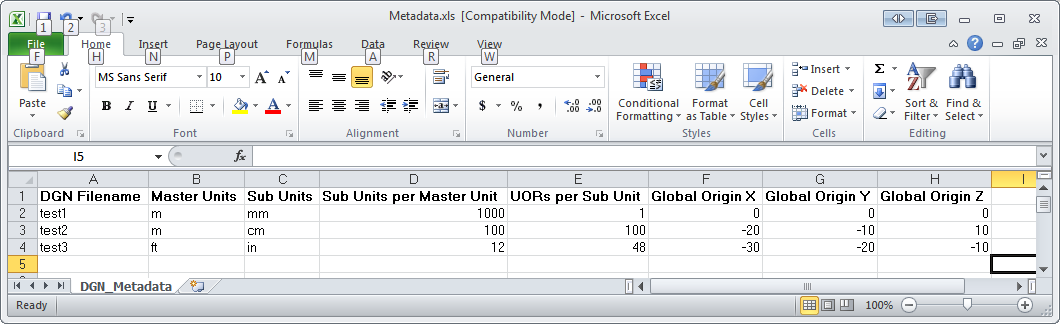

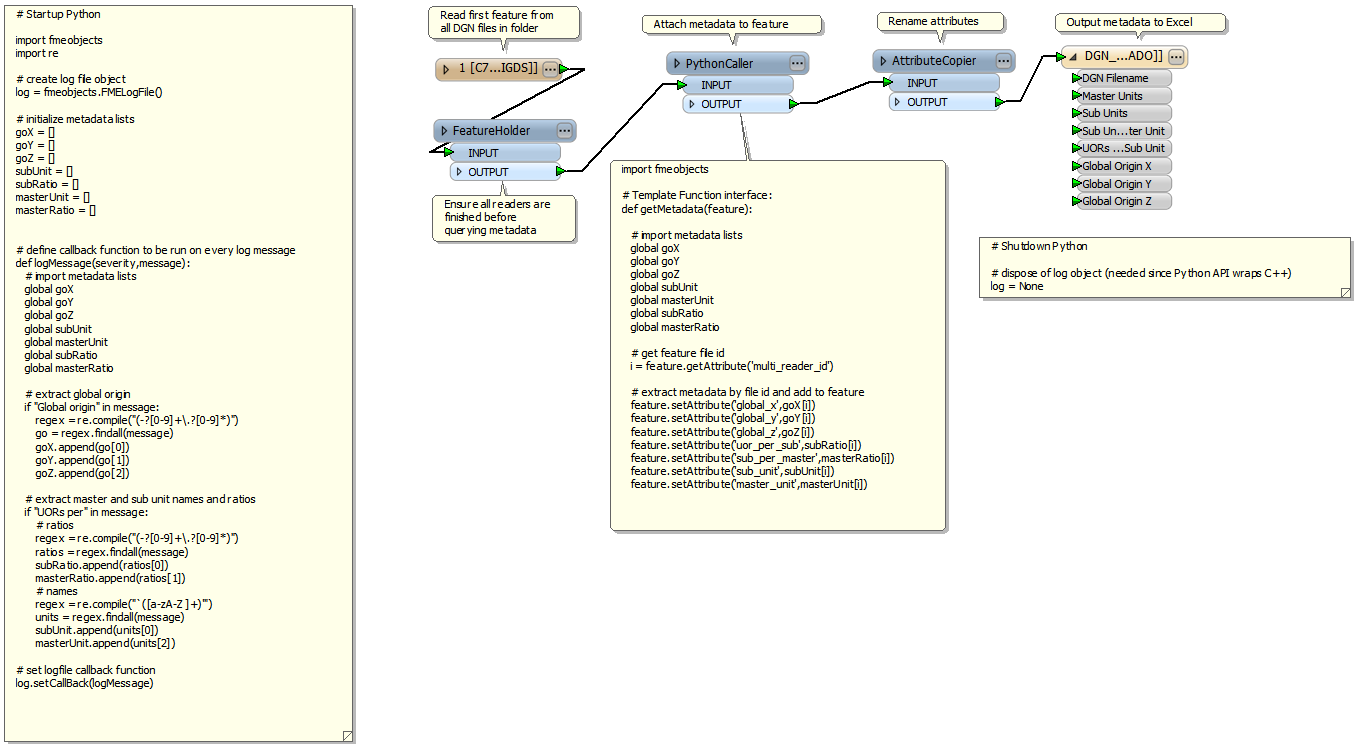

The Workbench readers often report file or table metadata to the log, but do not add this information to the features read from the file. The DGNMetadata example extracts the Global Origin, Master, and Subunit names and ratios from all the Microstation DGN files in a folder and outputs this information to an Excel file.
  • The Startup Python Script in the workspace uses Regular Expressions to extract the Global Origin and Working Unit parameters from the reader's log messages and stores them in global lists.
  • A single feature from each DGN file is read (by setting Reader Parameters via Edit DGNMetadata\*.dgn [IGDS] > Features to Read > Max Features to Read to 1 (preset)).
  • A FeatureHolder is used to ensure that all DGN files are read before continuing the process.
  • The PythonCaller joins each feature to its metadata using the multi_reader_id generic attribute. This attribute contains the read order of each file and corresponds to the index of the metadata Python lists.
  • The attributes are renamed for a more pleasant appearance, and then the features are written to Excel.
Output:
