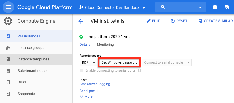

1. Once the deployment is finished, go to Compute Engine and select the newly launched VM and set the Windows password so you can log in to the virtual machine. Also, make sure to note down your username.
2. Click on the RDP link to download the RDP connection file. Then connect to the virtual machine using your Remote Desktop application.
